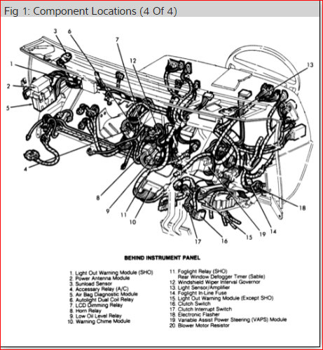

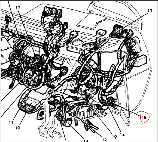

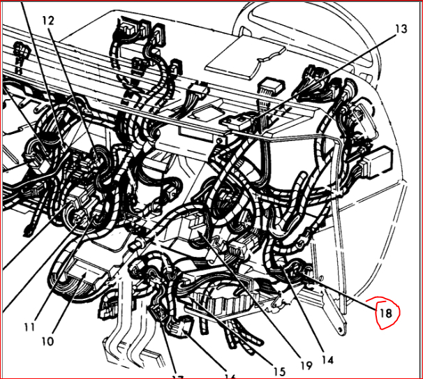

BRUCE JEAN
  • 7 POSTS
I checked all fuses, under dash and under hood. The car does not have round flasher in fuse box, and could not locate one under dash. It has three small breakers in fuse box, and all three have power going through them. Stumped. Any help would be great. Thanks.
Dec 2, 2020 at 12:49 AM (Merged)
DANNY L
  • 5,648 POSTS
Hello, I am Danny.
The flasher is located above the fuse box. I have attached a few pictures and it is labeled as #18. This does sound like a flasher problem. I have also attached a few tutorials for you to view. Hope this helps and feel free to as any questions.Thanks for using 2CarPros.
