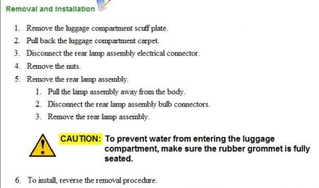

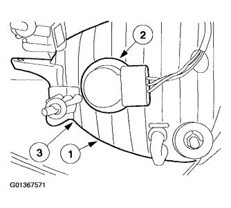

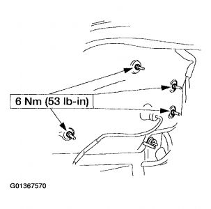

yes, we read the manual several times, but cannot figure out how to remove the taillight assembly so we can replace the turn signal bulb. the drawing in the manual shows a flat surface to be removed with a screwdriver, but the assembly is not flat. Does the outside (red lens) come off? and how? or is there a way to remove the assembly from the trunk side?

https://images.2carpros.com/forum/automotive_pictures/261618_Noname_2448.jpg
https://images.2carpros.com/forum/automotive_pictures/261618_Graphic_606.jpg
https://images.2carpros.com/forum/automotive_pictures/261618_Graphic4_4.jpg
Jul 10, 2010 at 2:20 AM
