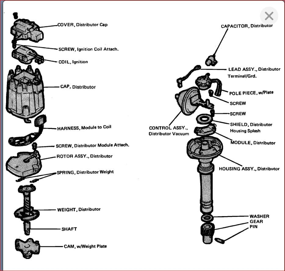

So i put a new distributor cap and rotor on the truck and it runs but for only about five minutes and i hear a knocking noise from the distributor. So i drive it around the yard and if i go to back up it will just stall maybe i need to adjust the carburetor and the exhaust also smokes a lot.so i am just wondering what to do.
Sep 3, 2020 at 3:14 AM
Okay. That is progress. I suspect you have two issues. The knocking noise coming from the distributor is most likely something to do with the distributor itself and not caused by something else. I have seen a lot of distributors make a knock or clicking noise and it was the rotor hitting the cap. Start it up and put your hand on the cap and see if you can actually feel it.
I would then remove the cap since you just replaced it and see if there are any marks on the inside of it. If not, it could be an issue with the gear or shaft.

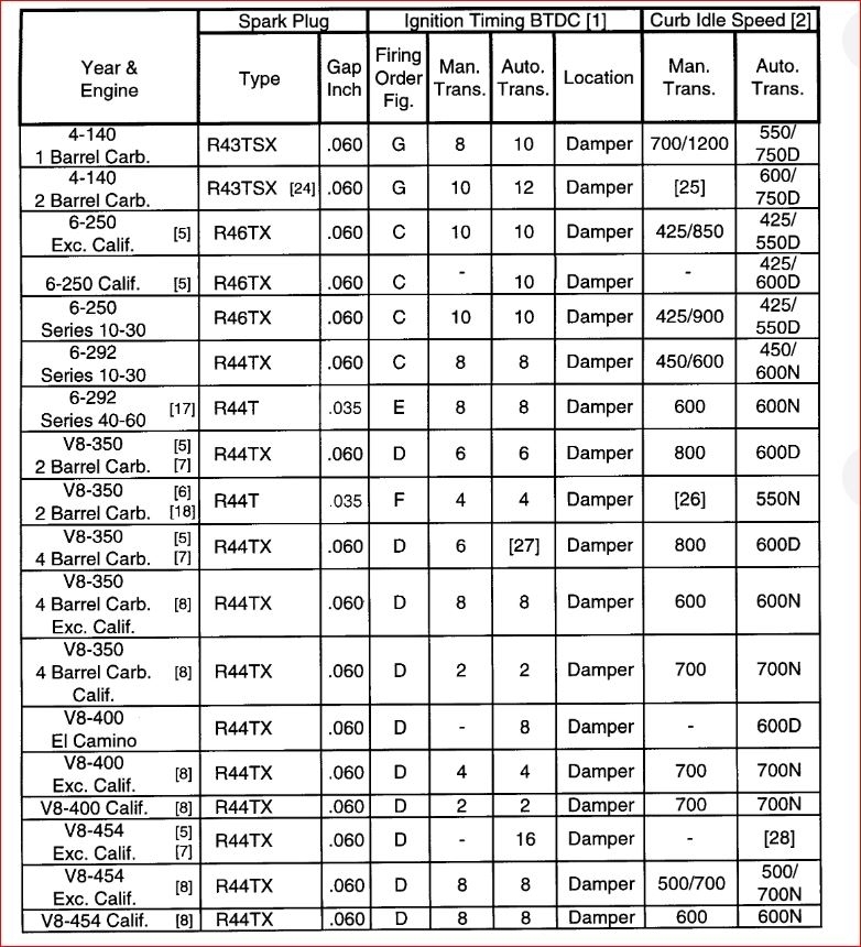

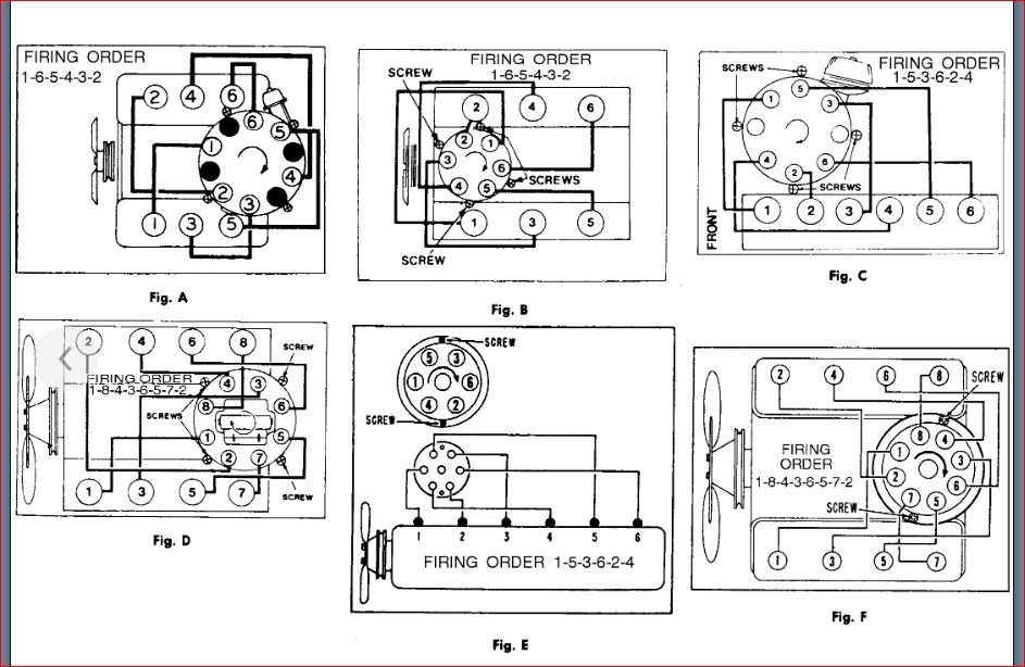

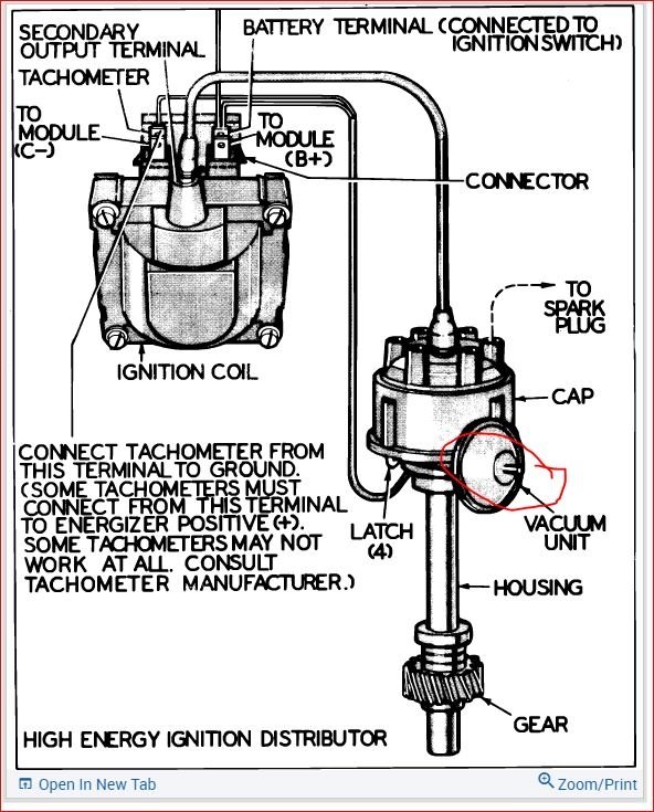

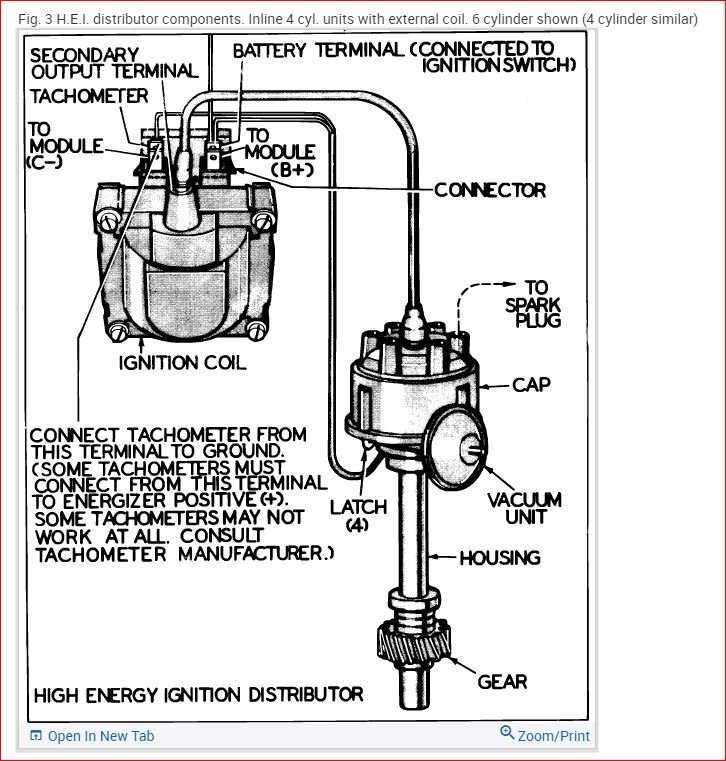

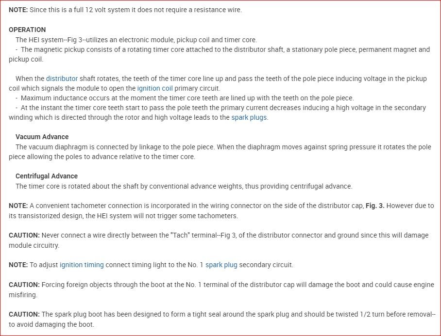

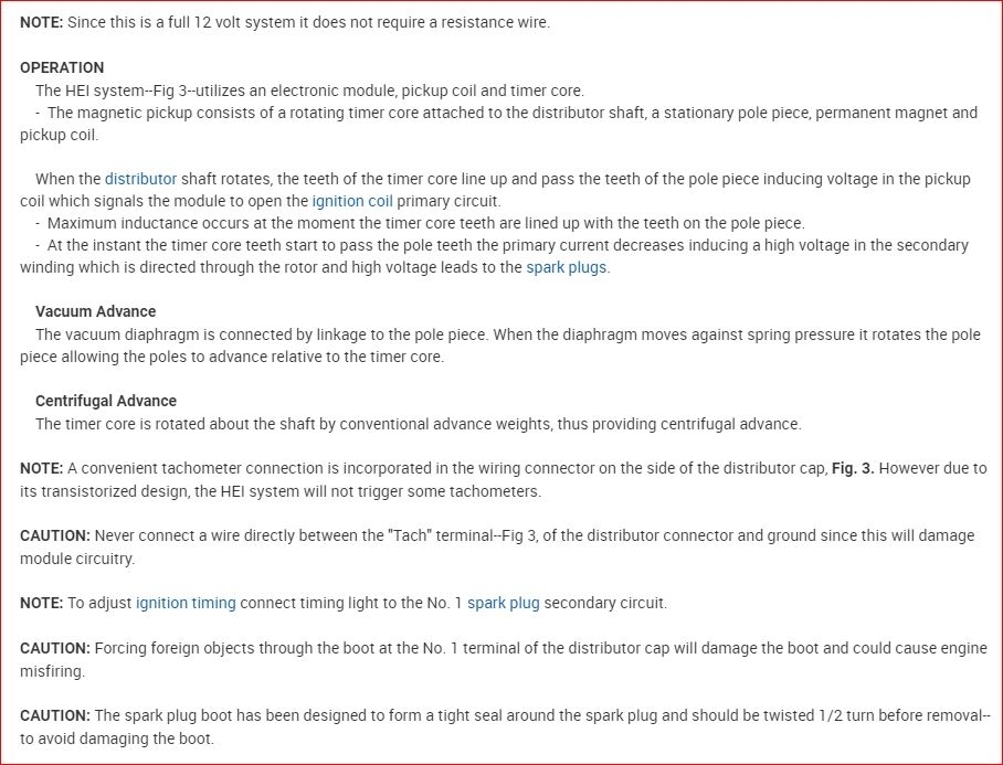

Here is a video that gets pretty deep in setting the timing on Chevrolet engine. I attached the specs on where to set your timing. Keep in mind you just want to set base (idle/initial) timing and the vacuum adjust will handle total timing. I circled in red where your vacuum advance line is, just make sure you unhook that before you start.
I attached your timing specs but don't go solely on these. The engine will begin to run really smooth when it is in a good position. So if the spec is 8 degrees BTDC and your engine runs better at 12, go with 12.
https://youtu.be/UYGU7mTwsZc
Let me know if you have questions. Lastly, if you are not comfortable doing this, then I would not try it on your own. The first time you set this, it can be very confusing.
