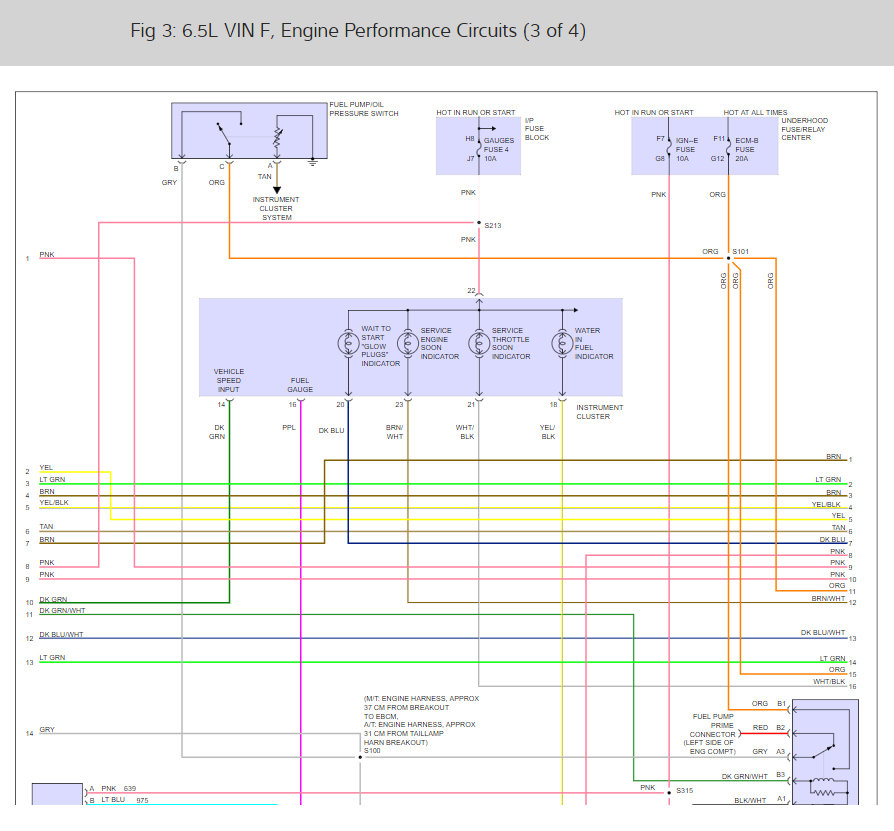

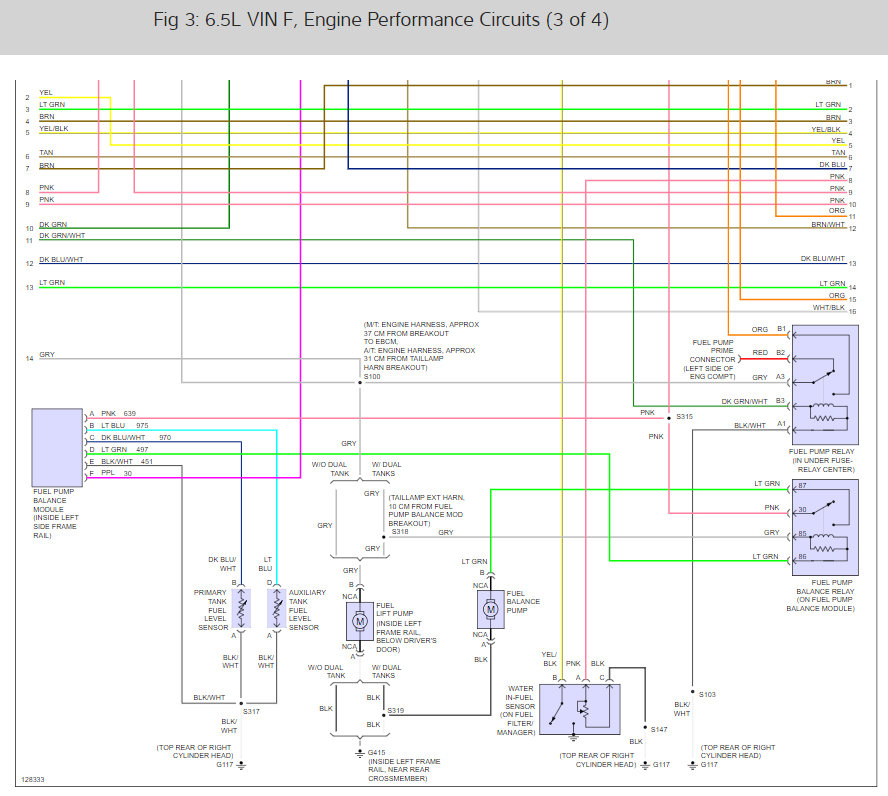

This is an old post but we can pick it back up again. Can your truck communicate with the scanner? Here is a video to help you read the codes:
https://youtu.be/v0ayZE5kq1Y

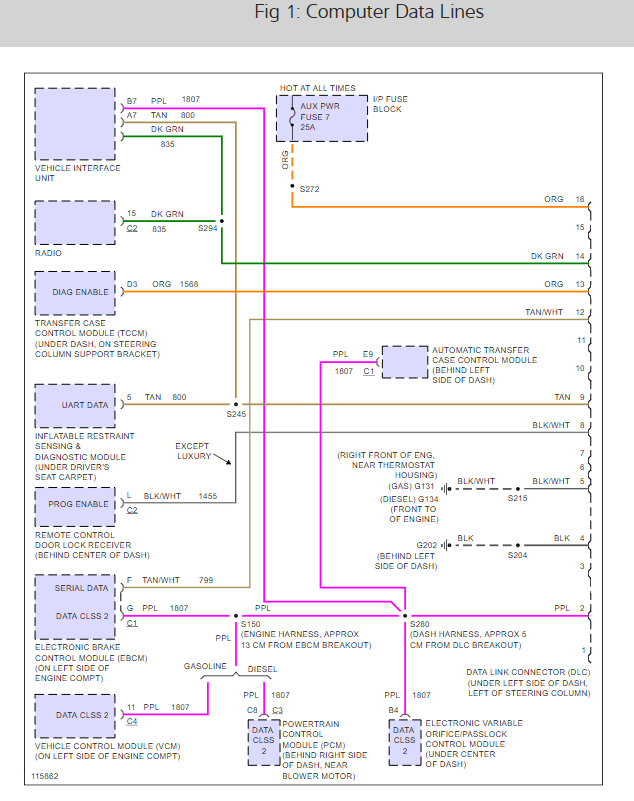

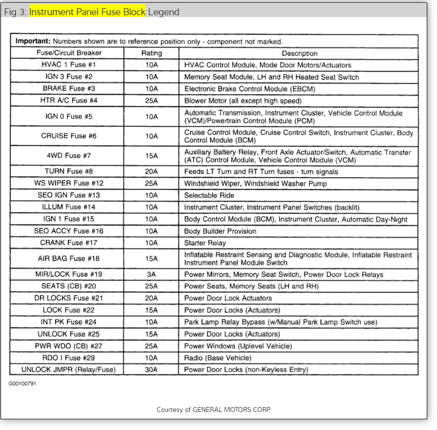

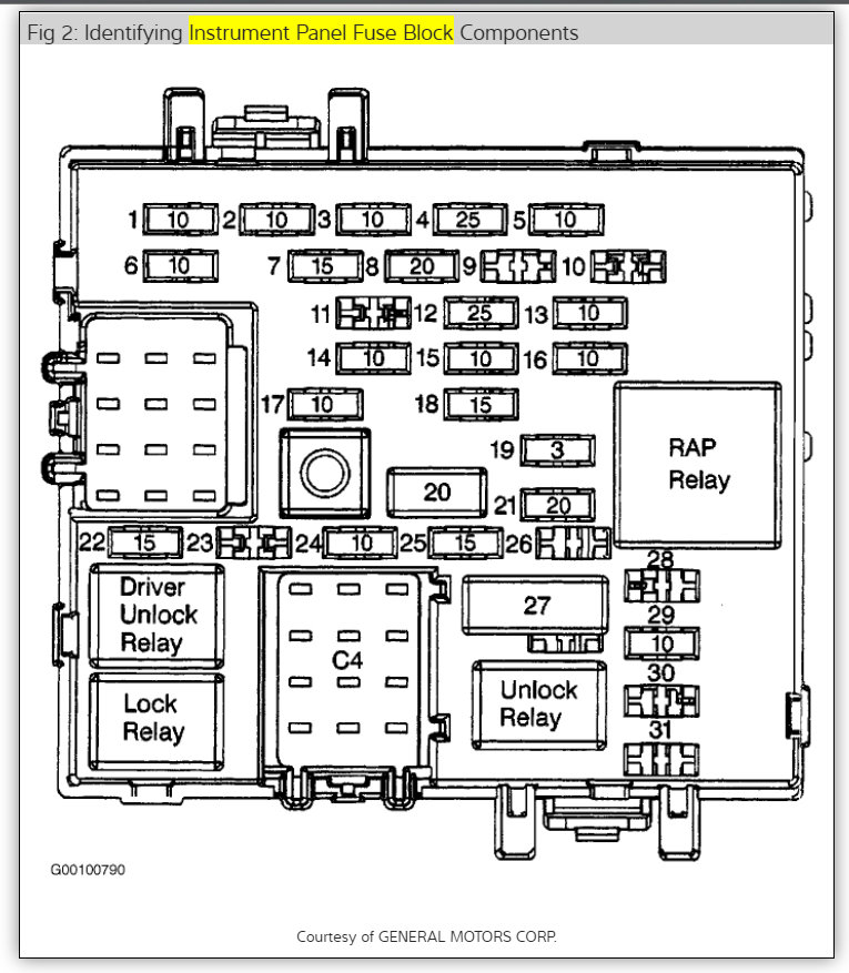

If it does not connect lets test the fuse #7 which powers the ALDL connector. Here is a guide and diagrams to help you get started:
Sep 2, 2020 at 7:09 AM
BOBBYZEE
The truck is unable to communicate with the scanner. Is powers up from the port but says unable to connect. All fuses have been checked and are good.
The security light comes on solid after sixty seconds with key on. It never goes off.
The truck cranks and starts for a quick second but will not stay running.
I replaced the passlock key housing, the key cylinder with new key and the ignition wiring harness but no luck.
I am debating whether to have it towed to dealer or try buying a new PCM. I have had four tech guys try to figure it out but no luck. I did the relearn of the new key. Key in start position, wait ten minutes, light stops blinking and repeat three times. It seems to have learned the key because light stops blinking, but the light comes back solid after sixty seconds like it is a different problem.
Any help would be appreciated and thanks Ken for the response!

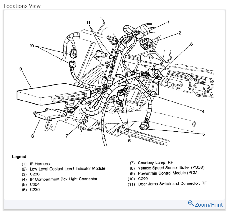

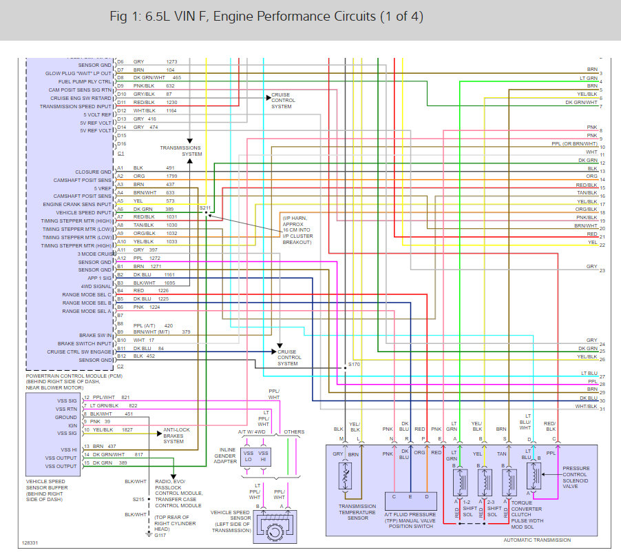

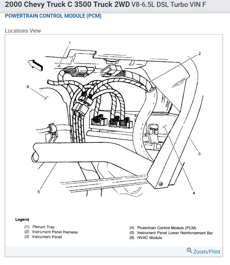

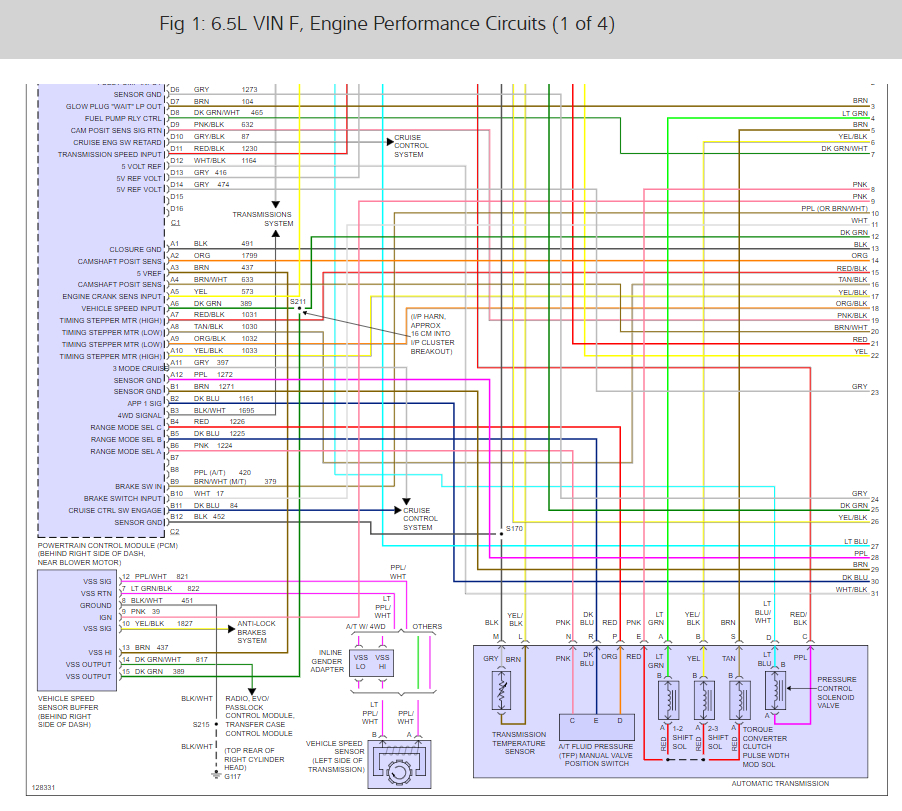

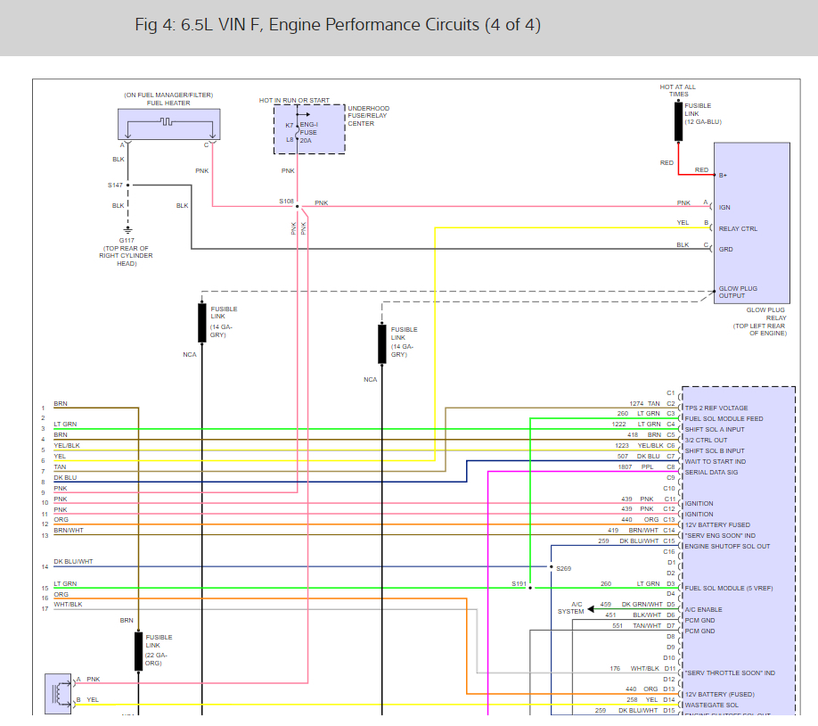

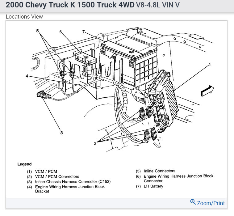

18,000 miles :) I love it. my favorite truck but it does sounds like the PCM is out or we have a wiring issue. Let's check the power and grounds to the PCM to confirm its failure.
Check the power and grounds. Here is a guide to help you get started and the location of the PCM:

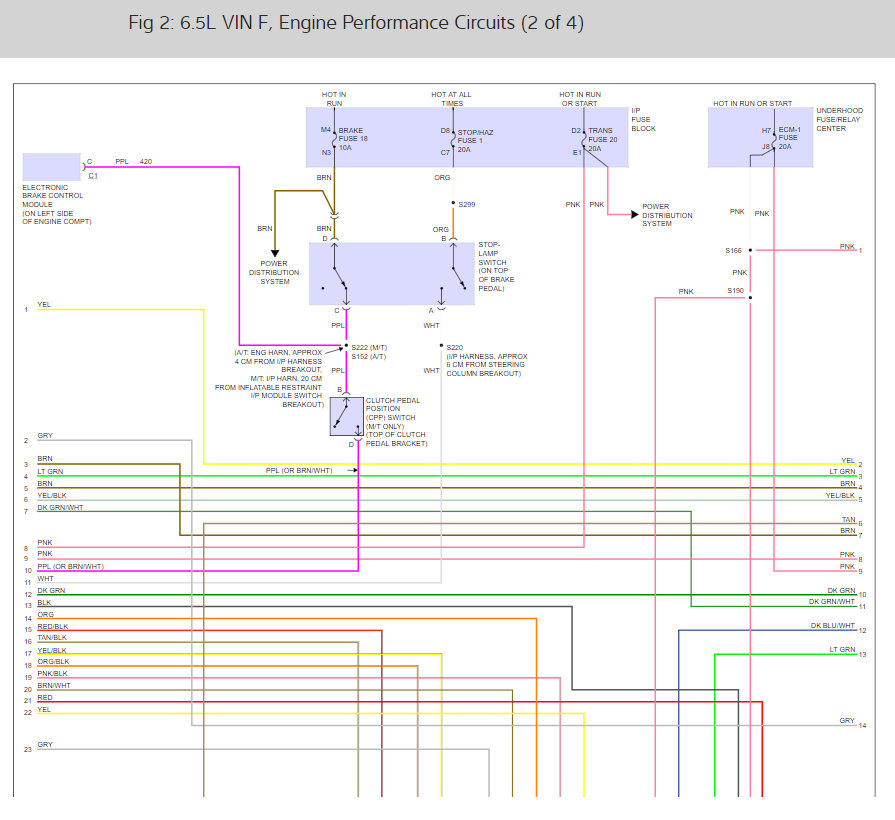

So, I tested all the grounds and power to the PCM. Everything tested as it should based on the schematics you provided. I did all the testing with the key in on position. As I was testing, the security light went off and the OBD scanner could now suddenly communicate and the van started! I have no idea what the problem was but as of now, it works! Maybe leaving the key on for over an hour reset the security light? Maybe there is a wire loose somewhere? Thanks Ken for the help!
  • 55,709 POSTS

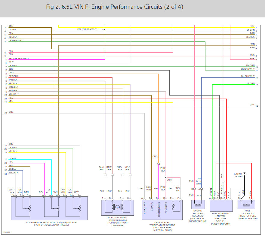

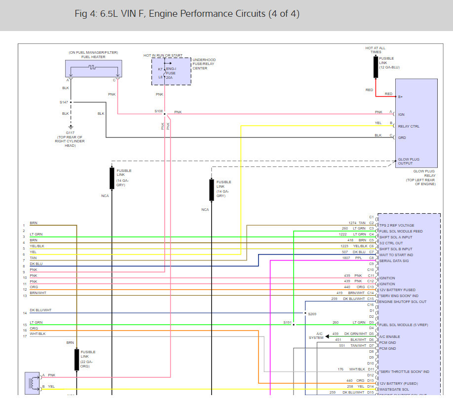

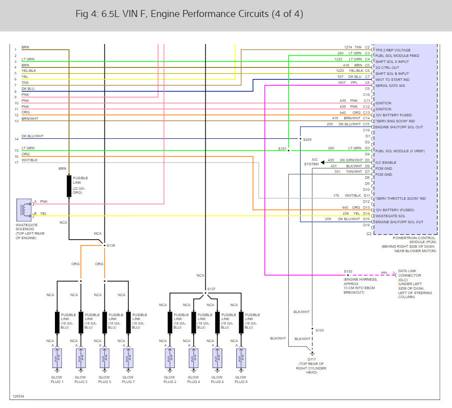

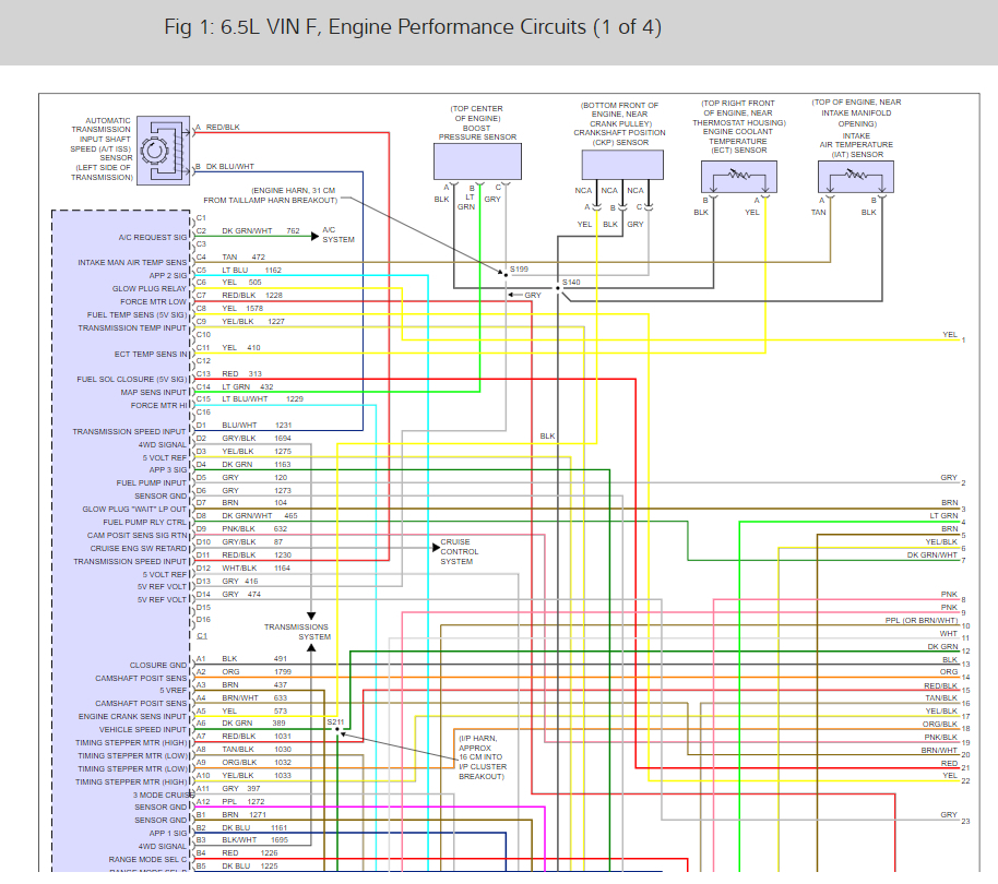

It could be the PCM is going out or you have a bad connection. I would remove the electrical connects at the PCM to check for corrosion just to be safe. Below is the PCM location. Check out the diagrams (below). Please let us know what you find.
