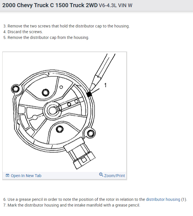

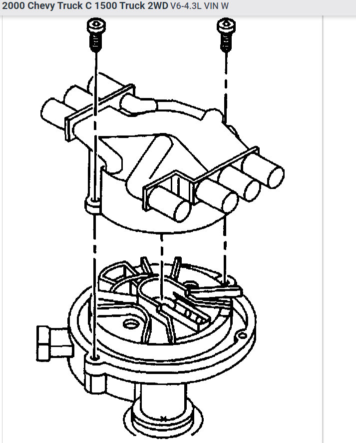

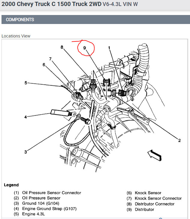

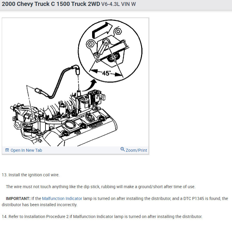

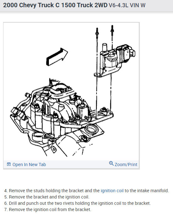

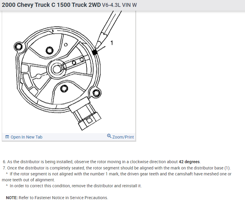

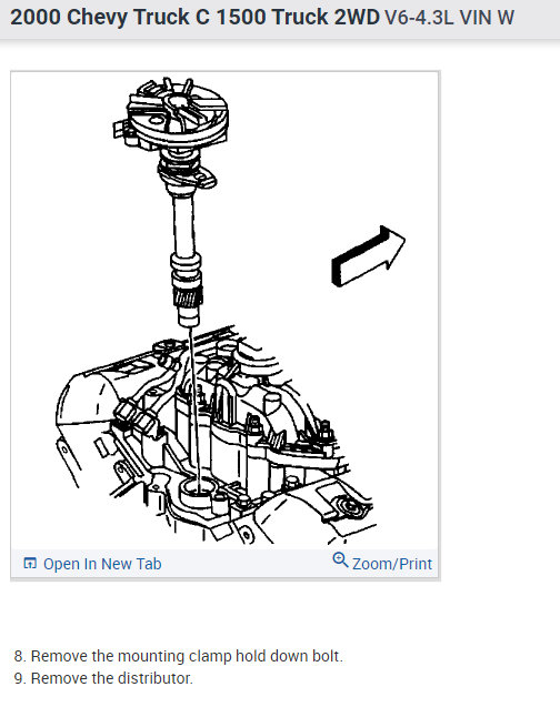

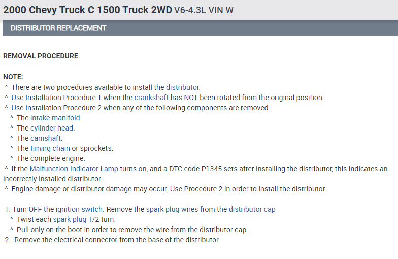

When it is humid outside or raining, my truck won't start. A day or two after the rain stops it will eventually start, but it takes a while and there is a lot of spluttering and shaking. After being run for several minutes, it will backfire and then run with no problem. Is this due to a cracked distributor cap or a cracked gasket in my engine block?
Wednesday, September 22nd, 2010 AT 11:29 AM
SQM
  • 6,383 POSTS

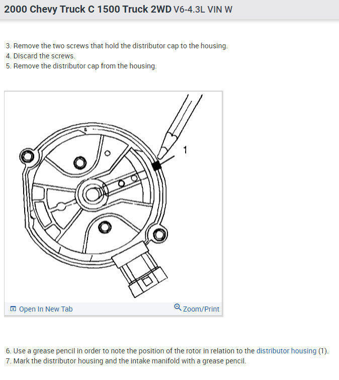

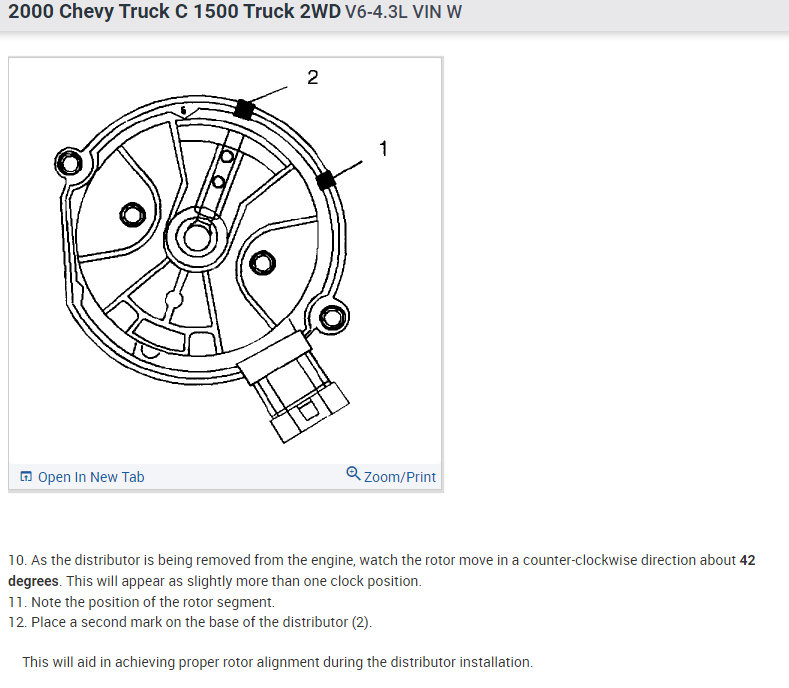

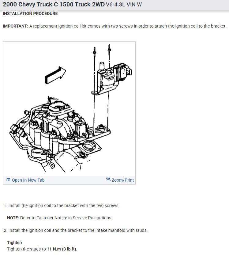

This is somewhat of a common issue with many of these 6 cylinder GM engines.

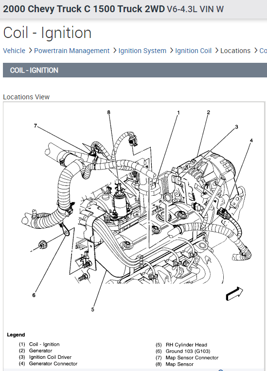

This typically happens when you have moisture in side the distributor or the coil pack.
Usually a poor seal under the distributor cap and/or the coil pack, lets moisture inside.

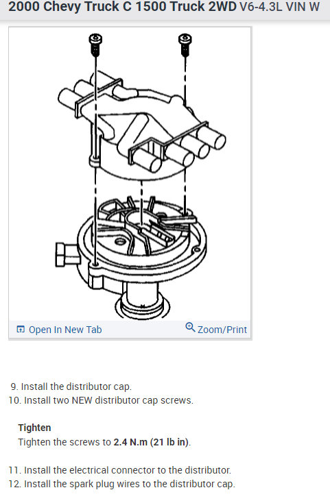

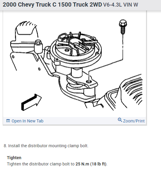

You should able to clean out the distributor and replace the cap with new o-ring.
If there is moisture inside the coil you will have to replace it.
Be sure to inspect the ignition control module as well.
https://www.2carpros.com/articles
https://www.youtube.com/c/2carpros/featured

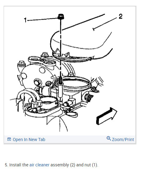

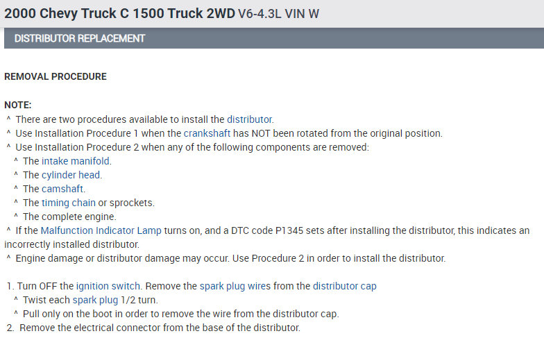

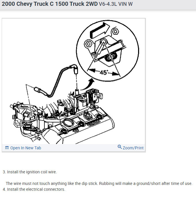

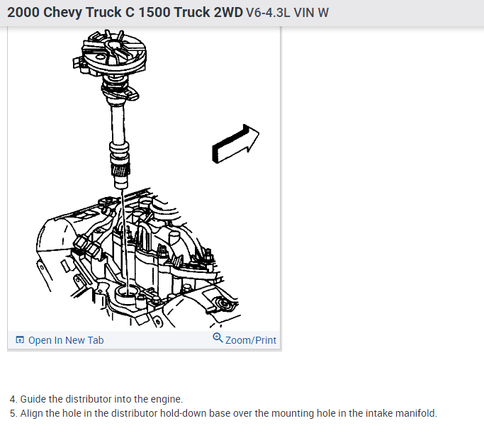

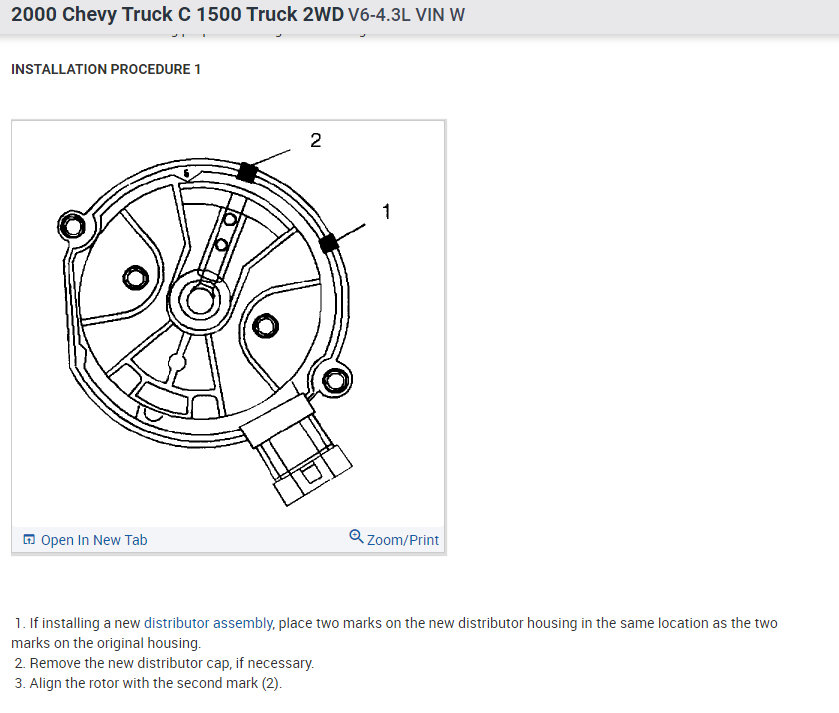

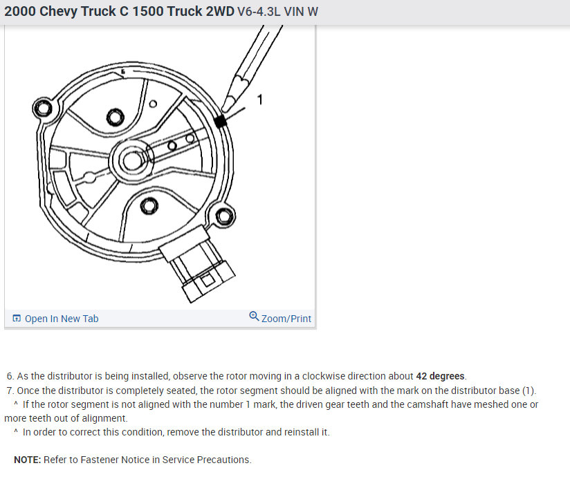

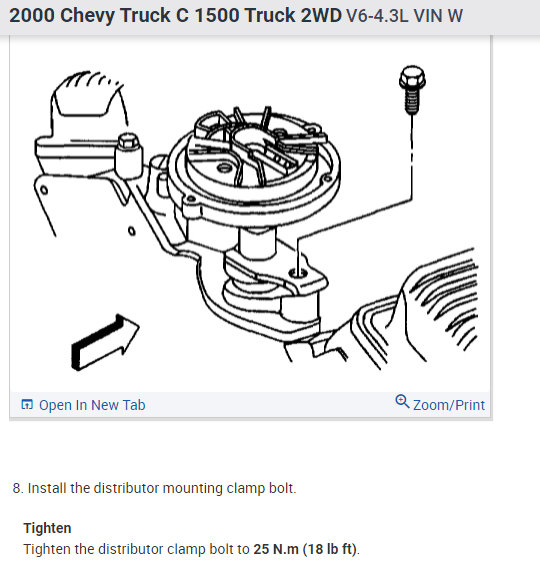

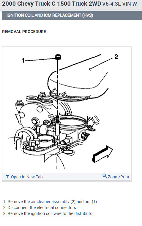

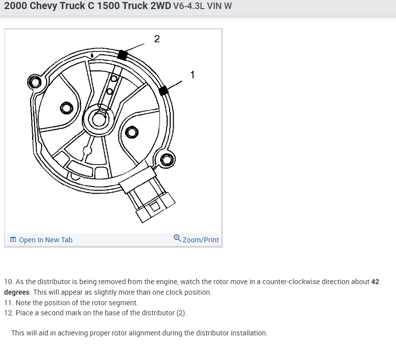

I have attached the diagrams for your reference.
