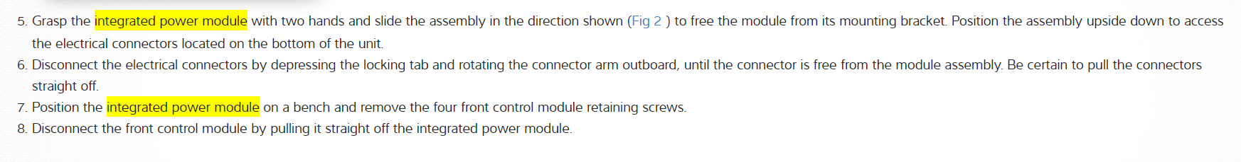

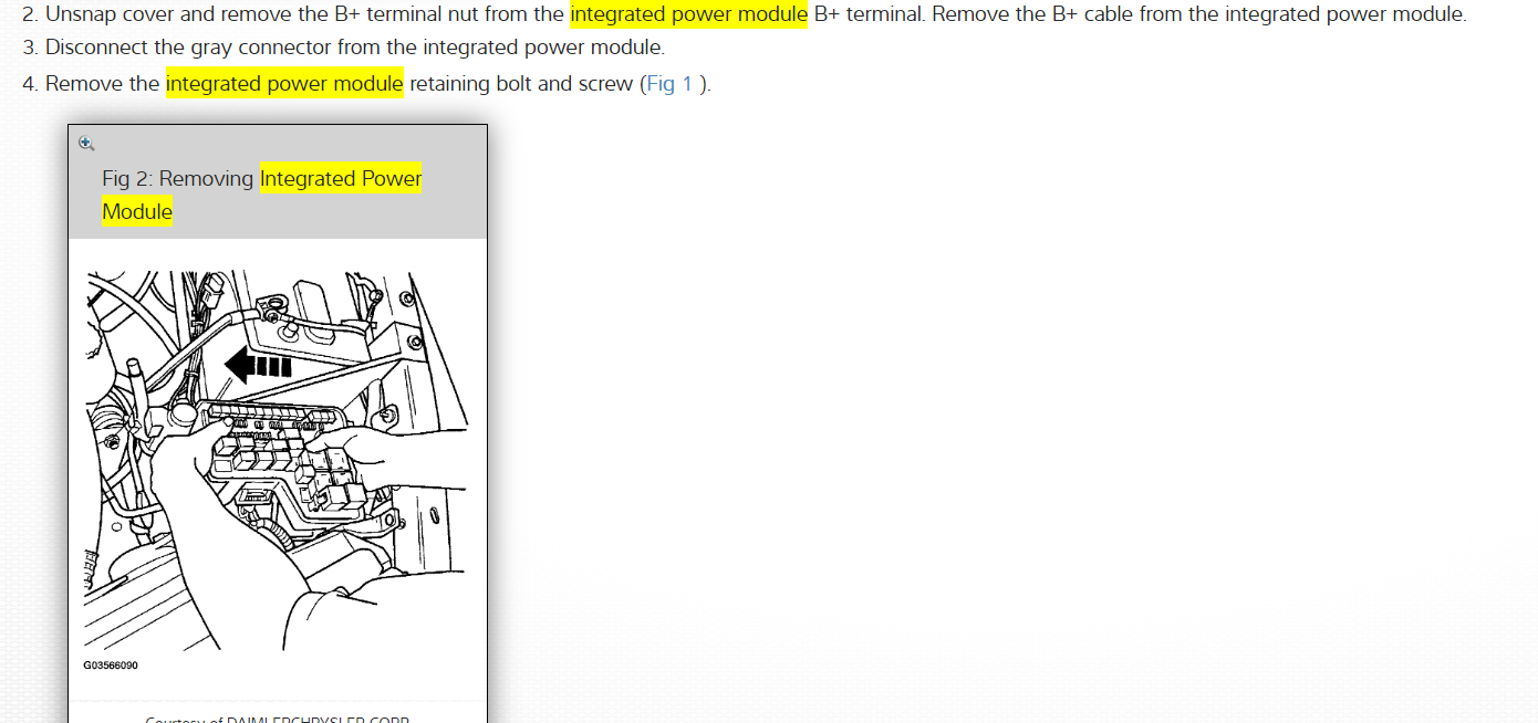

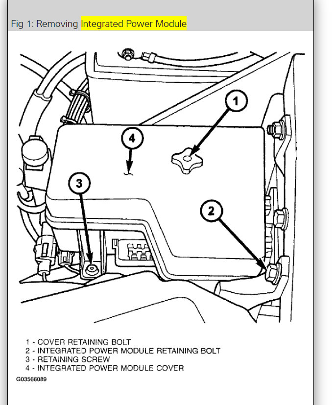

Here is the instructions to replace the TIPM in the diagrams below. Check out the diagrams (below). Please let us know what happens.

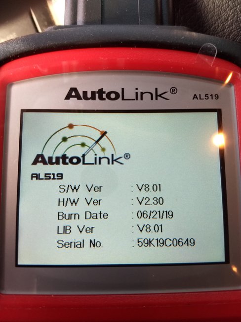

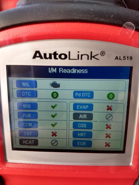

Thank you for your response. The current update is: I purchased an Autel AL519 CAN scan tool and scanned the truck tonight. I retrieved one code P0137. I also did an I/M Readiness scan and the following systems came back as being incomplete and the scanner could not perform a diagnostic test on any of the following: O2S -- O2 Sensors Monitor, EGR -- EGR System Monitor, CAT -- Catalyst Monitor, EVAP -- Evaporative System Monitor, and HRT -- O2 Sensor Heater Monitor. After the scans, I tried to start the truck and it started and ran for about 3mins. then shut off like it ran out of fuel and would not start back. I could not hear the fuel pump running after it shut off. I could smell fuel but could not get the truck to run. It would crank as before but not run. I have attached a couple pictures. One of the scan tool and software version i used and one of the I/m Readiness test result. Can a bad O2 Sensor cause it not to start or am I really looking for a broken wire in the wiring harness?

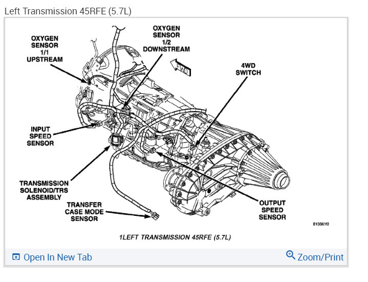

The P0137 is telling us the secondary O2 sensors could be shorting causing the issue. can you please unplug it and try to start the engine? Here is the location and guide to walk you through the steps:

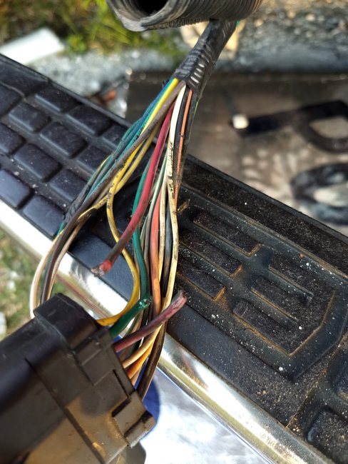

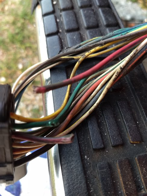

I performed the test as you requested. No improvement. I did find the problem though. I was getting out from under the truck after the test and noticed a wiring harness connector located under the body right at the drivers door that looked like the locking tab was not in place. i touched it and the connector came apart. I was working with the connector when i noticed a bulge in the insulation on a red wire and a skinned place on the green wire next to it. upon further investigation i found a broken wire with a large amount of oxidation. I cleaned them spliced and soldered them and put it all back together. It is running great now. I will test it out over the next few days but i am sure that was the problem. the wiring harness the broken wire was in was going to the fuel pump and tank down the rail on the drivers side. I attached a picture of what i found.
