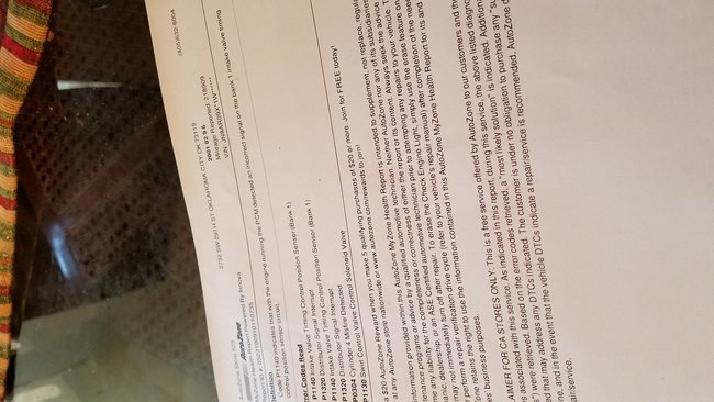

I replaced the spark plugs and coil packs. This is what the scan looks like. What do I need to replace now?

I hate to say it, but I can't read the codes in the picture. Can you provide the specific codes listed?

The codes are:
P1140
P1320
P1140
P1320
P0304
P1130
Sep 11, 2019 at 5:09 AM

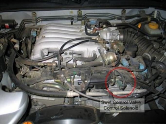

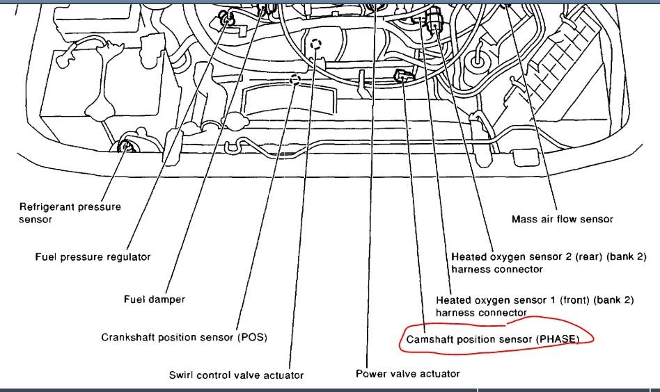

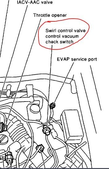

The 304 is still related to cylinder 4 misfire. As far as the 1140, there is an issue with the camshaft position sensor on the right side. Next, the 1130 deals with the swirl valve in the intake. The 1320 deals with a an ignition issue. Okay, the first thing I need you to do is this. Switch the coil on cylinder 4 with another cylinder to confirm this isn't a coil issue. Although it is new, it can be bad.
Next, I need you to check the connections at the swirl valve and the camshaft position sensors. Make sure there are no issues with corrosion or damage.
Since the swirl valve also operates on engine vacuum, we need to check for a leak. Here is a link that shows how to check.
I attached 3 pictures below. The first shows the swirl valve connection, the second shows the vacuum control switch for the swirl valve, and the third is the cam sensor.
