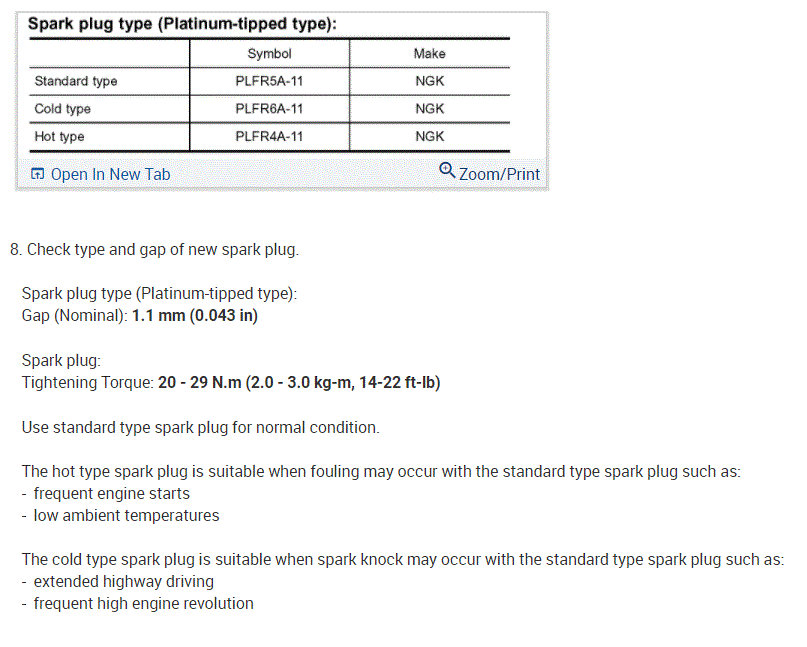

when I was doing a tune up I noticed that there was oil on the threads of the spark plugs, any idea what could be wrong with my SUV ?
Mar 30, 2008 at 11:48 AM
  • 110,244 POSTS
It isn't uncommon for oil to be around a spark plug. What happens most times is a leak from the valve cover which allows a small amount of oil to leak past the gasket into the spark plug well. As long and there wasn't a puddle of oil, it's not a big concern.

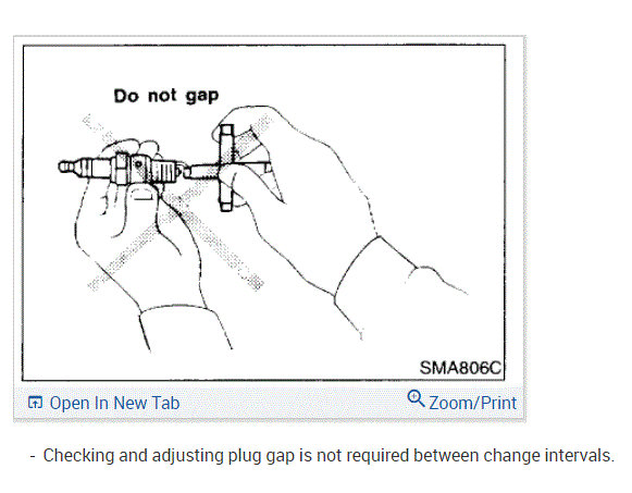

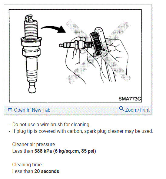

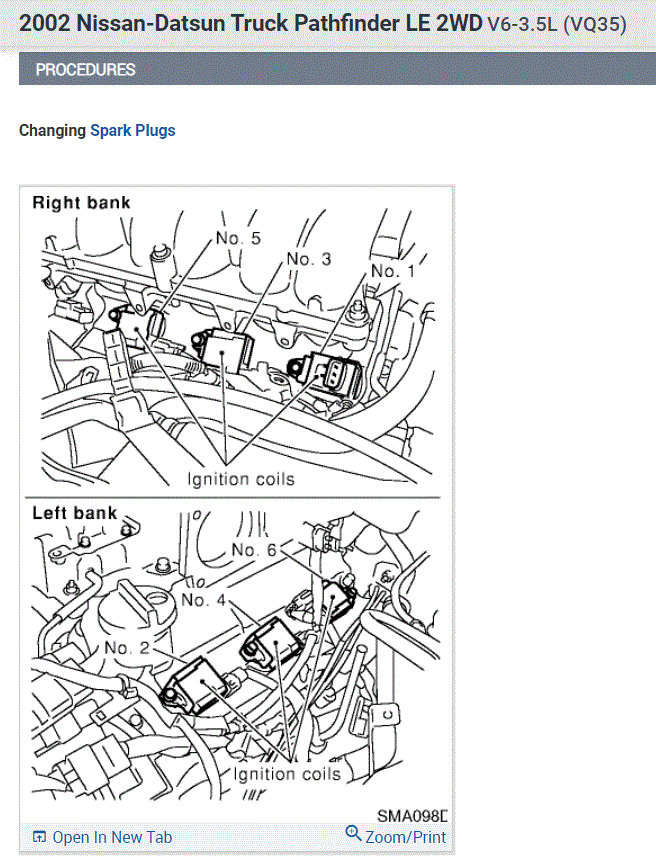

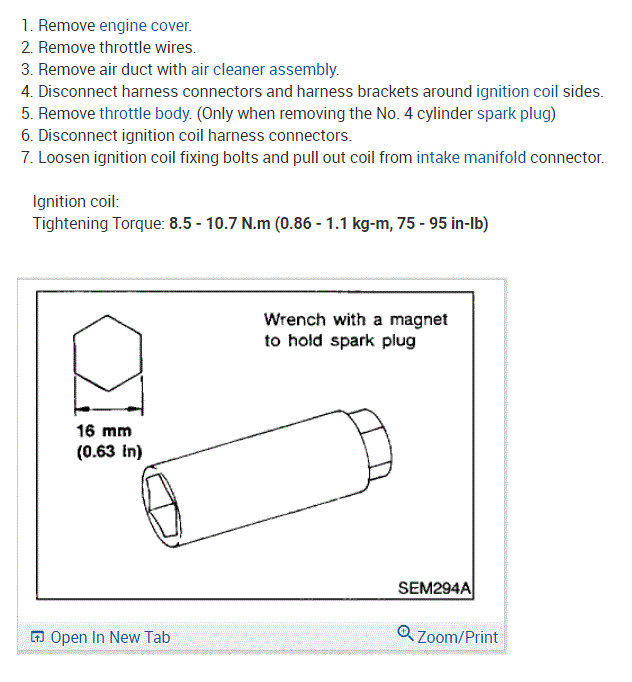

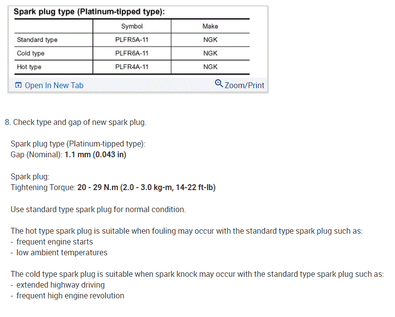

As far as the spark plugs, here is a link you may find helpful when replacing them:
https://www.2carpros.com/articles/how-to-change-spark-plugs
The attachments below are the directions specific to your vehicle for replacement.
