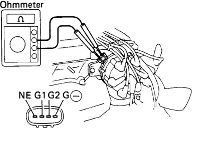

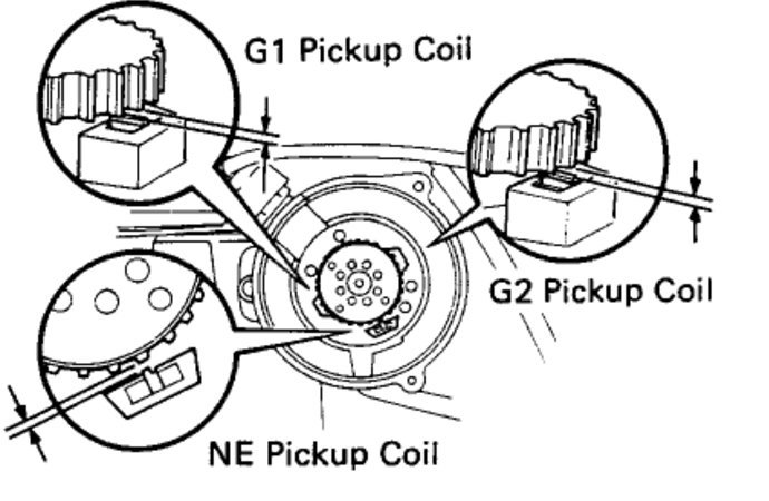

It sounds like the crankshaft angle sensor has gone out, here is a guide and diagram (below) on how to test it to confirm.
INSPECT AIR GAPS
Using a feeler gauge, measure the gap between the signal rotor and pickup coil projection.
Air gap: 0.2 mm (0.008 in.) or more
If the gap is not as specified, replace the distributor.
INSPECT PICKUP COILS
Using an ohmmeter, check resistance of the pickup coil.
G1 pickup coil resistance:
G1 -> G- 140 - 180 Ohms
G2 pickup coil resistance:
G2 -> G- 140 - 180 Ohms
NE pickup coil resistance:
NE -> G- 180 - 220 Ohms
If the resistance is not as specified, replace the distributor.
Please run this test and get back to us we are interested to see what it is.
