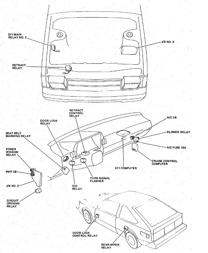

my car dont sends any active current from the ignition system to the distributor i tried changing the igniter to other supra than i have but it is work i put on back to the other car but do not turn on the car . i want to know what kind of trouble my car have.

I would check the fuses first here is a guide to ehlp and the fuse locations as well.
Also, I would swap out the main EFI relay which had problem in this car. Check out the images (below). Please let us know what happens.
