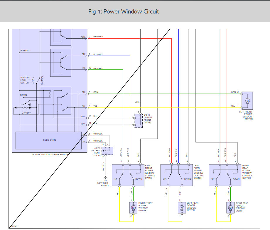

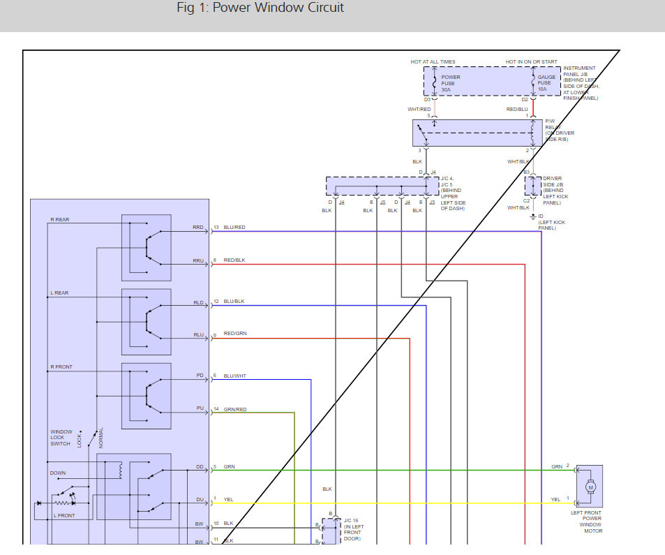

MMPRINCE4000
  • 8,548 POSTS
This could be either the switch or the motor has gone bad. It is not a fuse because the other windows work. Here are two guides that can help you see what the problem is and if it is the motor how to replace it. I also included the window wiring diagrams so you can see how the system works.
https://www.2carpros.com/articles/electric-window-repair
and
https://www.2carpros.com/articles/how-to-check-and-replace-a-electric-power-window-motor
Check out the diagrams (below). Please let us know what you find.

MMPRINCE4000
  • 8,548 POSTS
Check for 12V at the main switch on drivers side. The master switch may be bad affecting the circuit.
If not then post results and I will look for a wiring diagram in Mitchell 5.

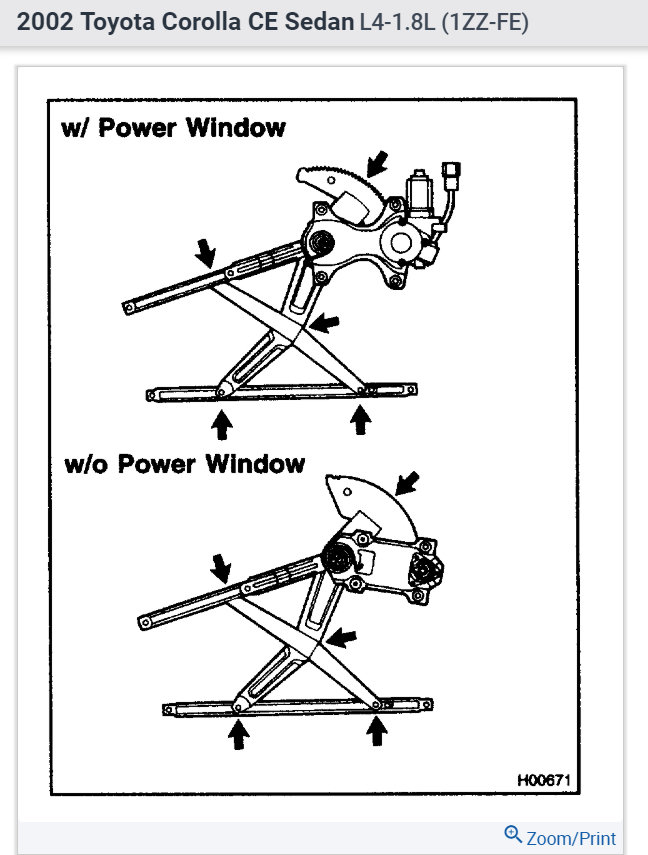

When I rolled my driver's side window down today, there was a thudding noise like it fell into the door. When I tried pushing the button to roll it back up, there was a noise like it was cracked. All of my other automatic windows are working fine. I've read responses about the window regulator, fuses, etc. However, it sounded like my window detached from whatever was holding it up. Ideas? Thanks!
Aug 18, 2019 at 9:48 AM (Merged)
BMRFIXIT
  • 19,053 POSTS
[quote:e426c952b0="Austin26"]When I rolled my driver's side window down today, there was a thudding noise like it fell into the door. When I tried pushing the button to roll it back up, there was a noise like it was cracked. All of my other automatic windows are working fine. I've read responses about the window regulator, fuses, etc. However, it sounded like my window detached from whatever was holding it up. Ideas? Thanks![/quote:e426c952b0]
You hear the motor working when pushing the switch
Most common it’s the window regulator
I’m almost 100 % + it’s the regulator
But you can pull the door panel and check the operation of the window
And you can check if the glass had falling of the regulator
So you need to remove the door panel
Start on it
Good luck
Let us know
