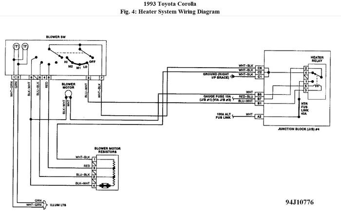

Fan blower/air doesn't run at "high" only at the two lowest fan speeds on '93 corolla. Please help. Hottest day of the year. Thanks!
Tuesday, November 27th, 2018 AT 5:30 PM (Merged)
KHLOW2008
  • 41,814 POSTS
Attached is a diagram of the wiring circuit. I believe the blower motor switch is faulty.
