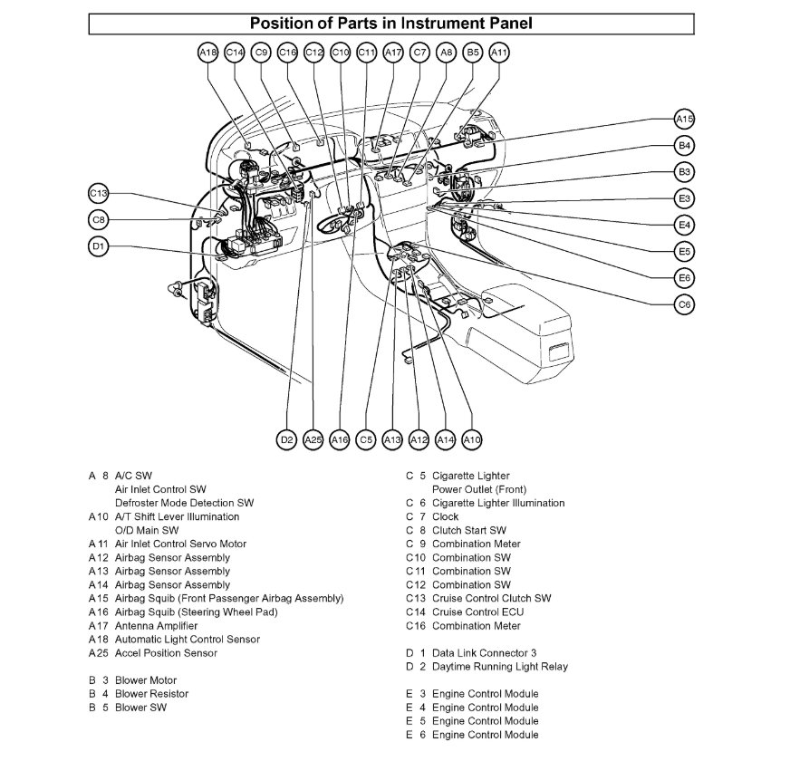

The heat/AC blower fan has been shutting off intermittently and now does not come on at all on any setting. Is there a relay that controls this fan? Both the heat and A/C function properly, it is just the blower that does not work.

This sounds like the blower motor has gone bad. Here is a guide to help you confirm the issue and the location of the blower motor below:

Please help, ac and heat fan will not turn on at all. Checked the relay and it is not the problem. We have to go home tomorrow which is a 10 hour drive home w/ no air.
Wednesday, October 3rd, 2018 AT 11:43 AM (Merged)
  • 75,992 POSTS
Check the gauge fuse 10amp and the heater fuse 40amp if both okay-if heater relay is good-problem is coming from the blower switch or blower motor to include the ground behind right kick panel.

Hi, sorry it took me awhile to get back. We did change the blower motor. But the air isn't blowing anough air. It's working now but not enough air, we have to put it up all the way before we can feel anything, Please help. Thanks
+1
  • 75,992 POSTS
Check and test the blower blower resistor

I re placed blower motor but not resister it worked for two weeks quit again. What could be problem? Could you tell me wh ere resister is located at? Do you have a video to show how to test blower and how to put in resister and blower. Or could it be something else?

Do you have any fan speeds at all?
-1
VERONICA KOLCZYNSKI
It does nothing.
MHPAUTOS
  • 31,937 POSTS
Check for voltage going into the fan motor when it is not working
VERONICA KOLCZYNSKI
Its working again cleaned fuse its now working fine so far.
