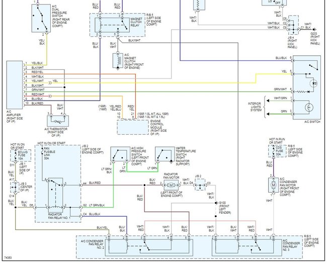

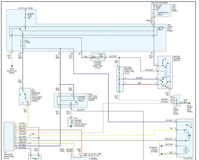

My fan (internal/inside dashboard) stopped working. I do get air moving when the car is moving. What could be the problem? and how difficult to replace the fan.
Oct 18, 2008 at 4:00 PM
  • 75,992 POSTS
Check heater fuse 40amp and Gauge fuse 10amp, Heater relay, heater blower switch, blower motor resistor and blower motor
Read the guides below on testing wiring and using a test light, they will help you figure this out
Attached below are the wiring diagrams for your blower motor
Oct 18, 2008 at 4:11 PM
TOYOTA42
The heater blower stopped working. I checked and replaced the resistor as wa bad. I checked the fuse, circuit breaker, switch and relay and continuity was all ok. I tested the motor by connecting the two leads to the battery and it spun. I put it all back together and the blower still does not work. Do you think its actually the motor? I did pull the power plug from the motor and there is power at the plug. tested with a multireader.
help!
Nov 27, 2018 at 5:29 PM (Merged)
SATURNTECH9
  • 30,869 POSTS
So are you sure you have both a power ad ground to the blower plug?if so you have a loose connection at the connector.You said the motor works when hot wiring it so the motor is good.

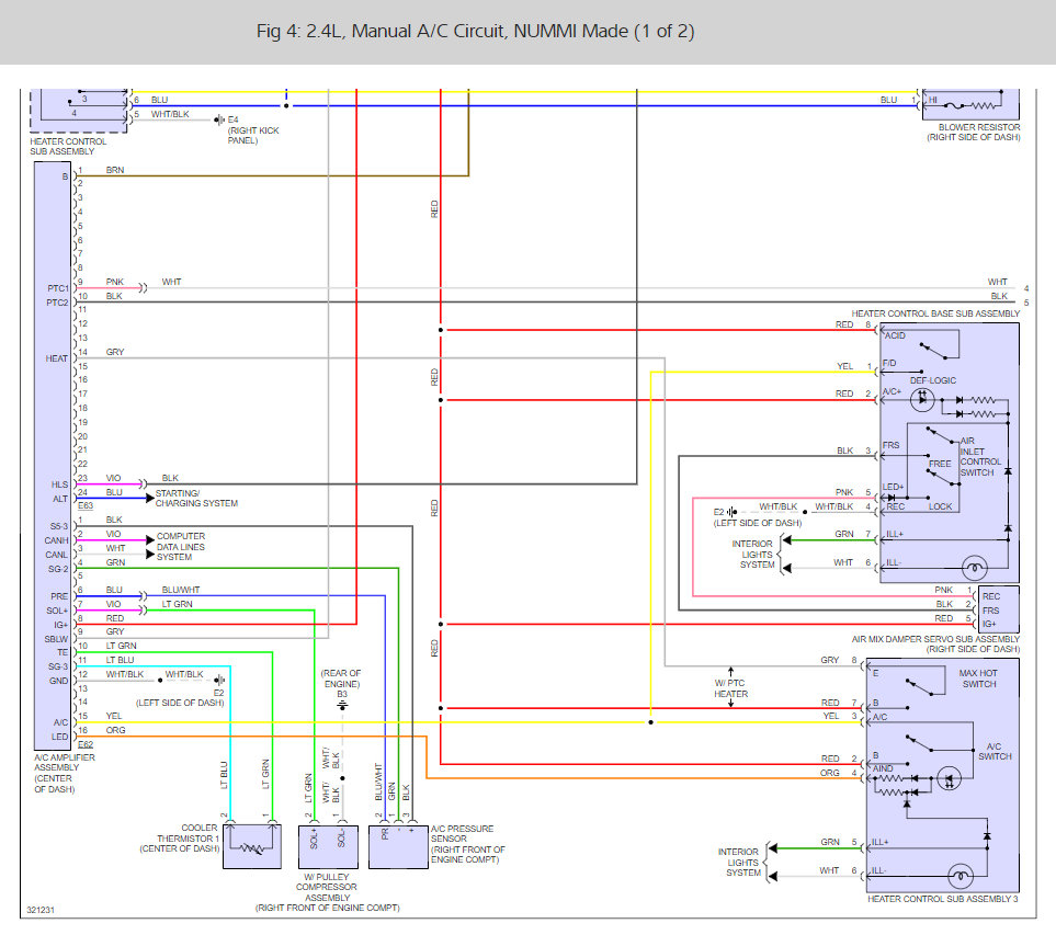

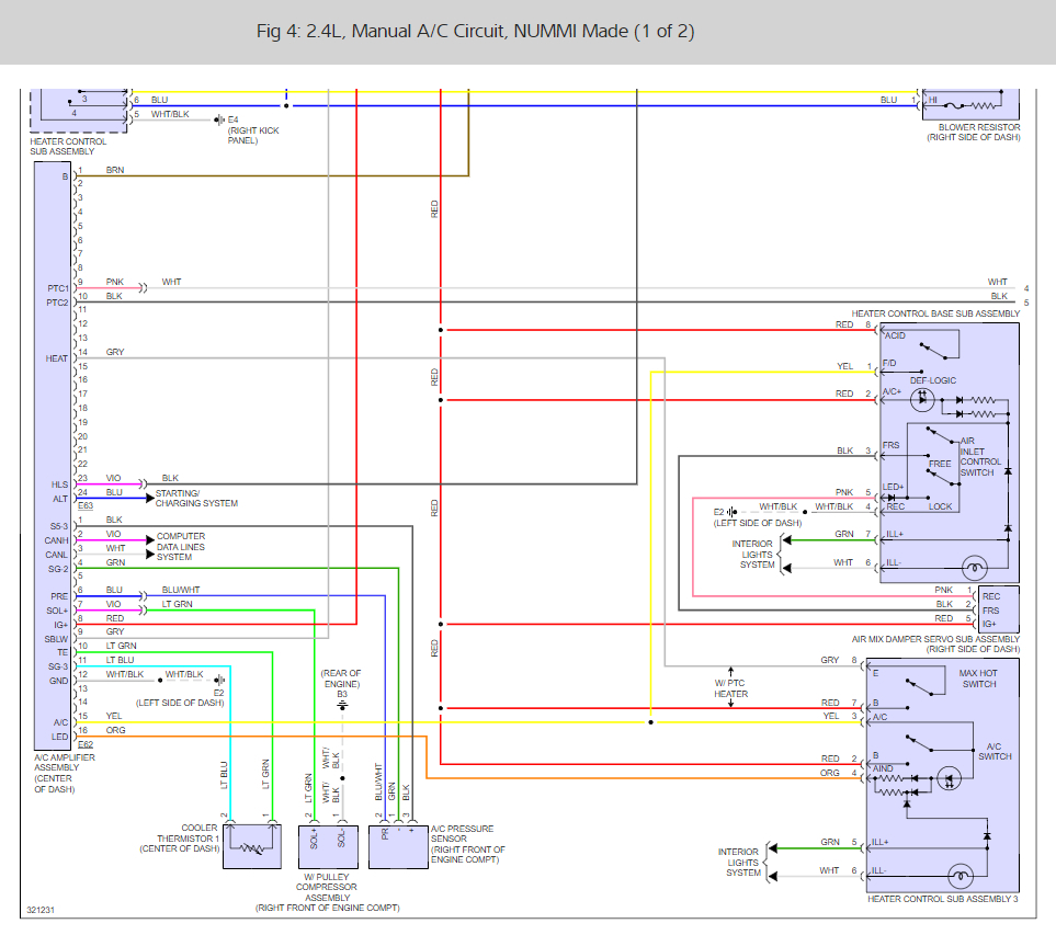

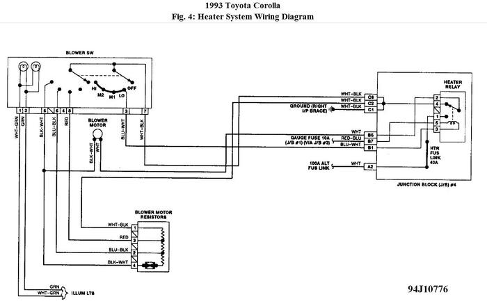

Fan blower/air doesn't run at "high" only at the two lowest fan speeds on '93 corolla. Please help...hottest day of the year. Thanks!
Nov 27, 2018 at 5:30 PM (Merged)

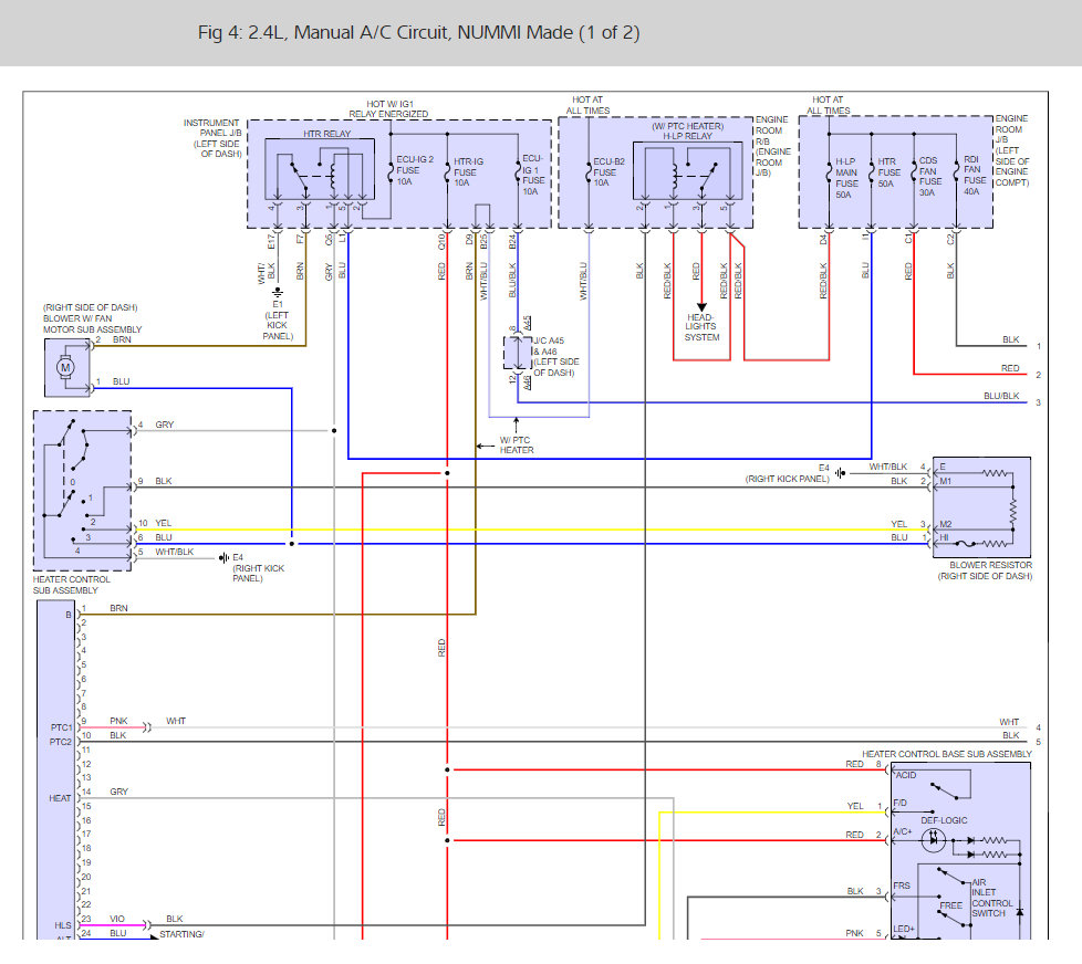

KHLOW2008
  • 41,814 POSTS
Attached is a diagram of the wiring circuit. I believe the blower motor switch is faulty.
