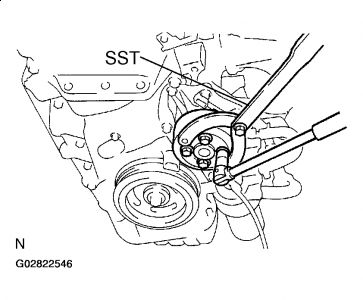

Before you drop any money to the dealership, I would suggest that you take your vehicle to an independent auto parts store such as Checker O'Reilly or Autozone. Battery replacement ($100): Have them check the condition of your battery. They will do this for free. 5 years is about the life of factory battery (if it is the original battery from 2003). Air filter replacement ($25): CSK O'Reilly has Fram CA9360 for $13.99 oil Pan needs to be dropped and re-sealed ($300): If it is not leaking, I would not worry about it. Induction Service($90): Just add a can of Sea Foam $8.99 to clean your fuel system. It is as effective as induction service. Transmission Flush ($160): Most lube/oil places will charge in the neighborhood of $80 - $100 for this service. Or as you mention being handy, you can do it for a lot less, Fram FT1181 is $23.99 plus 4 quarts of Dexron III ATF. Water Pump replacement ($540): Is it leaking? You have external water pump. If it is not leaking, don't worry about it. If it is leaking though, there is no remedy short of replacing the pump. Here is the instruction: 1.Drain Coolant 2.Remove Fan And Generator V Belt 3.Remove Generator Assembly 4. Remove Water Pump Pulley a.Using SST, remove 4 bolts and pump pulley.
https://images.2carpros.com/forum/automotive_pictures/55316_03camrywp1_1.jpg

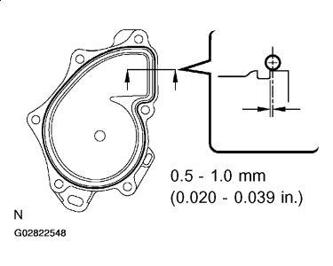

Fig. 1: Removing Water Pump Pulley b.Disconnect the crankshaft position sensor wire harness clamp. 5.Remove Water Pump Assy a.Remove 4 bolts, 2 nuts, bracket and water pump.
https://images.2carpros.com/forum/automotive_pictures/55316_03camrywp2_1.jpg

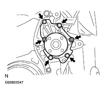

Fig. 2: Removing Water Pump Assembly 6.Install Water Pump Assy a.Remove any old packing (FIPG) material from the contact surface. b.Apply seal packing to the water pump as shown in the illustration.
https://images.2carpros.com/forum/automotive_pictures/55316_03camrywp3_1.jpg

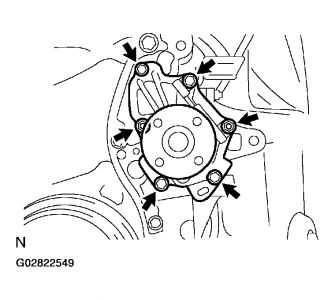

Fig. 3: Applying Seal Packing To Water Pump Courtesy of TOYOTA MOTOR SALES, U.S.A., INC. NOTE: Remove any oil from the contact surface. Install the water pump within 5 minutes after applying. Do not put into engine oil within 2 hours after installing. c.Install the water pump and bracket with 4 bolts and 2 nuts. Torque: 9.0 N.m (92 kgf.cm, 80 in..lbf) d.Connect the crankshaft position sensor wire harness clamp.
https://images.2carpros.com/forum/automotive_pictures/55316_03camrywp4_1.jpg

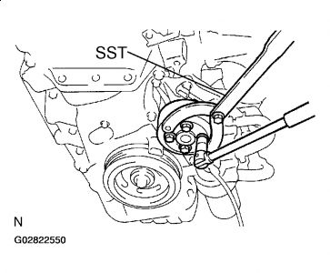

Fig. 4: Installing Water Pump 7.Install Water Pump Pulley a.Using SST, install the pump pulley with 4 bolts.
https://images.2carpros.com/forum/automotive_pictures/55316_03camrywp5_1.jpg
Fig. 5: Installing Water Pump Pulley Torque: 26 N.m (265 kgf.cm, 19 ft.lbf) 8.Install Generator Assembly 9.Install Fan And Generator V Belt 10.Add Coolant 11.Inspect Check For Engine Coolant Leaks
