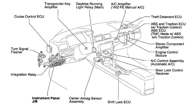

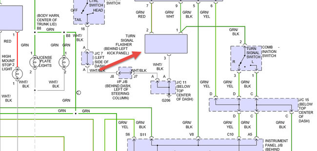

There is another fuse box above the hood release inside, located on the driver's side dashboard. Pull the small coin box. Behind it is the fuse box.
On the reverse of the coin box is the diagram for which fuse is for the tail and turn signal.
The turn signal flasher is located in the relay block behind the drivers side kick panel
See the diagram below for location

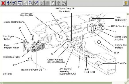

  • 75,988 POSTS
It is behind the left kick panel.
https://images.2carpros.com/forum/automotive_pictures/12900_flasher_16.jpg

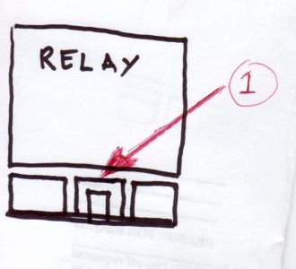

1) Using a tiny screwdriver, pry out lightly the "n" as shown in the red arrow just enough to release the flasher relay lock. Do this on both sides of the flasher relay. And then pull the flasher relay.
https://images.2carpros.com/forum/automotive_pictures/89255_relay_1.jpg

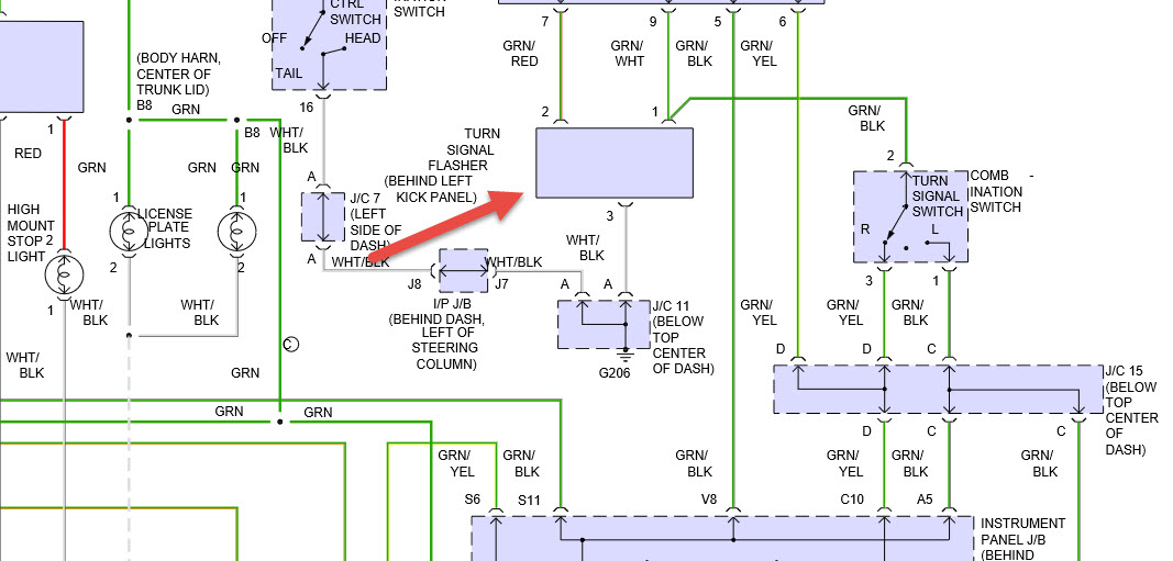

depending on what is wrong we cannot give a cost due to not knowing for sure. check item in pic kick panel is panel by your foot in front of door
