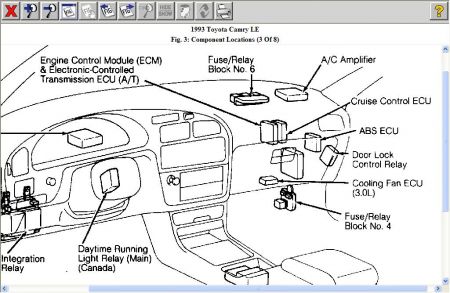

I currently do not have turn signals. i went to the auto store to see what the problem is. I brought the Flasher unit to replace but having a hard time find where the unit is. I, son, dad and uncle have checked under the dash as intruction, but have not been able to locate this. is there a specific place under the dash that i neet look? and what tool do i need to get it out of there?

The flasher is with the starter relay in the block relay no.6 above the glove box.

[quote:1138d33c76="rasmataz"]The flasher is with the starter relay in the block relay no.6 above the glove box.[/quote:1138d33c76]
We have check above the glove box and its not there. i checked under the hood, took the lower panel of the dash off. i have yet to where this is located.

Did someone remove the unit without your knowing?
Follow Rasmataz advice and see if the mentioned position fits the relay.

No there is not place to put this piece above the glove box and yes i did f/u his advice and took the glove box and the under panel off too and there is nothing there. this has become a really big deal hahaha i have taken off the lower panel on the driver side too.

Right or left shows no results, guess you have also tried centre
Good luck
Our models are right hand drives so maybe tomorrow I will try to see for myself if I can get the location and see if it helps.

Look below for the fuse/relay block no.6
https://images.2carpros.com/forum/automotive_pictures/12900_r6_1.jpg
