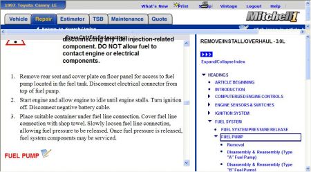

i want to change the filter but a repair manual says you have to relese the preasure in the line at the fuel pump. i do not know how to access the fuel pump.
Jul 16, 2019 at 3:51 AM (Merged)

Hi there,
It is just as easy to crack the top banjo bolt at the fuel filter to release pressure, just place a rag over the union as this will eliminate any unwanted spray and do it with the engine cold.

  • 75,992 POSTS
Do 1-3 below

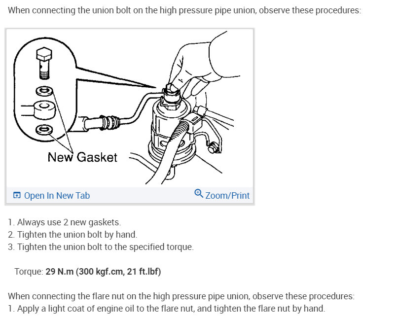

Just the basic tools see below: REMOVAL: Locate the fuel filter on the lower LH side of the engine compartment. EFI Fuel Filter
https://images.2carpros.com/forum/automotive_pictures/12900_ff1_7.gif
If vehicle has been operated within an hour, the fuel system is probably under pressure and requires caution when removing filter union bolts. Slowly loosen the filter union bolts. Some gasoline may escape, so ensure that the potential for fire is minimized. EFI Fuel Filter
https://images.2carpros.com/forum/automotive_pictures/12900_ff2_2.gif
Remove the union bolts and four gaskets. Loosen filter clamp and slip filter from clamp. INSTALLATION: Slip new filter into clamp. Ensure that flow arrows are in the correct direction. Position filter in the middle of the clamp and tighten filter clamp. Reinstall both union bolts with four new gaskets. Torque union bolts to 13 ft.lbs. (18 N-m). DO NOT overtighten union bolts. Clean any gasoline that may have escaped. Start the engine and check for fuel leaks.

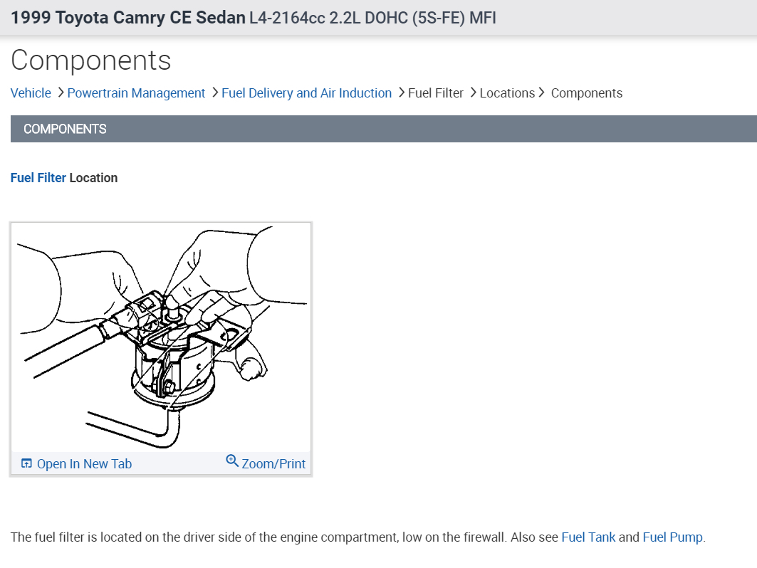

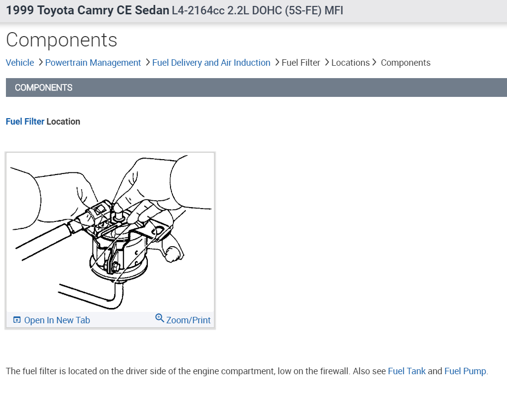

  • 75,992 POSTS
REMOVAL:
1.Locate the fuel filter on the left frame rail in the engine compartment.
CAUTION: If vehicle has been operated within an hour, the fuel system is probably under pressure and requires caution when removing Filter union bolts.
2.Place a shop towel over the fittings and place a suitable container underneath to contain spilled fuel. Slowly loosen the Filter union bolts. Some gasoline may escape, so ensure that the potential for fire is minimized.
3.Remove the union bolts and four gaskets.
4.Loosen Filter clamp and slip Filter from clamp.
INSTALLATION:
1.Slip new Filter into clamp. Ensure that flow arrows are in the correct direction.
2.Position Filter in the middle of the clamp and tighten Filter clamp.
3.Reinstall both union bolts with four new gaskets.
4.Torque union bolts. DO NOT overtighten union bolts.
Torque: 29 Nm (22 ft.lb) .
5.Clean any gasoline that may have escaped.
6.Start the engine and check for fuel leaks.
