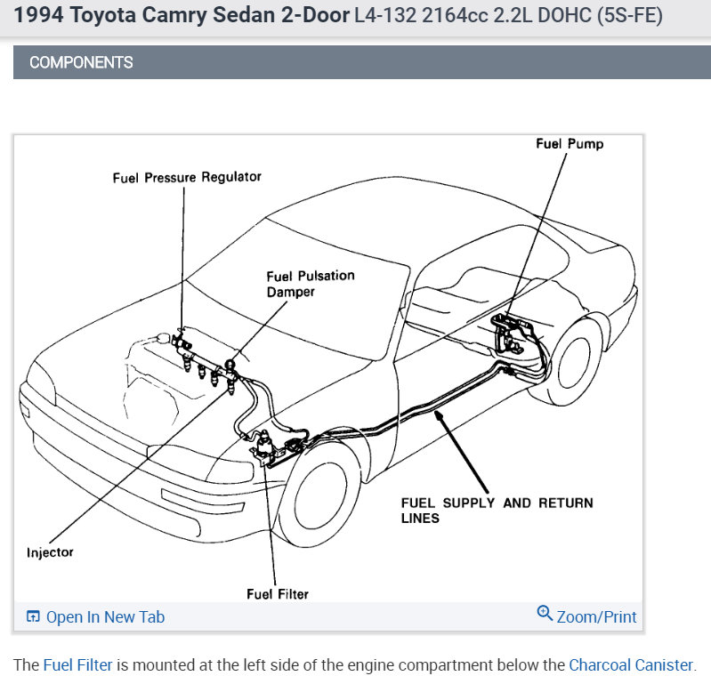

Where is the fuel filter located on a 1994 toyota camry

The fuel filter is up by the brake booster near the front of the car here is a diagrams to show you where and a guide to walk you through the process.
https://www.2carpros.com/articles/how-to-change-a-fuel-filter
Check out the diagrams (Below). Please let us know if you need anything else to get the problem fixed. Cheers,

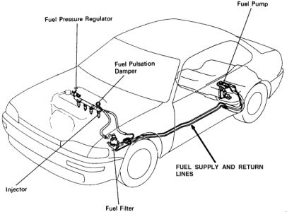

Where is fuel filter located?

The fuel filter is mounted on the driver side of the engine compartment, below the charcoal canister
https://www.2carpros.com/forum/automotive_pictures/12900_fuel_filter_4.jpg

The fuel filter located under the air intake tube that carries the air to the throttle. Remove that black tube, only 3 screws/nuts and then u see the black filter there. Remove the nut that lies on top of the filter, then the one at the bottom. The bottom one is a bit hard to get to. Then remove the clamp that secures the filter to the car, again only 2 nuts/screws. Replace and reverse directions.

Follow the aircleaner duct before it gets to the throtttle body its right below the duct at driver side-

Its located on the driver's side fender well
