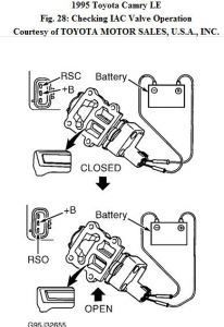

I still think the IAT is faulty !! it should read between 0.2 and 0.3 @212 degrees ..yours is below 0.2 ? do you happen to remeber the OHMS and temperature when you first started the test ??...this signal controls air/fuel ratio on cold start up !!
Intake Air Temperature (IAT) Sensor
Intake air temperature sensor is mounted in either airflow meter or air filter housing. Intake air temperature sensor measures incoming intake air temperature and delivers an input signal to THA terminal of Engine Control Module (ECM) for controlling fuel injection system, fuel pressure control (if equipped) and heated oxygen sensor systems (if equipped).
There are no TSB's regarding the IAC valve .. but you can test it !!
To check IAC valve operation, remove IAC valve from throttle body. Connect battery voltage and ground to proper terminals and ensure valve opens and closes. See Fig. 23. Replace IAC valve if defective.
https://www.2carpros.com/forum/automotive_pictures/266999_iac_6.jpg
Let me know

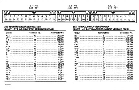

I checked the voltage coming to the IAT from the ECM and my Haynes manual says it should read 5 volts and I can't get any reading on my meter.
Thursday, March 19th, 2009 AT 11:26 AM

The car was cold when I started it without IAT hooked up. It started up ok but I didn't let it run but a few maybe 10 sec. I rechecked the voltage to the IAT(with the key ON this time ) and it read 3 volts.

I tried to start the car yesterday afternoon and I couldn't get it started so much so that I had to recharge the battery. Then I go out this morning unplug the IAT and it starts right up. Runs for 10 secs. Then shuts down. I restart it and take it up to 2000 RPM and after about 15 or 20 secs. It tries to shut down and then the RPM comes back up and it continues to run for a minute or so then I shut it off. Is that wierd or what? I just can't understand it. I was checking my voltage wrong on the IAT plug. But this morning I got a good reading and it read 4.98 volts coming from the ECM.

My manual is telling me you should be getting 3.4 volts MAXIMUM @ cool engine condition. Of course this all depends on outside ambient air temp and what reading the IAT sensor is sending to the PCM. Regarding ambient air temp !
