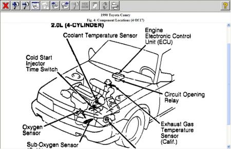

The cold start injector is faulty, it hooks right into the intake manifold, gives extra fuel on cold starts
Monday, October 1st, 2007 AT 4:51 AM

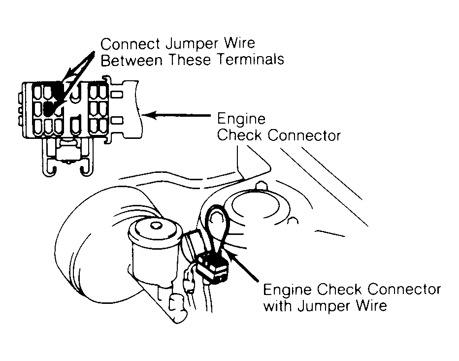

Tried an OBD 1 and could not retrive any codes!
PS For a good measure I replaced the igniter, fuel pump and filter.
Perlexed
Thursday, June 18th, 2020 AT 10:10 AM (Merged)
  • 75,992 POSTS
Tried an OBD 1 and could not retrive any codes! Jumper the Te-1 to E-1 terminal in the check connector read the flashes.

Now a really dumb question, I can't locate the ECM. Haynes manual says behind the glove box or near center console.
Behind glove box I see only I think 4-way flasher and duct work for air delivery.
In the center console region, more duct work for heating and air delivery.
Is this thing staring me in the face? Size wise I'm looking for something the size of a desk top computer hard drive, correct?

  • 75,992 POSTS
The computer/ ECU is located under the center of instrument panel behind console
https://www.2carpros.com/forum/automotive_pictures/12900_ecu_5.jpg
