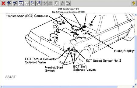

The problem still existed after cleaning fuse box. After cleaning, I turned key and it started up. I shut it off, moved the gear selector down to low then back to park, turned the key and nothing. I tried wiggling the fuse, no luck. I got back in and moved the selector side ways then up and down. I then turned the key on and it started. Is there a switch in the park pos. To allow you to start? Bad connection? Thank you
Friday, December 12th, 2008 AT 6:55 PM
  • 75,992 POSTS
Disconnect the neutral/start switch at the tranny jumper the connector and try again and see what happens.
Jumper the black and white to the black wire at the N/S switch connector-Good Luck
