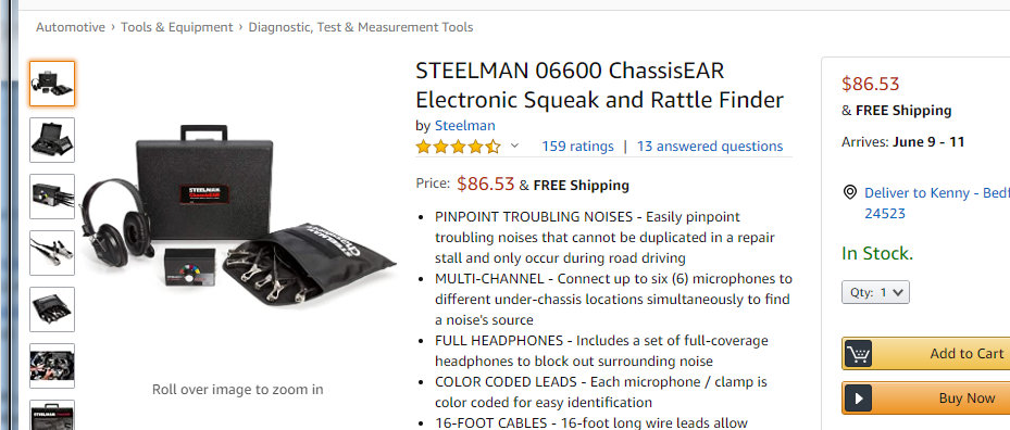

Can you check the local parts store that has a tool rental program and see if they have a set of chassis ears? Basically these are microphones that you place around the vehicle and transmits the noise into the speaker/headphones that you place inside the car.
Let me know if you can get a recording of it and I am sure we can figure out what to do next. Thanks

Okay. Thanks for the update. They are not a common component but they are not too expensive to purchase them if you want to. I attached a pretty common set that most mechanics purchase.
Clearly these are not something that you will use very often so it would be better to rent them but if you can't figure out what this is and you have someone look at it, they are going to charge at least $100.00 to figure it out. Just a thought.
I would say to try and get the recording and if we still can't figure it out then maybe buy a set if you want.
