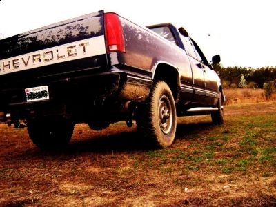

i have a 94 chevy silverado and whenever i get to 25mph and over my truck makes almost a rustling noise, coming from what it sounds like the front tires? you can especially hear it when riding next to a curb or close to a building and it's getting louder. What could this be?[img:7097b7e456]http://www.2carpros.com/forum/automotive_pictures/348052_twrsd_1.jpg[/img:7097b7e456]
