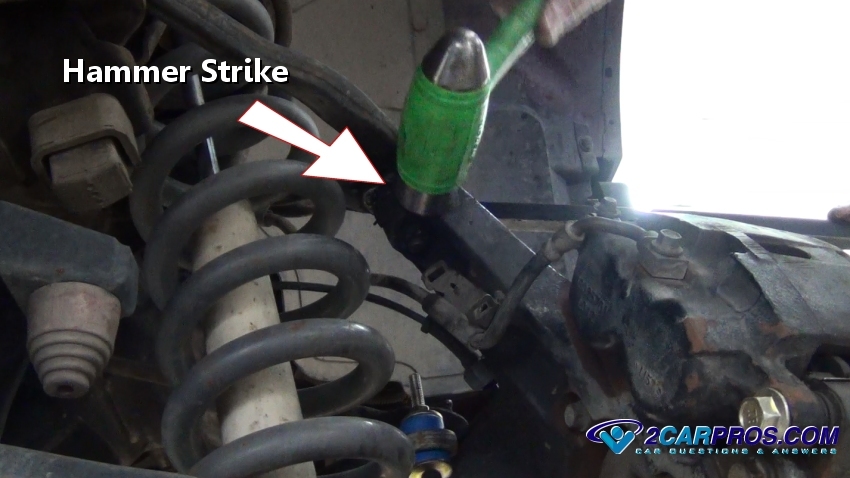

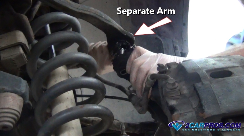

2. Undo the Upper Ball Joint: After removing the cotter pin (if equipped) use a 18mm wrench (size may vary) to loosen the ball joint nut about 3 turns. Do not remove the nut completely because it will protect the upper ball joint threads during removal. Insert and wedge a large pry bar between the upper control arm and spindle while pushing downward to apply pressure to the upper ball joint taper fitted stud.
While holding pressure on the ball joint strike the spindle bulkhead with a hammer. You will hear a pop meaning the taper fit stud has been released from the spindle, once the taper fit has been released finish removing the ball joint nut. Lift the arm from the spindle. Use caution if any rubber brake lines are involved when the spindle comes loose and remove the line mounts if needed.

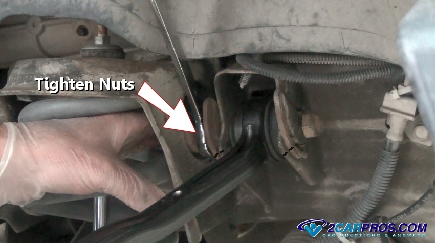

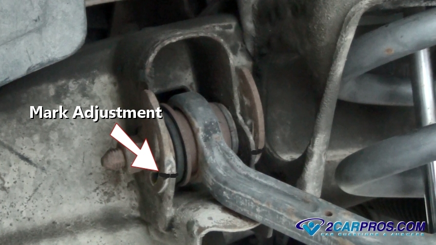

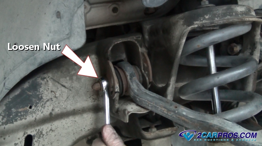

3. Remove Upper Control Arm Bushing Bolts: Mark the alignment adjusters using a felt pen and reference these marks when reassembling. Other designs will use a shim or a series of shims which must be reinstalled as they were removed. Use a 18mm wrench or socket (size may vary) to loosen and remove the nut on either side of the arm.
remove upper control arm frame bolt
4. Remove the Upper Control Arm: After both nuts have been removed, slide the bolts from the control arm mounts while keeping the adjusters in order. To remove the control arm use a upward motion on the arm while pulling outward.
remove front suspension upper control arm

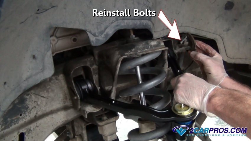

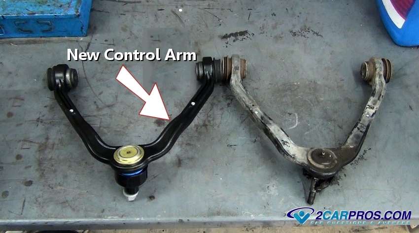

5. Install the New Upper Control Arm: Once the control arm has been removed match it against the old part to ensure a proper installation. Some control arms are designed using Zirk fittings to allow lubricant (grease) to be injected. Install the fitting and tighten it using an 8mm wrench. Install the new control arm into the frame mounts. This might take some doing while moving the arm up and down and pushing inward to line up the mounting bolts.
While aligning the bolt holes, install both mounting bolts in the same position as they were removed. Use a wrench or socket to tighten the both mounting bolts while keeping the alignment adjusters or shims in place. These bolts might be difficult to get a torque wrench on, but you want to tighten these bolts to manufacturer's specifications which are usually between 65 and 75 foot pounds.

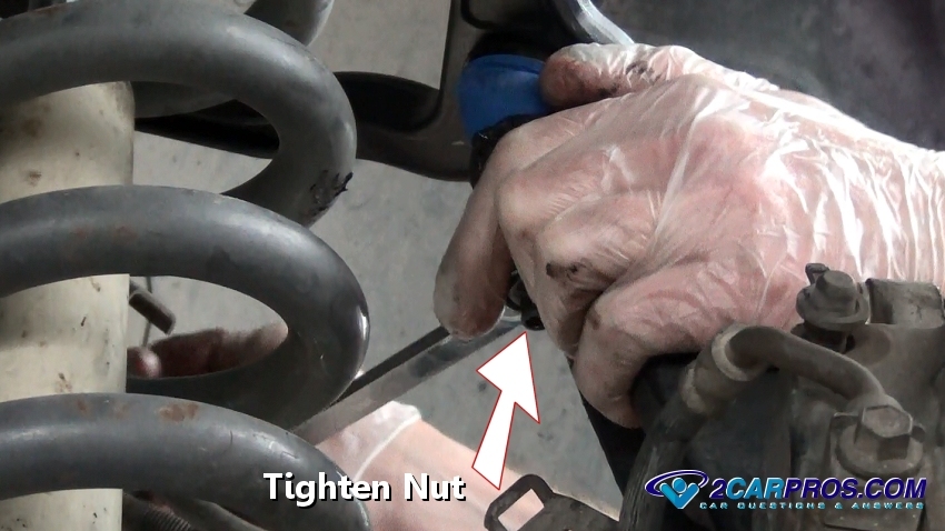

6. Reconnect the Upper Ball Joint: Insert the upper ball joint into the upper spindle bulk head. Use a hammer to gently tap the taper fit stud into place which will keep the stud from turning while installing the nut, alternatively you can apply downward pressure. Install the upper ball joint nut by hand to avoid cross threading, use a wrench to tighten the upper ball joint mounting bolt. Use a socket and a torque wrench to tighten the nut to manufacturer's specification which is usually between 60 and 70 foot pounds, install a new cotter pin (if applicable).

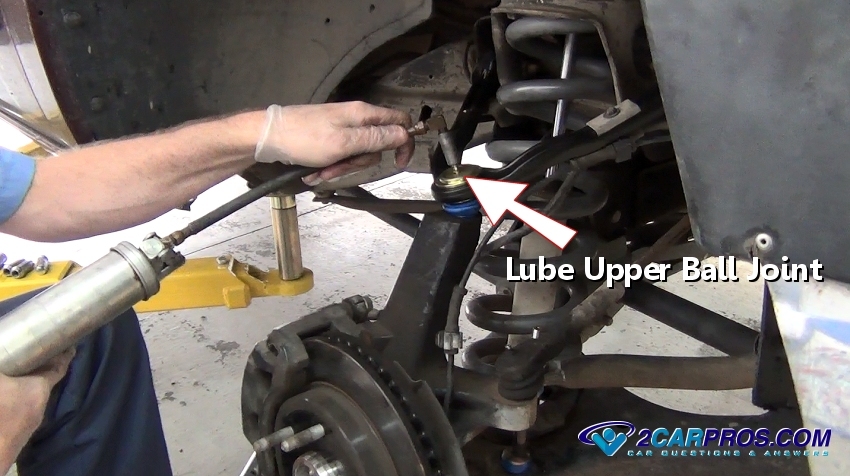

Reattach any brake line, wiring holders or clips removed in the repair. Once the job is complete lube the upper ball joint using a grease gun. lower the hydraulic jack and reinstall the wheel and you are all set!
