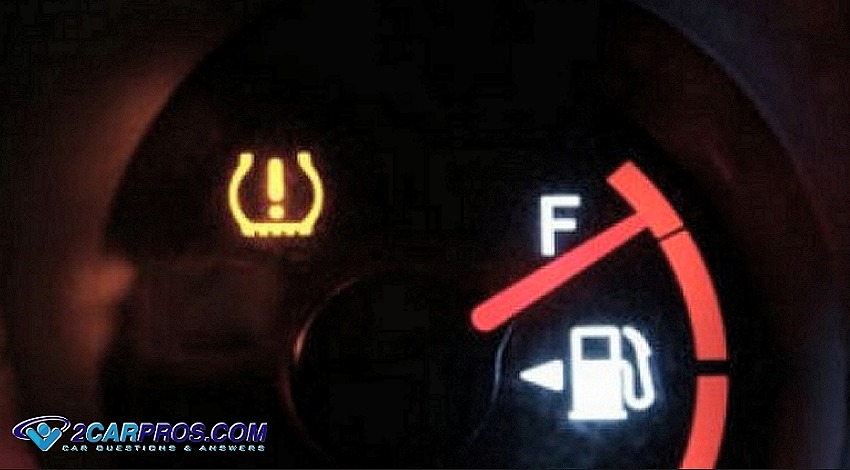

low tire warning light

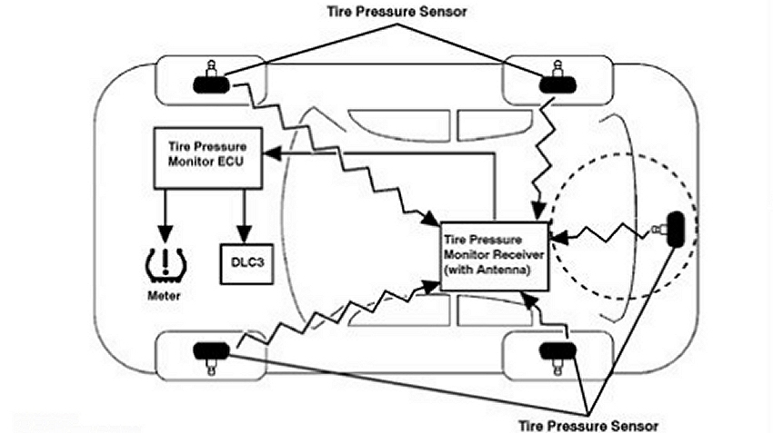

Pressure sensors are used to monitor individual tire pressure in all tires including the spare. If air pressure in any given tire goes below or above minimum or maximum requirements the warning light will illuminate. The image below shows how the LTI system is configured which includes a sensor in each tire, the control unit, pressure receiver which includes an antenna and a LTI warning light located in the dash cluster.
low tire warning system
Nine times out of ten when the system has a problem it will be a tire pressure sensor, which requires the tire to be removed from the rim and the sensor replaced. If  the warning system warns that all the tires are low chances are the main controller or receiver needs to be replaced. Again, that can be checked by performing a CAN scan.
