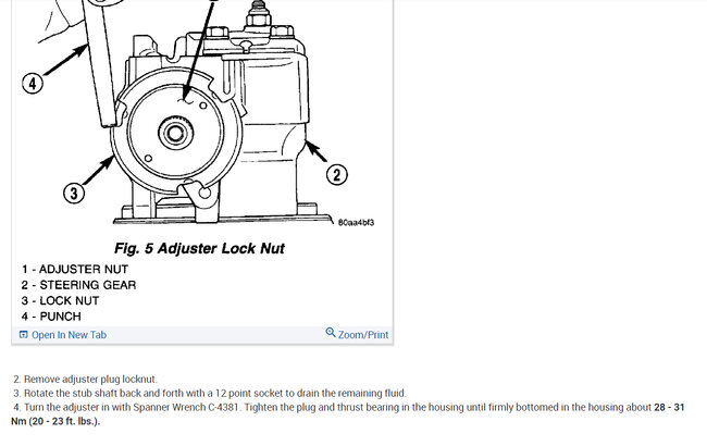

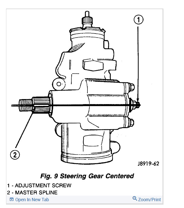

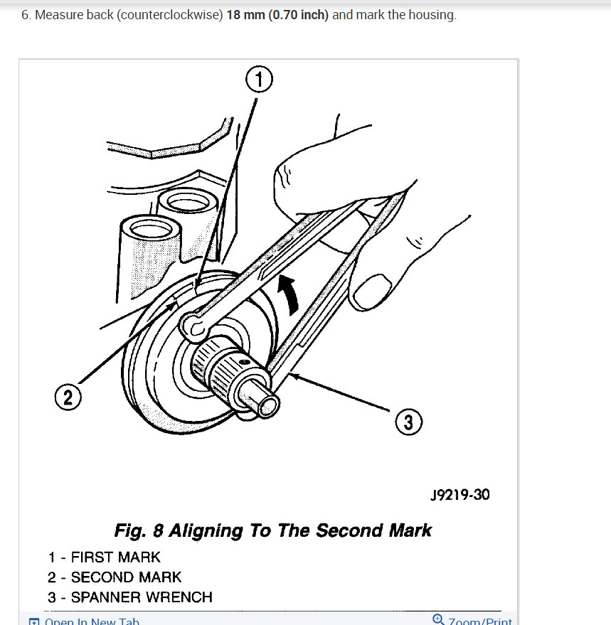

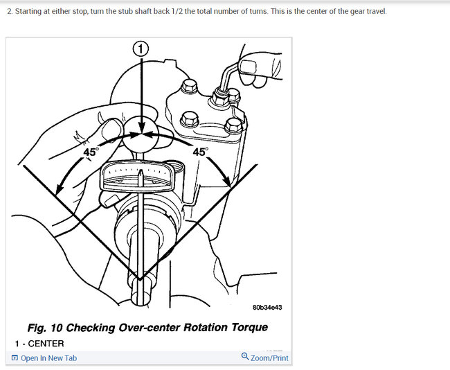

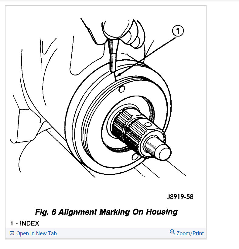

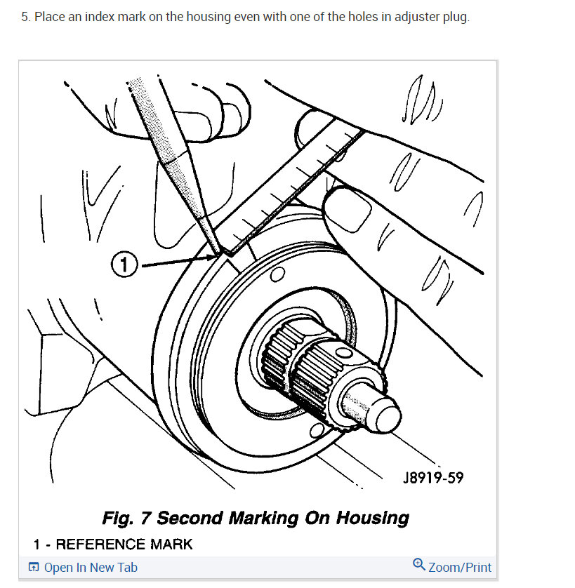

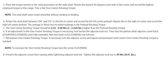

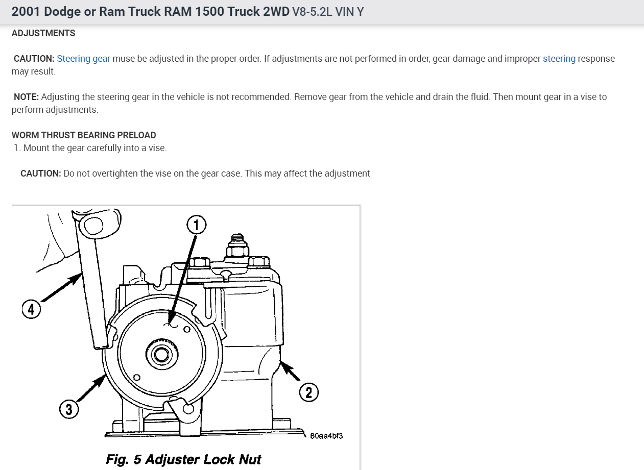

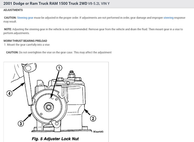

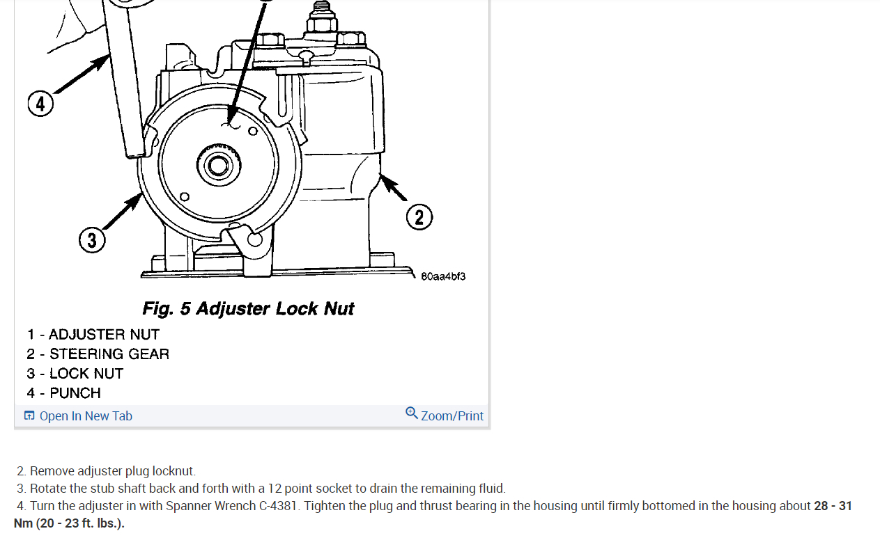

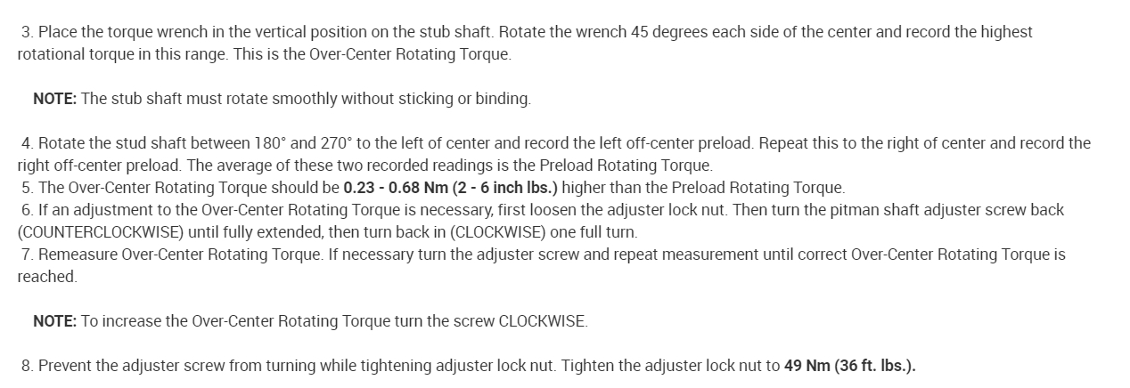

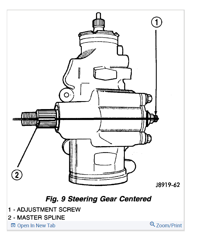

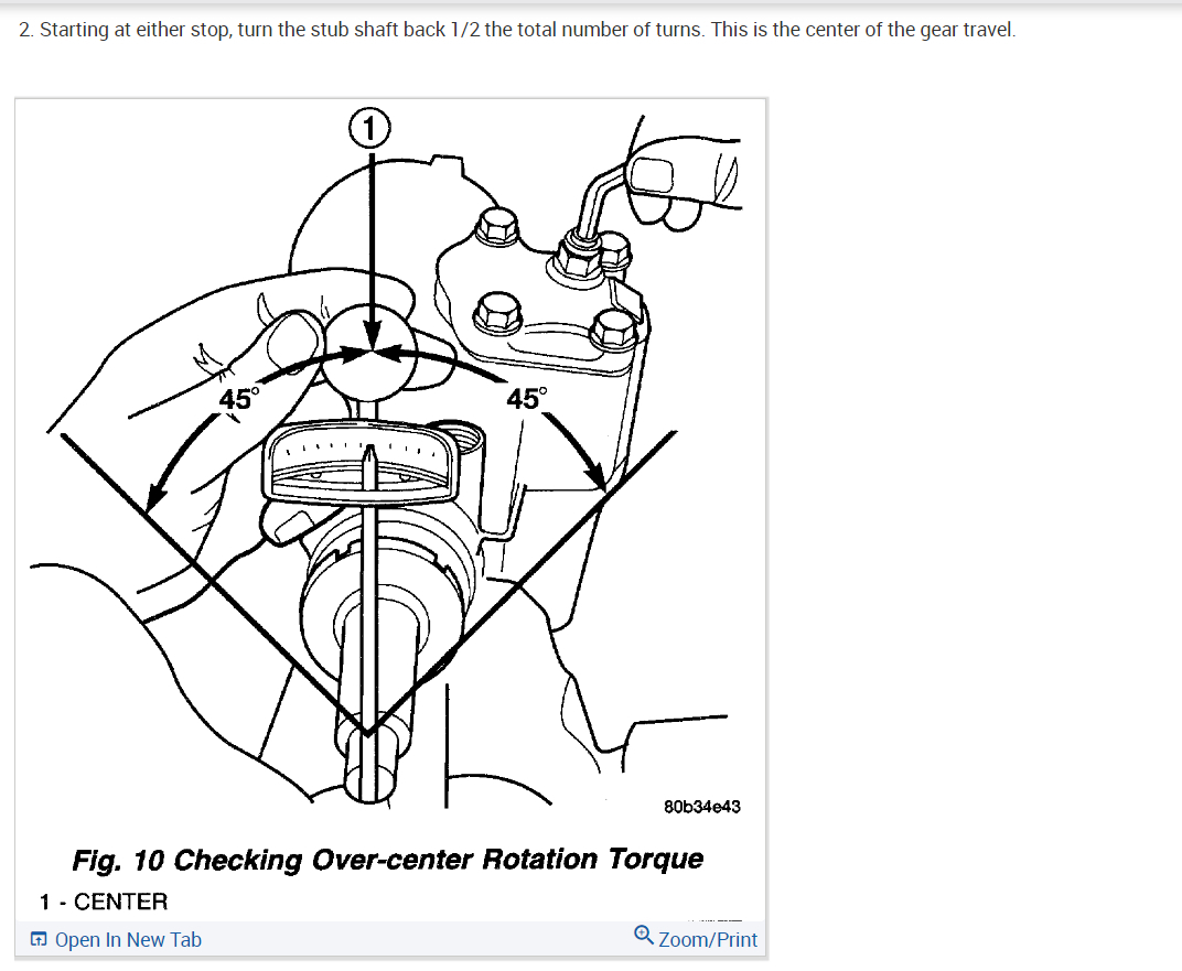

I replaced the input shaft seals on the gear box. I put it back together and it turns smooth both ways while the tires are off the ground, and the truck is not running. Start the truck, it will not turn to the right. The left is good. Help please.
Feb 12, 2023 at 12:32 PM
  • 55,456 POSTS
This is because the selector valve is not working which controls where the fluid pressure is directed to, or the adjustment is off. here is how to set up the steering box in the images below. Thanks for using 2CarPros.
