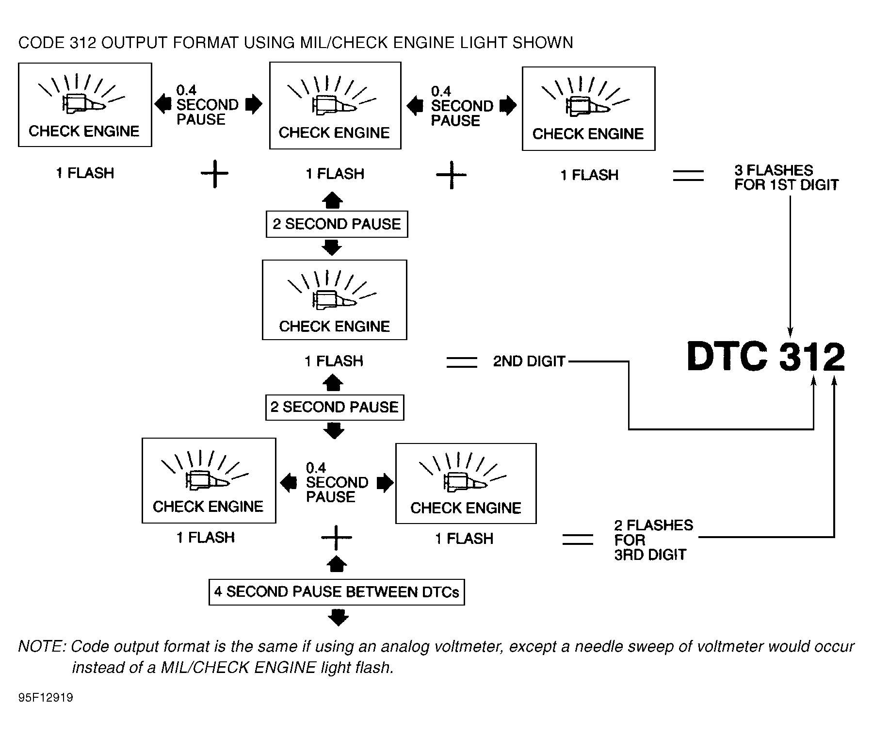

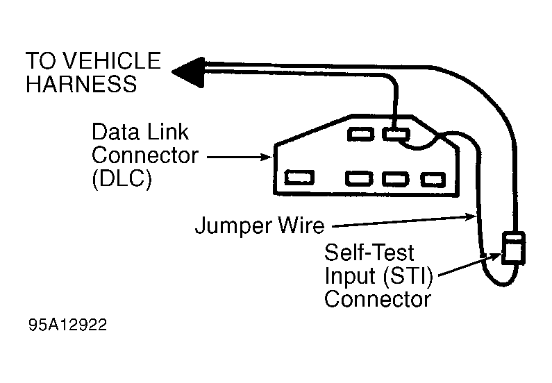

Find Data Link Connector left rear engine comp> Hook up as shown in diagram and read MIL flashes. Post any codes

No engine light no code took it Ford and couldn't find anything gave it a body throttle cleaning but no luck. Let me go back to say that I had the head gasket replaced due to white smoke and from there it began check compression good. I can't remember what else.
