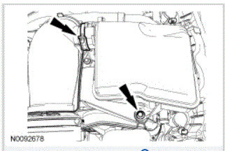

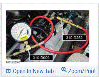

Stalls after driving for a while. Codes P0171, p0131, p0150, p0172, p0174, p0175, p0300, p0456, p2195 and p2197.
Jun 25, 2020 at 4:12 AM
  • 110,244 POSTS

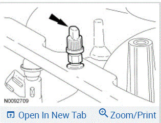

Interestingly, most of the codes you listed contradict each other. However, I have a plan. The 171, 172, 174, and 175 all indicate both a lean and rich fuel mixture for both banks. That doesn't make sense. It should be one or the other. The 300 is likely caused by a fuel mixture issue and the 131 indicates a low voltage from bank 1 sensor 1. Now, the 2195 and 2197 are showing the oxygen sensors are stuck in the lean setting for both banks. So, I'm questioning if the rich codes were set first and now the vehicle is sticking in lean to compensate. Check out the diagrams (Below).
Here is where we need to start. I need to confirm fuel pressure. If the pressure is too high due to a faulty regulator, it will be dumping fuel causing this.
Here is a link that explains in general how it's checked:
Here are the directions and specifications specific to your vehicle. The attached pics correlate with the directions.

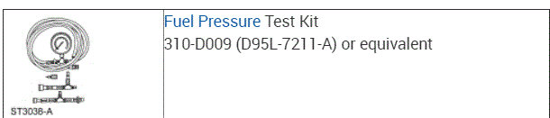

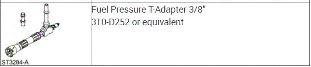

Fuel Pressure T-Adapter 3/8"
310-D252 or equivalent

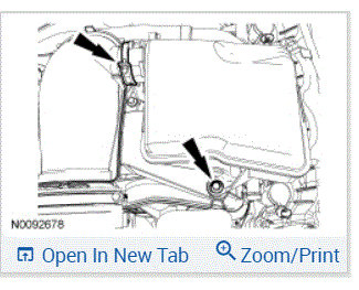

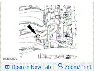

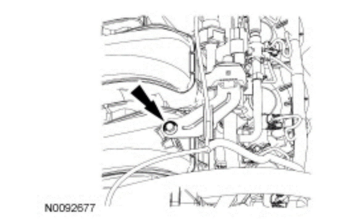

If servicing a 4.6L (3V) engine, remove the Evaporative Emission (EVAP) purge valve bracket bolt and position the bracket aside.
If servicing a 5.4L (3V) engine, remove the air intake resonator assembly bolt and loosen the clamp. Rotate the resonator upward until it stops.

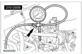

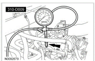

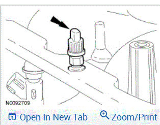

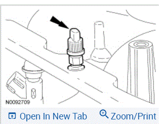

Remove the fuel pressure relief valve cap.
Install the Fuel Pressure Test Kit onto the fuel pressure relief valve.
NOTE: It may take more than one key cycle to pressurize the fuel system.
Cycle the ignition key to the on position and wait 3 seconds to pressurize the fuel system. Check for leaks before starting the engine.
Test the fuel system pressure to make sure it is within the specified range. For additional information, refer to Specifications in this section.
NOTE: 4.6L (2V) shown, 4.6L (3V) and 5.4L (3V) similar.
NOTE: Open the drain valve slowly to relieve the fuel system pressure. This may drain fuel from the system. Place the fuel in a suitable container.
Upon completion of the fuel system pressure test, open the drain valve on the Fuel Pressure Test Kit and relieve the fuel system pressure.
Install the pressure relief valve cap.
Tighten to 6 Nm (53 lb-in).
If servicing a 4.6L (3V) engine, position the EVAP purge valve into place and install the bracket bolt.
Tighten to 10 Nm (89 lb-in).
If servicing a 5.4L (3V) engine, rotate the air intake resonator assembly into position and install the bolt.

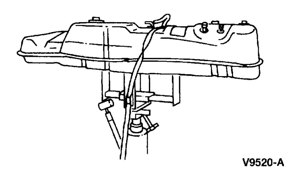

6.2L (2V) engine
Release the fuel system pressure. For additional information, refer to Fuel System Pressure Release in this section.
Disconnect the fuel tube quick connect coupling. For additional information, refer to Quick Connect Coupling in this section.
Install the Fuel Pressure T-Adapter 3/8" and Fuel Pressure Test Kit in line between the fuel supply line and fuel rail.
NOTE: The Fuel Pump Control Module (FPCM) electrical connector was disconnected during the fuel system pressure release and must be reconnected to complete the Fuel System Pressure Test.
Connect the Fuel Pump Control Module (FPCM) electrical connector.
Connect the battery ground cable. For additional information, refer to Section 414-01 .
Cycle the ignition key and wait 3 seconds to pressurize the fuel system. Check for leaks before starting the engine.

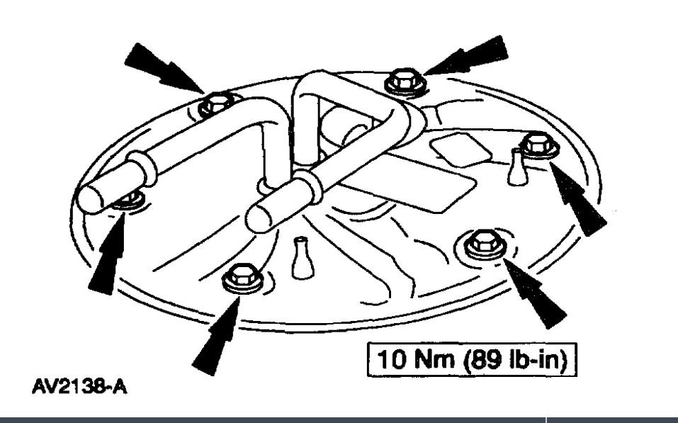

I recently bought a fuel pressure test at an auto parts store and when I hooked it up I was only getting about 17 psi when idle. Did a long term fuel pressure drop as well, but the pressure remains for a good 8-10 hours but does drop overnight. Another odd thing is when key is set to on but not starting, the pressure barely climbs any psi (only about 1-2 psi). Starting to think that the fuel pump is going bad, also I bought a new fuel filter because it’s about time to replace it as well. Just want to know any suggestions on this matter. This was a solution I was looking into for my truck hesitating while starting. What I mean by hesitation is the truck will start, but sometimes it will take 4-8 seconds.
May 29, 2021 at 3:35 AM (Merged)
Good evening,
You need a fuel pump. You confirmed your self with the pressure test. That is also the reason for the delayed starting as well.
https://www.2carpros.com/articles/how-to-replace-an-electric-fuel-pump
I would replace the filter as well when you do the pump.
https://www.2carpros.com/articles/how-to-change-a-fuel-filter

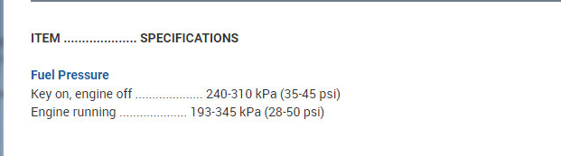

Gasoline KOER 28-45psi (2.0-3.2) KOEO 35-45psi (2.4-3.2

  • 75,992 POSTS
2001 Ford Truck F 150 2WD Pickup V8-4.6L SOHC VIN W
Fuel Pressure
Key on,engine off 240-310 kPa (35-45 psi)
Engine running 193-345 kPa (28-50 psi)

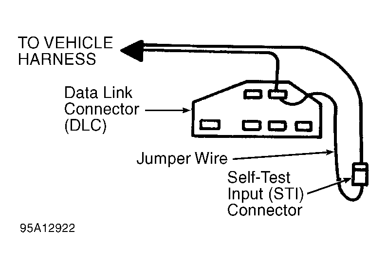

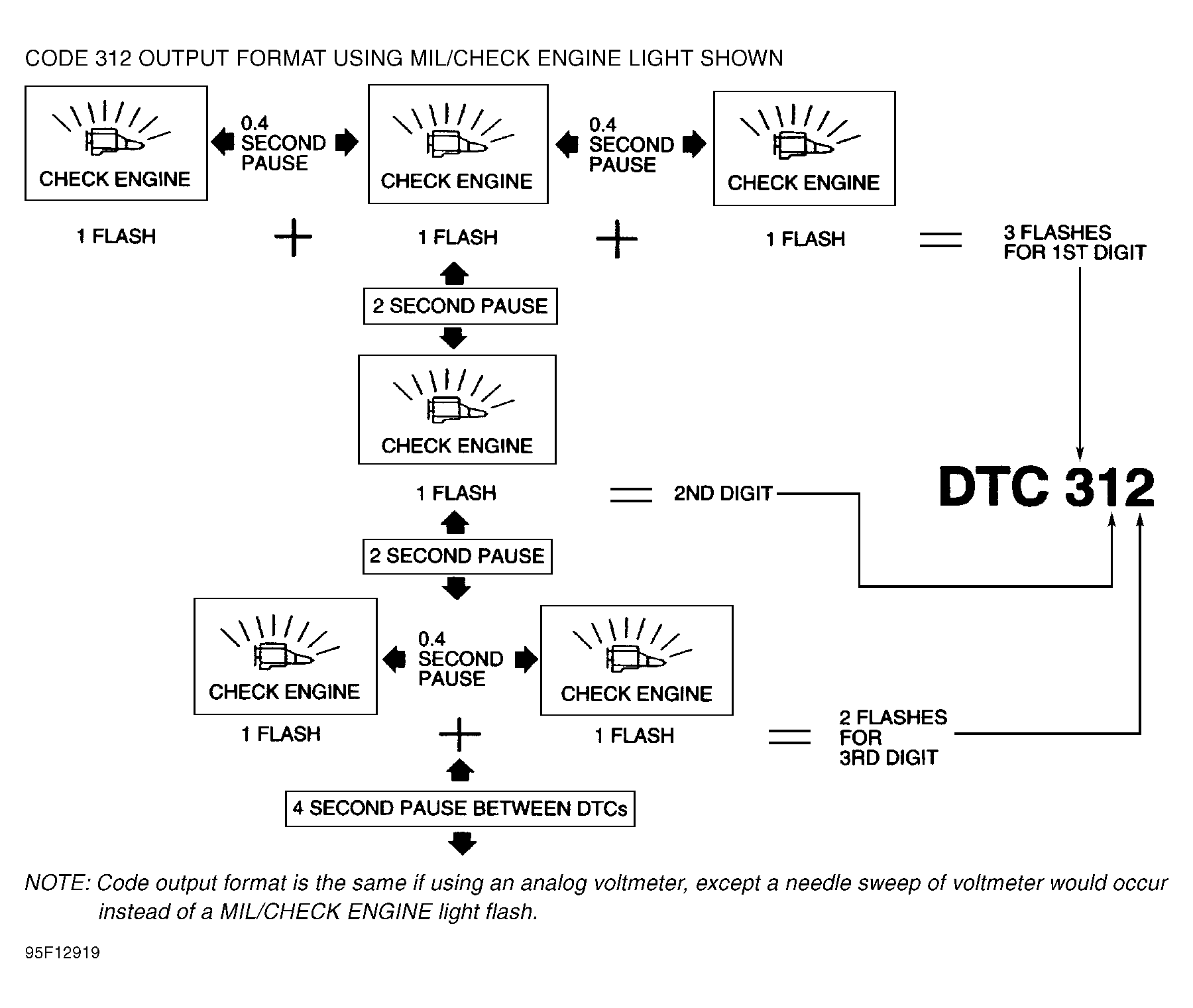

Find Data Link Connector left rear engine comp> Hook up as shown in diagram and read MIL flashes. Post any codes
