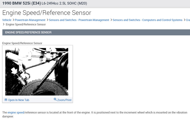

My car will not start when cranked because I noticed the following:
(1) The spark plugs will not produce light when cranked.
(2) The pump fuse does not transmit current thereby making it unable to supply fuel. But when directed with other fuse line that has current, it pumps constantly without starting when cranked, since the spark plugs will not produce spark light.
(3) What could be responsible for the above failure?

This sounds like the crankshaft angle sensor is not working. Here is the location so you can change it out.

Thanks I sincerely appreciate it. In fact I have experienced this before and hope to repeat it again you have advised and get back to you as soon as I get it replaced.

Everything is okay now. Thanks a million.
