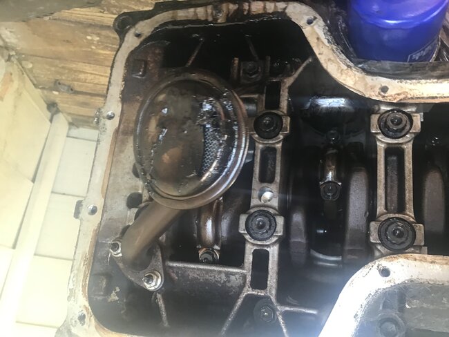

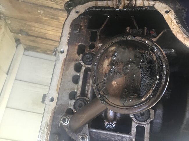

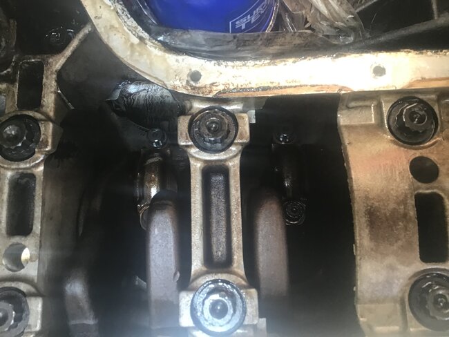

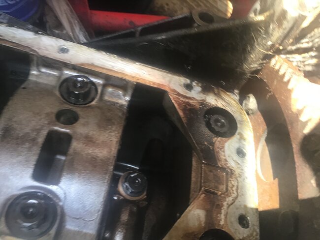

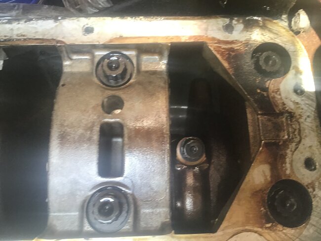

Not sure if you see the scorched oil stains, but to me it screams a problem. Correct? Or does this part of engine look like this usually?
Thursday, March 23rd, 2023 AT 2:50 PM
  • 109,896 POSTS
No, it doesn't look normal. Wow, that did a lot of damage. Not being there makes it difficult, but I feel confident that it is done.
If you can, take a few pics of the other engine. Make sure you take it apart for inspection before using it.
Let me know if I can help in any way.
Take care and hang in there.
Thursday, March 23rd, 2023 AT 4:51 PM

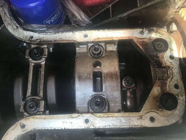

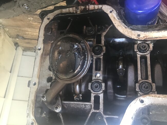

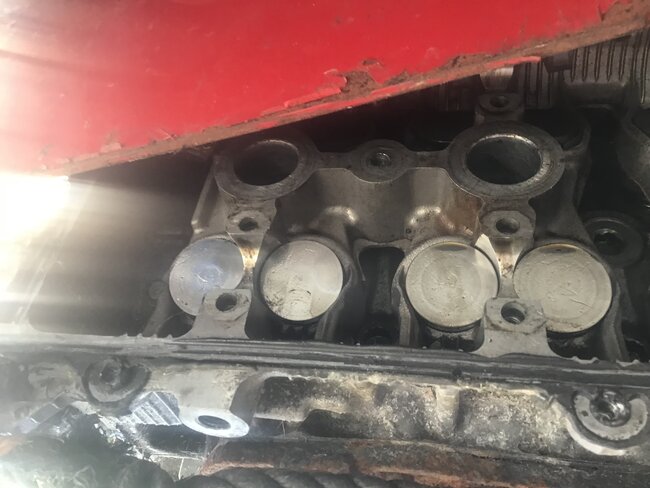

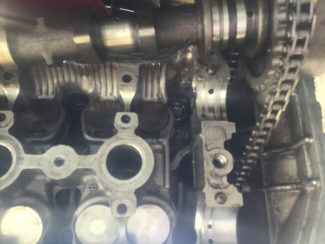

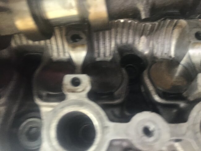

Okay, here is my old engine. As I’m taken the pictures I like okay why did I change it, this one still looks great and way better than the other.
Friday, March 24th, 2023 AT 4:17 PM
  • 109,896 POSTS
Looking at the pictures, if I had to guess, you had an oil pressure issue that led to bearing problems. Do you remember it knocking, ticking, or the oil light being on? I ask because the oil pick-up tube/screen looks corroded.
Friday, March 24th, 2023 AT 10:21 PM
DC CRENSHAW
  • 36 POSTS
Before it was towed, it ran just fine as far as I remember. The reason I swapped it out was because it locked up I believe. It would have to be an issue with the top half locking up. As you see the bottom half looks good. Do I just unbolt the bottom half as I would the top half? Then just swap out. Or do you have any suggestions on how I should proceed with repairs?

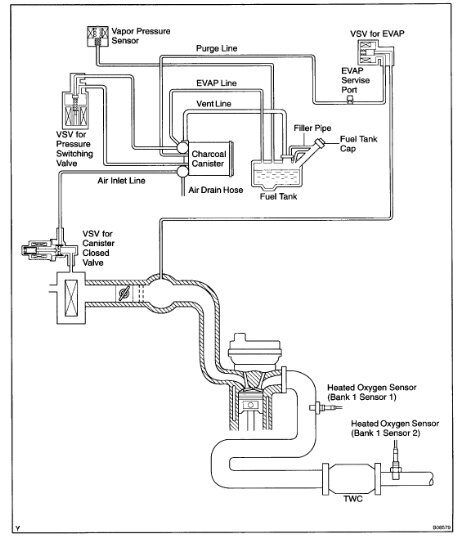

If possible, do you have a diagram for the way vacuum lines connect?
Sunday, May 14th, 2023 AT 4:37 AM
  • 109,896 POSTS
As far as vacuum schematics, I have one which I attached below. Now, the engine size is for a 1.8L which is the only one listed for this vehicle. Let me know if that is correct.
Next, if there is no spark, it won't run. Are you getting an RPM signal when cranking?
See pic below.
Sunday, May 14th, 2023 AT 7:28 PM
