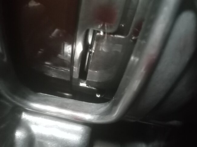

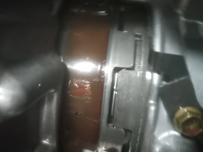

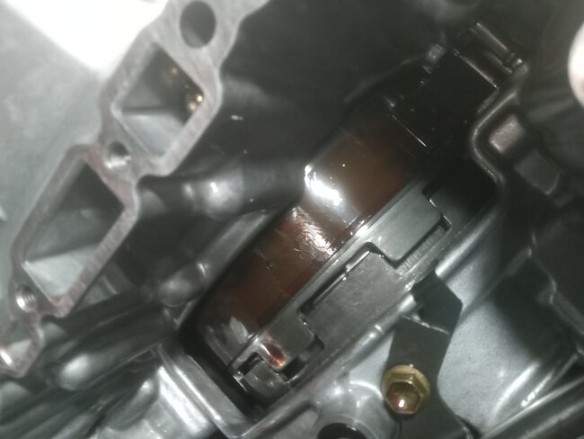

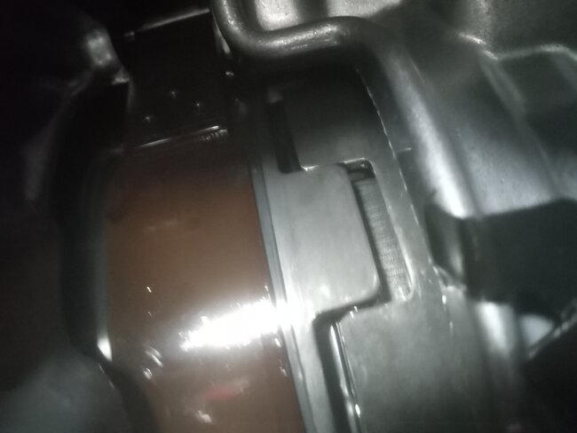

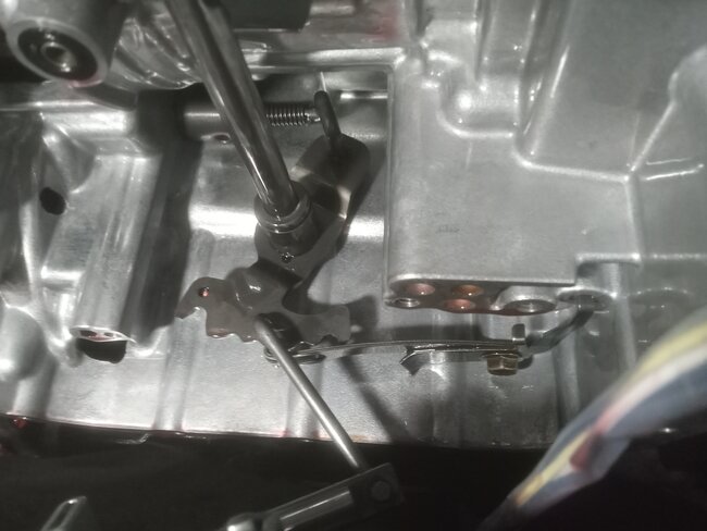

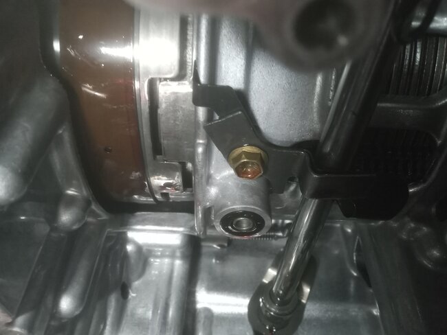

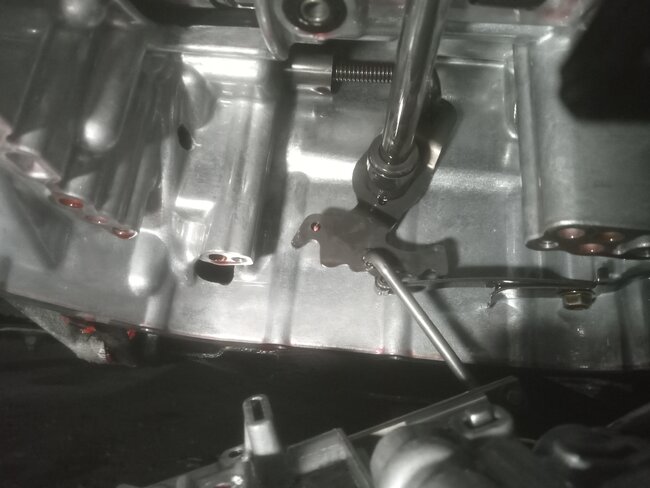

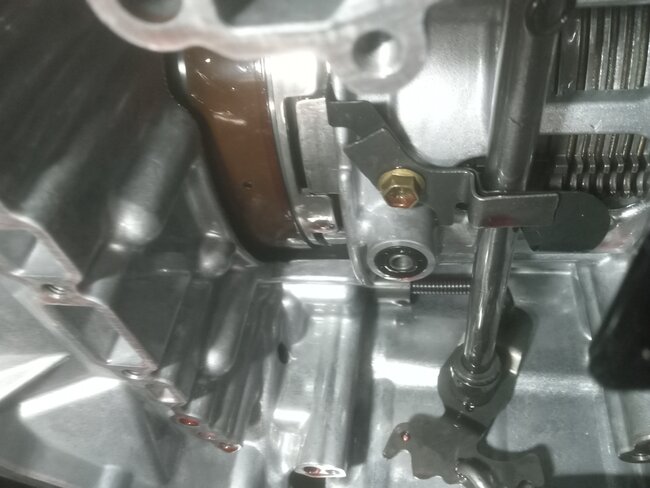

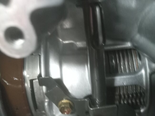

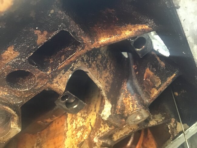

Here are pictures of the bottom of tranny when i removed the valve body, is there supposed to be a gap there? The other night I had rechecked the CV Axles to make sure they were all the way in again, I used a weighted mallet and hit it on the spindled and it didn't seem to move anymore. When I rotated it, it moved on both sides. Yes, the reverse lights come on, as well as the brake lights. It doesn't move in park, but in any other gear i can push it and it moves.
Dec 27, 2022 at 9:19 AM
  • 110,244 POSTS
That gap is normal. When you place it into gear, does anything happen? For example, does the engine speed change? If you lift the front wheels off the ground, start it, and place it in gear, will the wheels move at all?

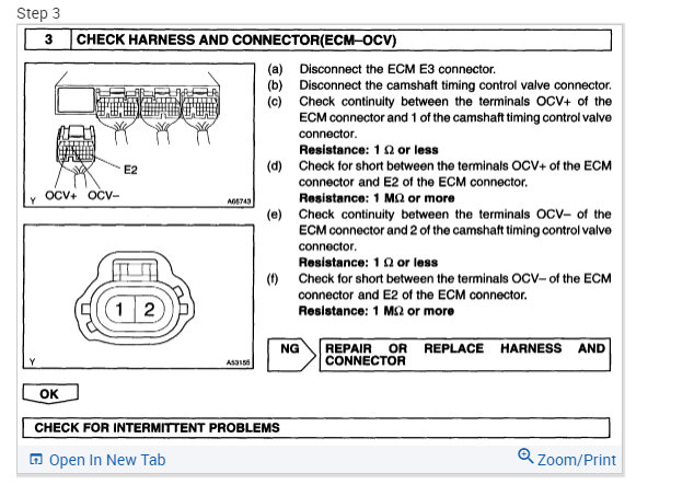

almost forgot, put scanner to it and gave me code for p1656 ocv malfunction. I erased it and came right back.

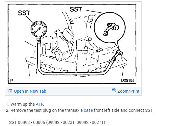

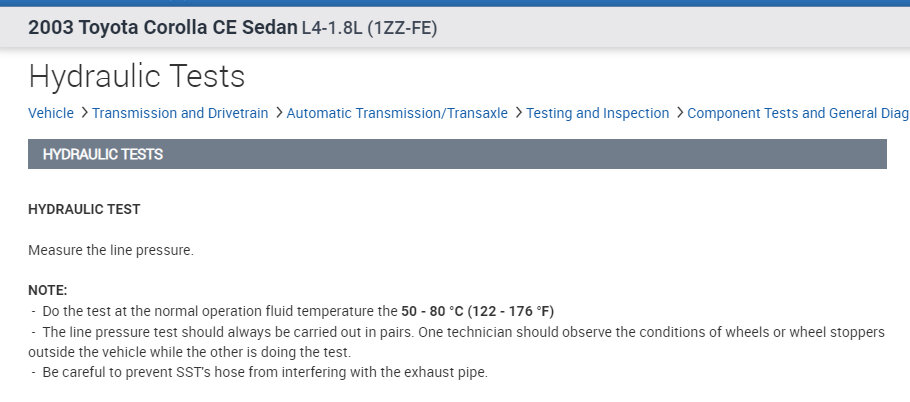

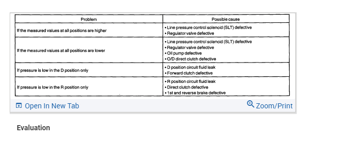

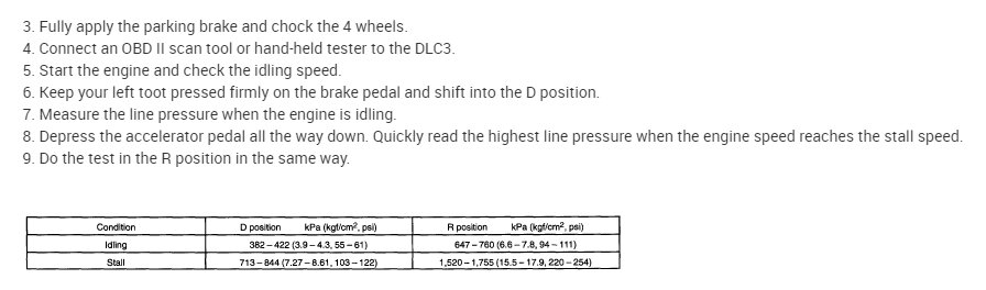

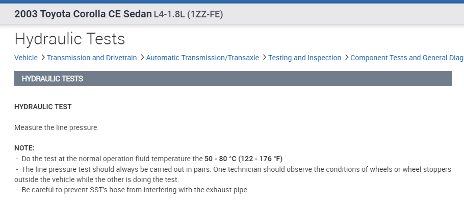

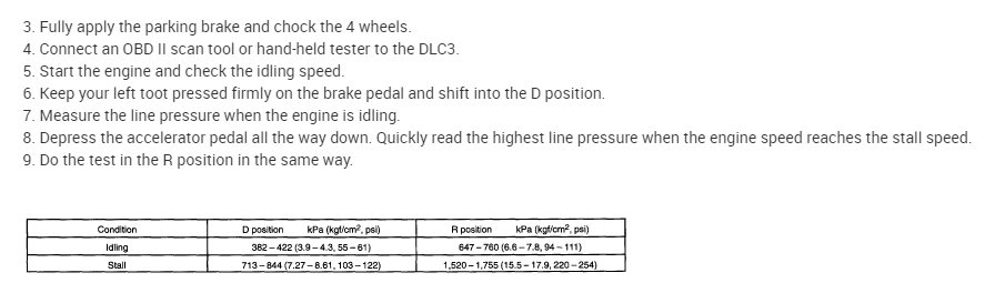

If there is no change and the transmission fluid is full, there must be an issue with line pressure. When you installed the transmission, are you certain the torque converter was fully seated in the front pump?
I attached the hydraulic test procedures for line pressure. You need a pressure gauge that is designed to reach very high pressures.
Take a look at it and let me know if you are comfortable performing them.
Also, let me know if the gear indicator indicates the correct gear selected.

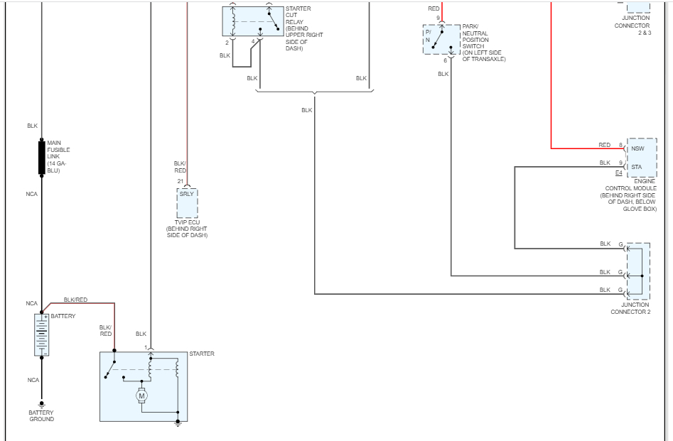

So, everything was fine up until it was towed from the back. It threw my timing off (which i was i was unaware of at the time). This was the root cause of all repairs. From engine to transmission. So, I've been told about converting. I went ahead and got another transmission from junkyard but now the NSS is not the same. Only thing that is different. Do you think it's possible to just splice the wires to the correct wire in the new harness? If so, can you provide me with 03 and 05 wiring diagram for neutral safety switch? thanks
Jan 2, 2023 at 4:04 AM

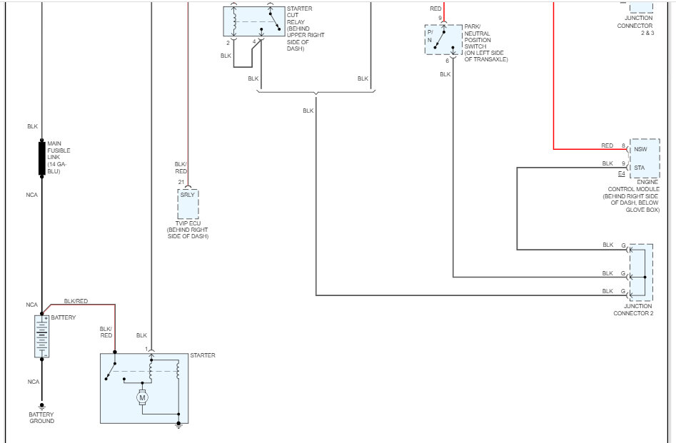

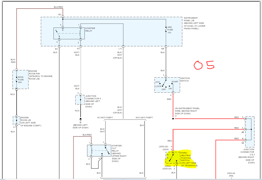

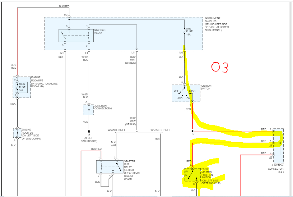

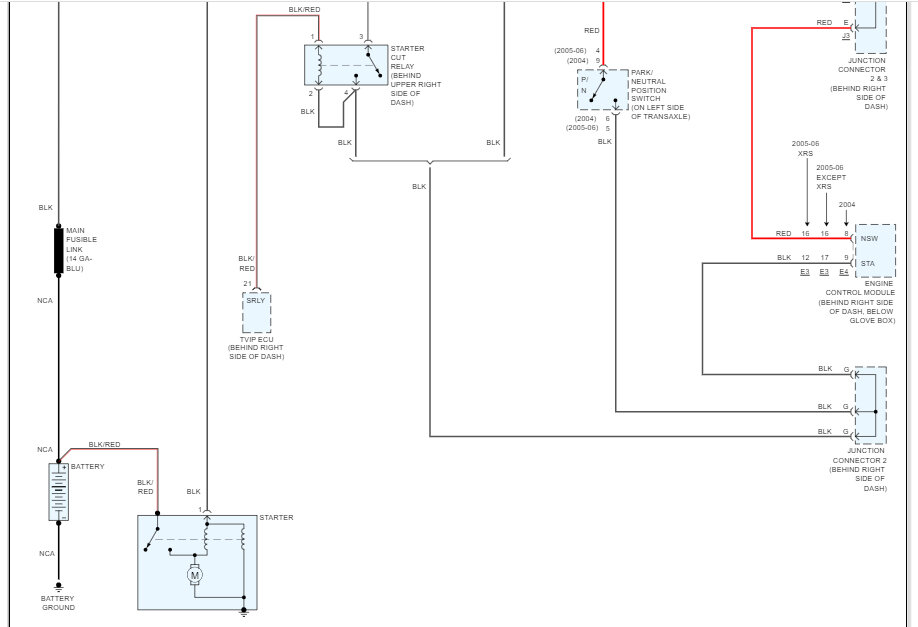

  • 110,244 POSTS

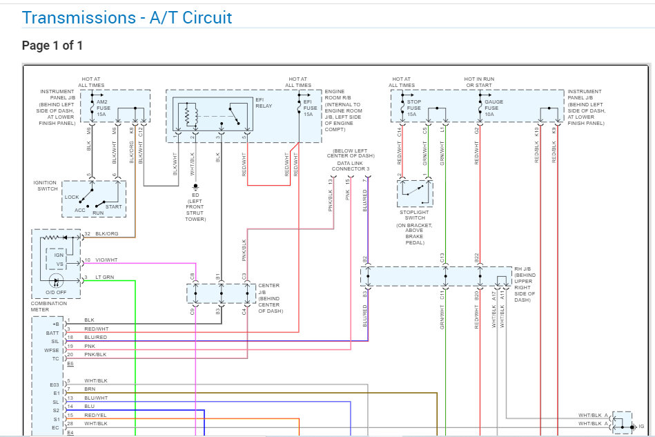

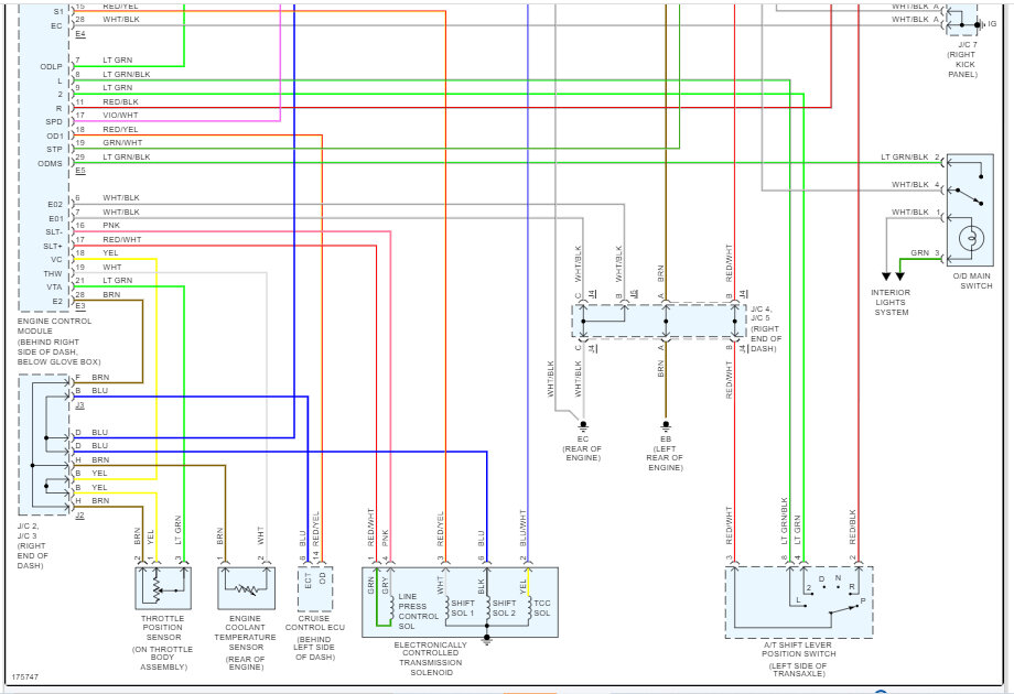

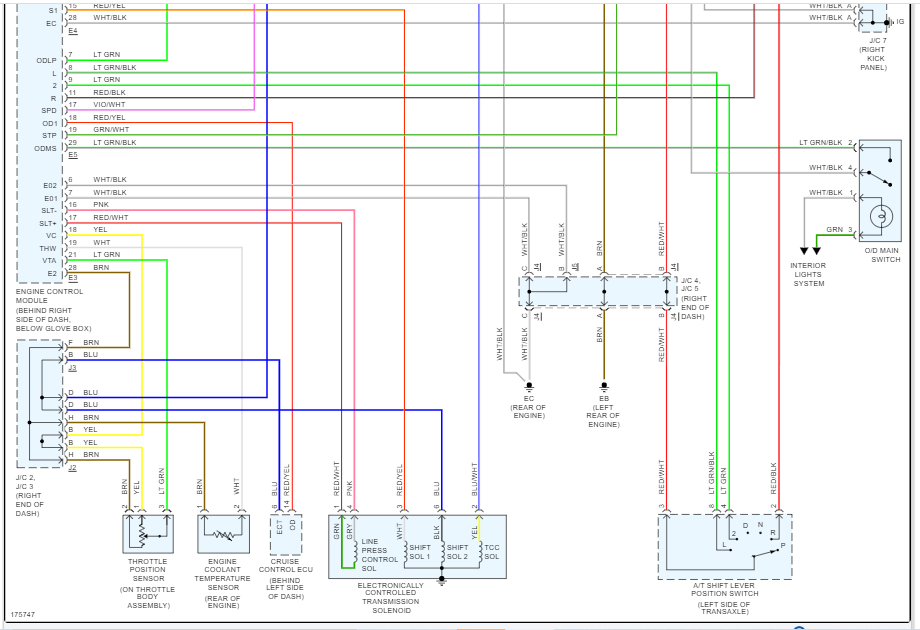

I attached schematics for both below. Pics 1 and 2 are for the 2003 and pics 3 and 4 are for the 2005.
From what I see, they are the same.
Take a look through them and let me know your thoughts.
Take care and let me know if I can help.

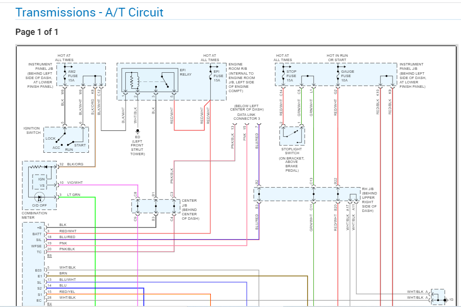

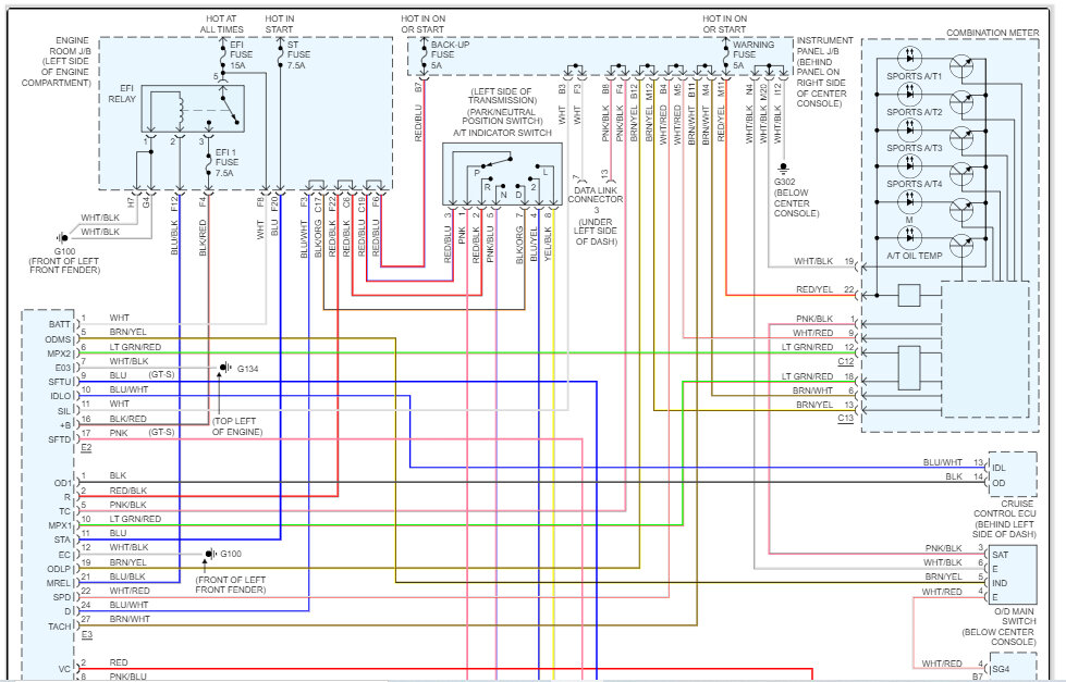

Almost forgot, but do you have the wiring diagrams from the female plug to the neutral switch? This was the only thing that was different, so i figured i could either splice the wires or switch out switch and use the one from old transmission.
Jan 8, 2023 at 3:22 PM
  • 110,244 POSTS
Wow, you are lucky you weren't killed. As far as the transmission/axle, see if you can push the vehicle with the shifter in park. That will tell you if one of the axles isn't engaged.,
I looked through two manuals and neither had the pinout. I attached the wiring schematic for the transmission. Let me know if that helps.

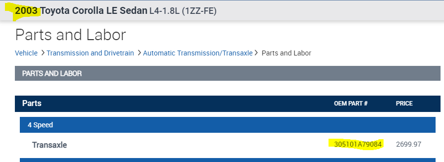

As far as the transmission, the only thing I have to cross reference is the OEM part numbers, which are different. See pics 1 and 2 below.
If you were told by a salvage yard that it would work, chances are they will be right. They have the cross-reference information needed.

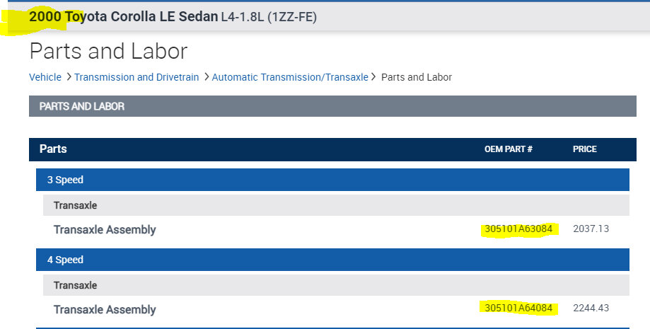

DC CRENSHAW
  • 36 POSTS
Joe,

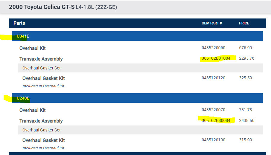

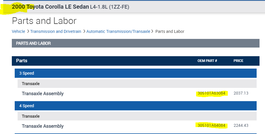

It’s not from 2000 Corolla. It’s a 2000 Toyota Celiac GTS. I was unaware that they knew which ones were compatible. I got information from an expert from Toyota Corolla forum. It’s just about installed but it’s been raining on and off all day which is frustrating especially when all that’s left is bolting the bell housing to engine and then torque bolts and wiring it all back up. I was concerned is it lining up correctly along with the wiring.
Jan 20, 2023 at 5:38 PM
  • 110,244 POSTS
I just looked up the one for the Celica. Sorry about that. It is showing a different part number as well. I attached it below.
Do you see any differences between the two? Have you been able to go any further?

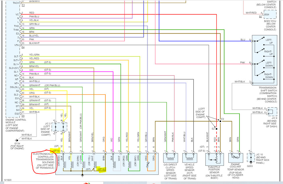

See pic below.
Jan 21, 2023 at 3:09 PM
DC CRENSHAW
  • 36 POSTS
Are you referring to the transmission? If so, yes there seems to be extra or more sensor I want to say. My old one had 3 if I’m not mistaken this one seems to be at least 2 more(extra) I have it just about bolted, it started raining past few days and I haven’t had a chance to but plan on going out in a bit. Are you able to get any wiring diagrams for the 00 Celica? Did i waste my time with this transmission?
Jan 24, 2023 at 9:51 PM
  • 110,244 POSTS
If there are more solenoids, I don't feel it will work. The computer in the vehicle that controls the transmission was designed for the transmission the vehicle came with. If there are additional solenoids, even if the connector attaches, it won't do anything with them.
I attached the wiring schematic below for a 2000 Celica GT-S. It was one page long, but I had to cut it in half to make it readable for you. I did overlap them so you can follow from one to the next.
Take a look at them and let me know your thoughts.
Jan 25, 2023 at 11:19 AM

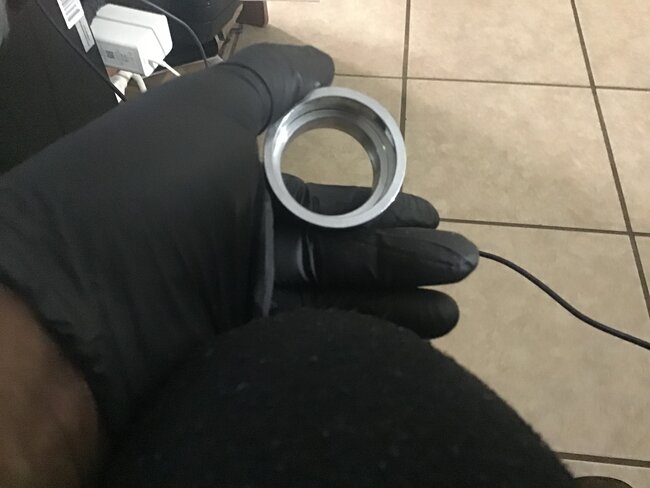

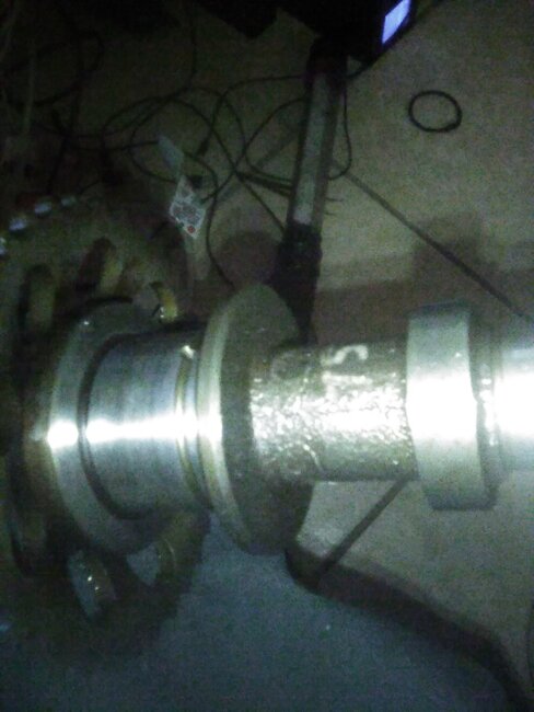

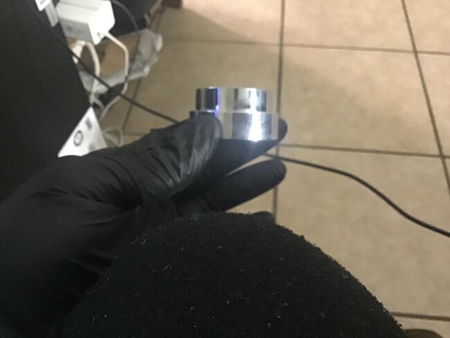

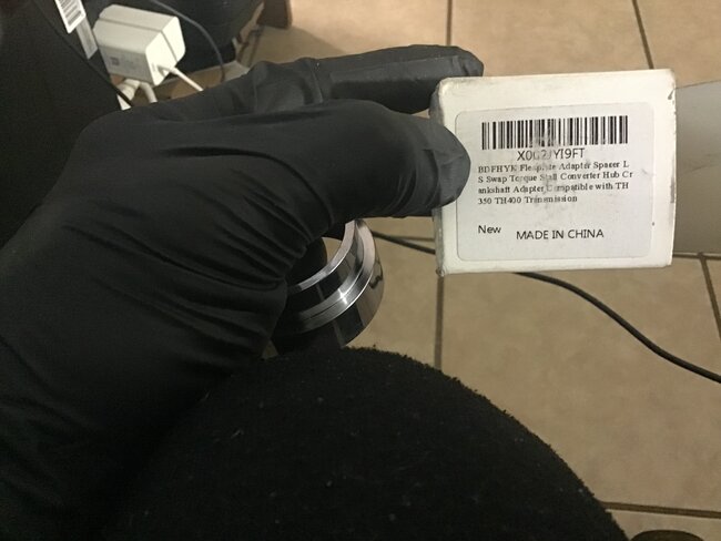

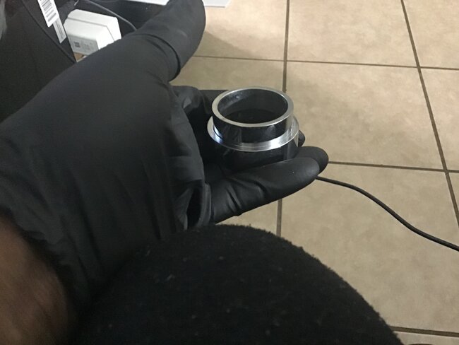

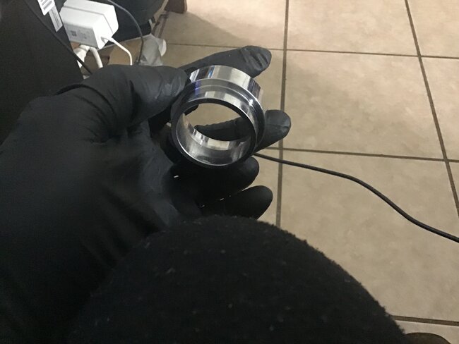

It seems like the tip doesn’t fully fit into the flex plate. But they have adapters/spacers. I bought one but not sure how or where it goes, or if it's the right one.
Feb 3, 2023 at 2:57 AM
  • 110,244 POSTS
Are you sure it is for this issue?
I read the label in pic 1. If that is what I think, it is a component for a GM vehicle transmission (older one) if a different performance flex plate is used. This is required for fitment if you are using a curved flex plate with an LS engine on a TH350, TH400, or Powerglide transmission. It isn't made for a Toyota, and I don't think any were ever made, but I could be wrong.
Who is giving you this information? They are going to drive you crazy.

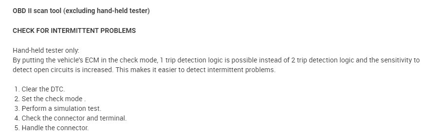

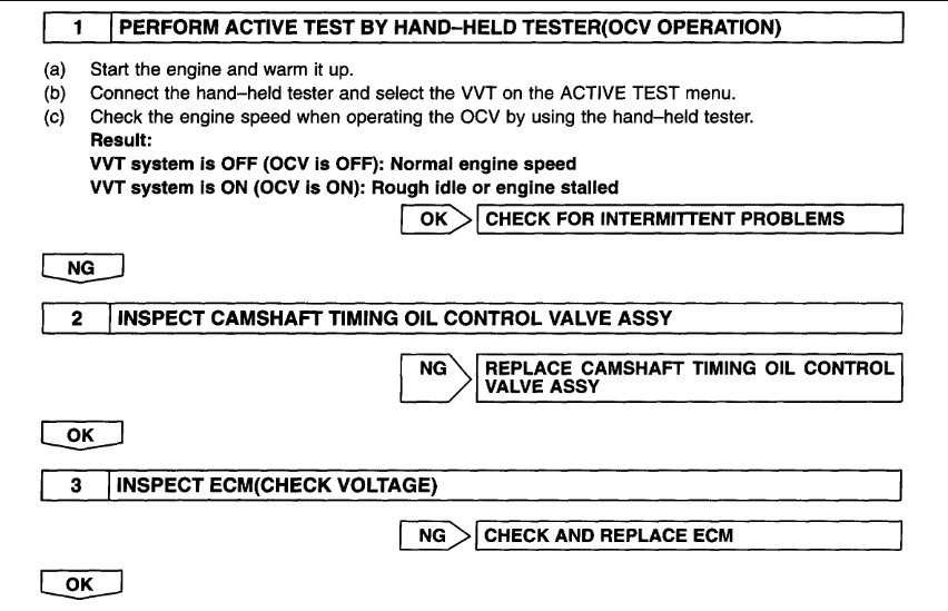

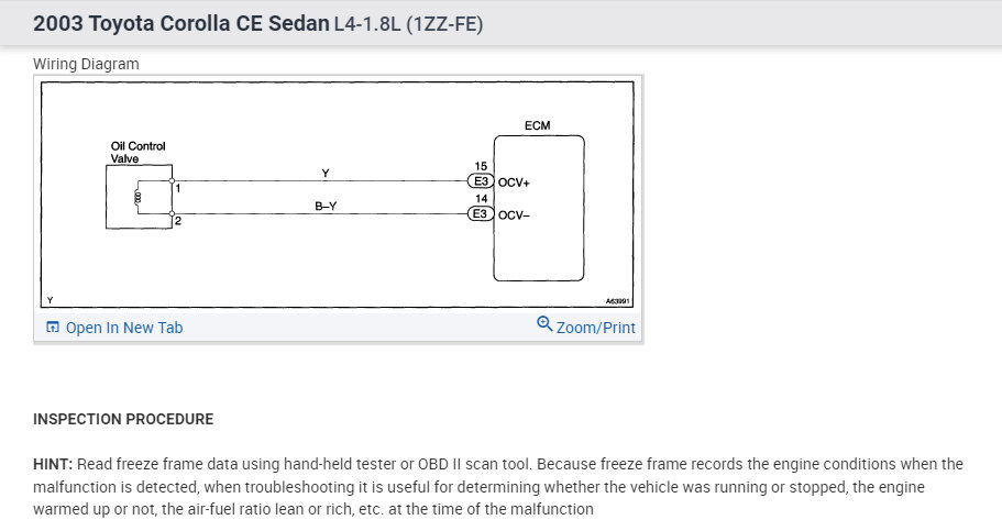

  • 110,244 POSTS

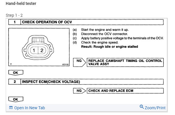

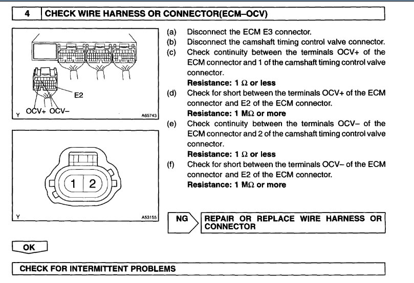

The code you have is related to the oil control valve which is likely the cause of the power loss. The variable valve timing (VVT) system controls the intake valve timing to proper timing in response to driving condition. The ECM controls OCV (Oil Control Valve) to make the intake valve timing proper, and oil pressure controlled with OCV is supplied to the VVT controller, and then, VVT controller changes relative position between the camshaft and the crankshaft. Confusing, I know.
I attached diagnostics below specific to the code. Take a look through them and let me know if they help.

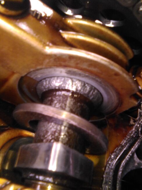

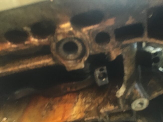

Why is it every time you fix one problem another appears! SMH!! So, my neighbor suggested i remove the valve cover because of a knocking sound that we could hear! So, I set timing just in case, removed valve cover and this is what was seen attached pictures! Now my neighbor says I should just cut it off, and it wouldn't be a big deal. If this is true, I'm okay with cutting off, but i want to know will it be a big deal down the road or would it be fine to cut off and not worry about it! But that is the piece that was causing a lot of noise!
Mar 14, 2023 at 6:10 AM
  • 110,244 POSTS
I've never seen one of those come loose. They are pressed in. Also, I don't think you would be able to cut it and I question if that would be a good idea.
Is that the only thing you found? I suspect that helps hold the bearing in place.
Mar 14, 2023 at 8:47 AM

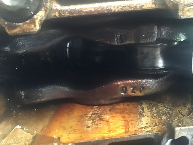

DC CRENSHAW
  • 36 POSTS
Not even with my Dremel? I think it is the end result from my a/c compressor not being fully tightened and I had the belt pop off as well as power steering pulley wheel fly off. So would you suggest replacing it, if I have a spare one.
Mar 14, 2023 at 9:17 AM

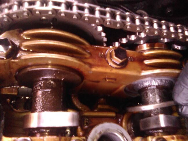

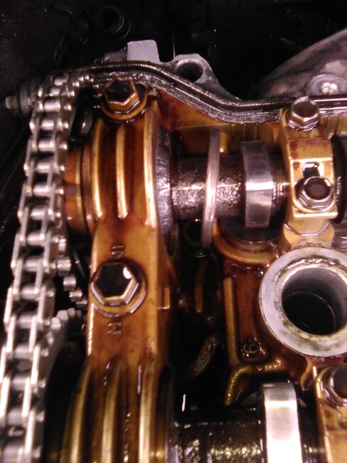

DC CRENSHAW
  • 36 POSTS
Joe,

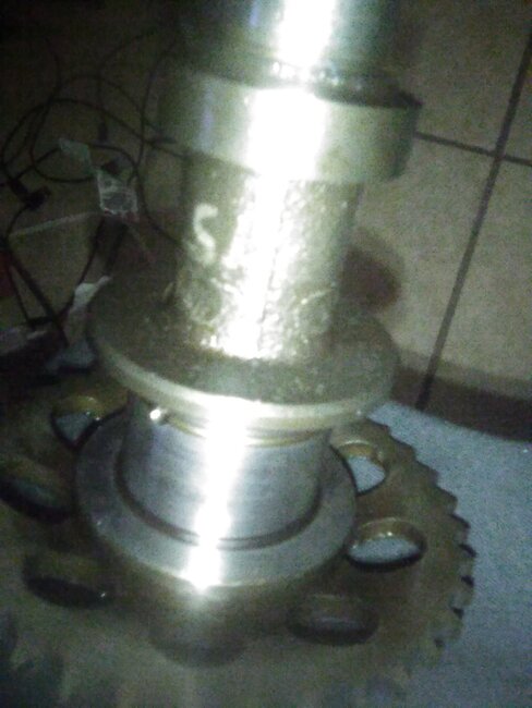

Here is what it looks like originally, pulled it off my old engine to see exactly where it came from. Question, if i remove nut, then doesn't the sprocket come off and then other pieces follow?
Mar 14, 2023 at 10:42 AM
  • 110,244 POSTS
Yes, if you remove the cam pulley bolt, the pulley will then be removable. I looked at the pics you attached. It appears that it was welded to the camshaft originally. That would be used to prevent the camshaft from traveling forward and back. It needs to be there.
Is the cam you have in the last pic (old engine) the same part? If it is and it's in good condition, I would use it.
Mar 14, 2023 at 12:35 PM

I wish i had seen your response Joe, lol it would have saved me of having to take everything back apart. should i go ahead and replace both, since I'm already replacing one of them?
Mar 14, 2023 at 5:53 PM

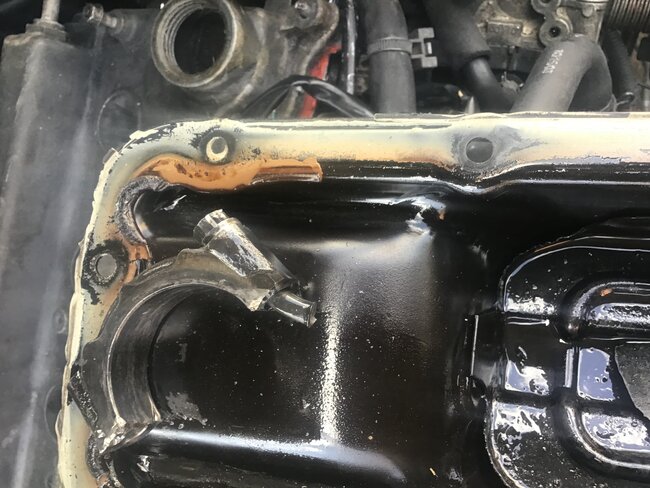

DC CRENSHAW
  • 36 POSTS
yes, the part is from old engine, they both look better than what is in the new engine.
Mar 14, 2023 at 5:57 PM
  • 110,244 POSTS
Replacing both is a good idea since one has failed. Just make sure they are the same parts.

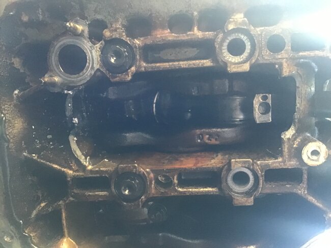

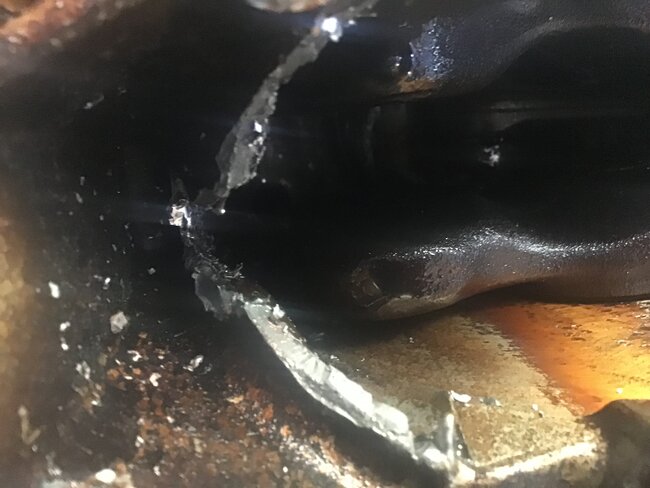

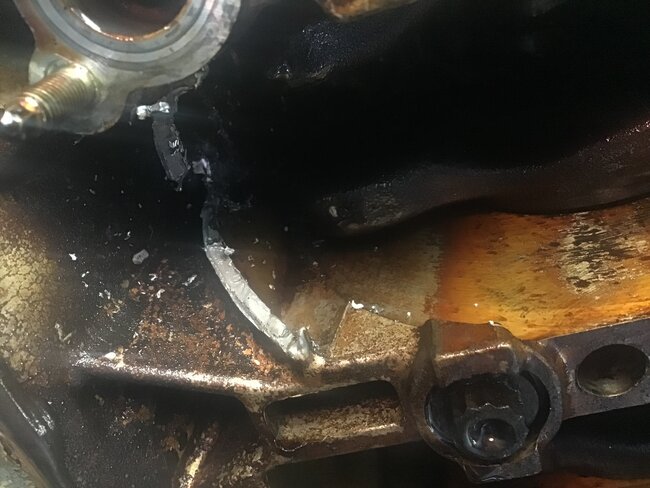

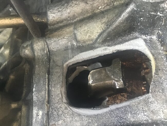

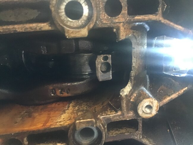

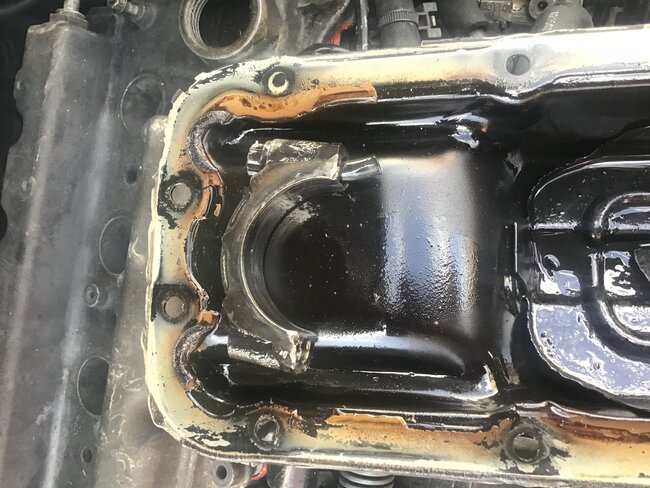

Need help! If it’s not one thing it’s another. So, I replaced them and fired it up and started up just fine but then I started hearing a noise, so I shut it off, and checked the pulleys and power steering pump to see if they were the cause of noise. As far as I could tell they weren’t. So, I fire it back up and put it in reverse and give it gas next thing I know it shuts off. I’m like great! I tried to start it, but it wouldn’t start. So, I tried to turn the crankshaft by hand, and it wouldn’t turn. I’m like great engine locked up on me. What are the causes for the engine to lock up? The sound resembled to dryer with a piece of metal in it and it bounces around with every turn. Before I replaced the camshaft, I removed the injector from 2 cylinders and spark plugs, the bolt that holds injector to head had fallen out and I assumed it fell off behind engine. Especially since I was able to put spark plugs back and everything went back together with no problems. So, I’m really unsure of what can cause the engine to lock up, can you point me in a direction of what to look for and if you have the right process for fixing the issue. I figured I have the old engine and I could take apart the engine in car and replace it with parts from old engine. The worst case is going to junkyard and getting another engine. Your help is greatly appreciated.
Mar 22, 2023 at 6:24 AM
DC CRENSHAW
  • 36 POSTS
And how can I set the timing now when I can’t even get it to rotate? I’m sure the markings on my timing chain should still be there but how can I get cylinder one to the right position?
Mar 22, 2023 at 6:26 AM
  • 110,244 POSTS
Can you turn the engine in either direction? The 1.8L is an interference engine. If the timing jumped, the noise you were hearing was a valve or valves hitting the tops of the pistons.
Let me know. Also, please confirm something for me. The only engine offered in the vehicle is a 1.8L and your original heading indicates a 2.3L.
Hang in there. If this happens and you have a different cylinder head that is good, we should be able to fix it.
Mar 22, 2023 at 11:12 AM
DC CRENSHAW
  • 36 POSTS
Joe,
So, I figured out what the noise was. So, when I first started hearing the noise, I assumed pulley or cam which is why I checked the top side, when whole time it was the bottom side, I should have been worried about. This is the sight I saw as soon as I dropped the oil pan. Truly not a happy camper. Let me go and answer your questions, when I tried to crank by hand it would barely move either way and I see why. This would explain why I was having power issues. Yes, my car is 1.8l not sure why it says 2.4l. I wish it was thou! By the end of it all, plan on making it faster by adding a turbocharger kit to it. After I can get it running and not a short-term run. So, this part of the engine is truly foreign territory for me. Once I seen the crack, I’m like great now I definitely need a new one but then I realized that crack is below line I seen. Or is the line just a crack and I need a different engine. Tell me that it’s possible to piece together the engine from the two I have! I'm not sure exactly the issue with the old engine but I think it did the same as this but not as bad, because when it happened, I was frustrated and just yanked it out and put this one in. Really frustrating because before all these issues car ran like a champ until it got towed wrong way and I was unaware at the time that it would throw my whole timing off from it. Getting ready to remove oil pan from old engine to see how bad it is. My concern is pertaining to the timing, because I wasn’t able to set it prior to removing oil pan with it being jammed. But haven’t messed with timing chain except for pulling out the plugger on backside by power steering pump.
