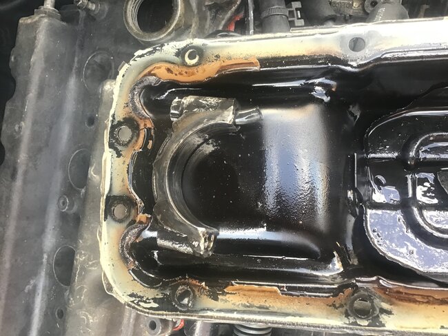

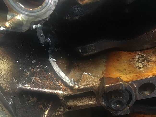

Shifting Issues?

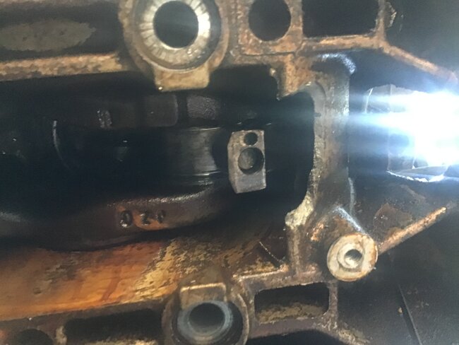

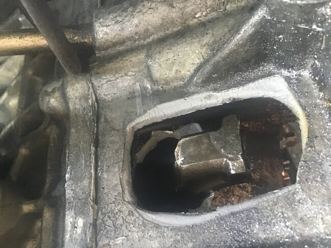

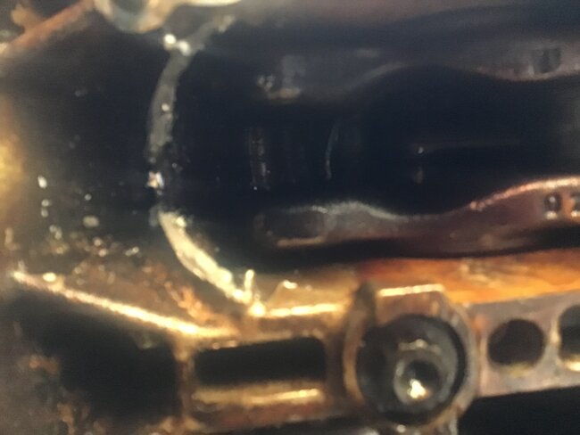

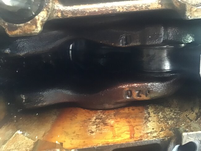

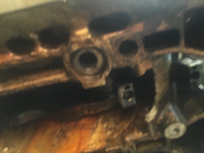

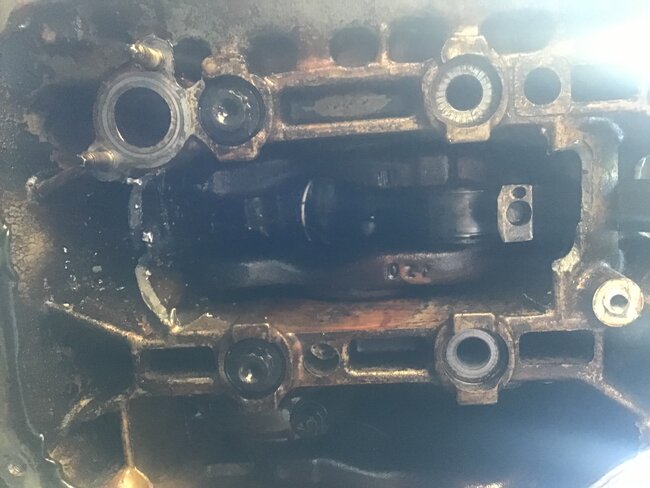

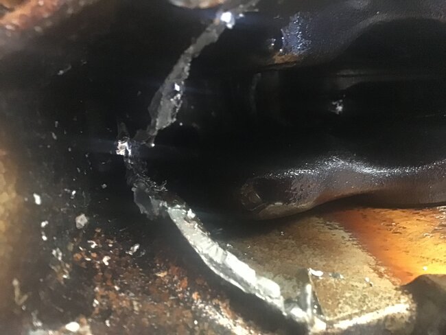

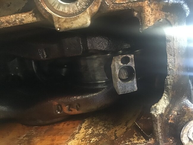

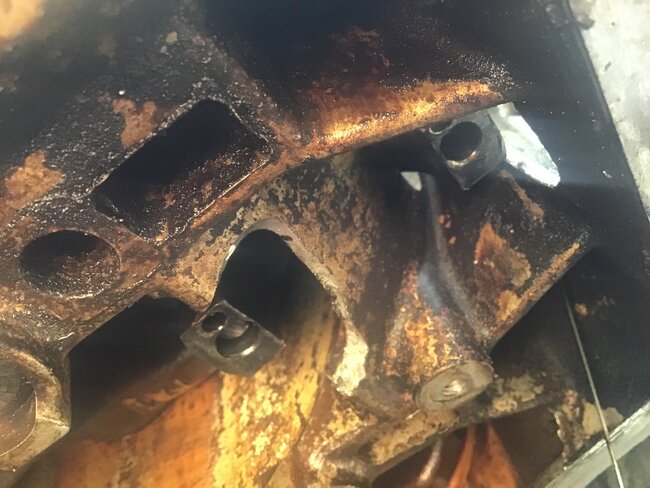

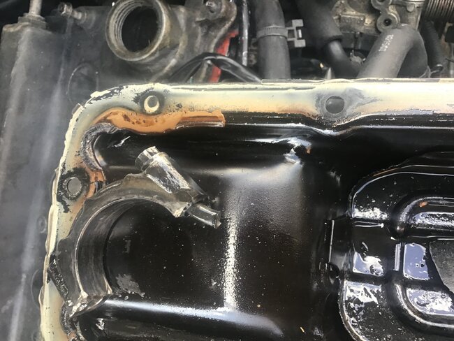

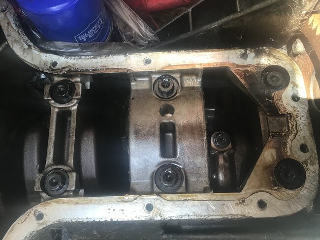

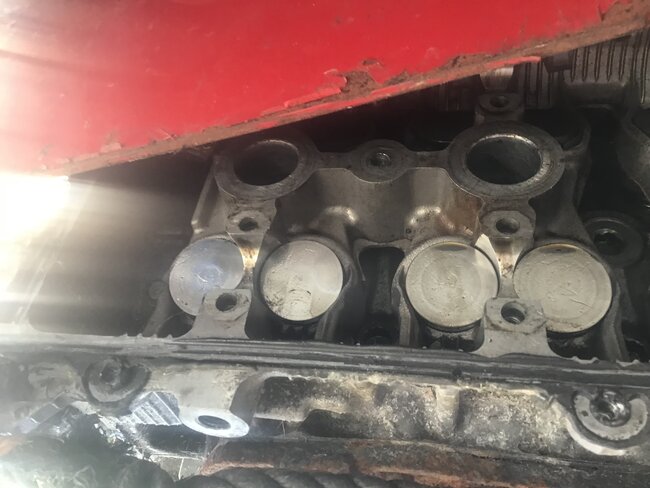

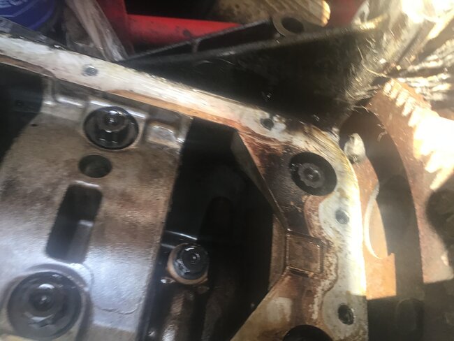

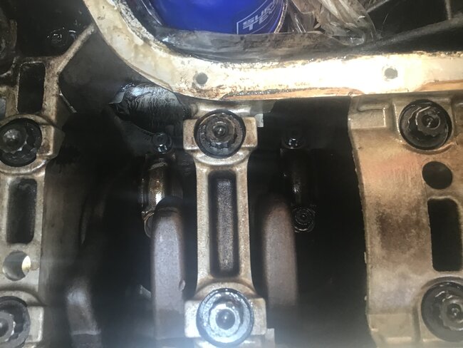

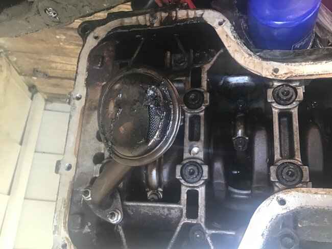

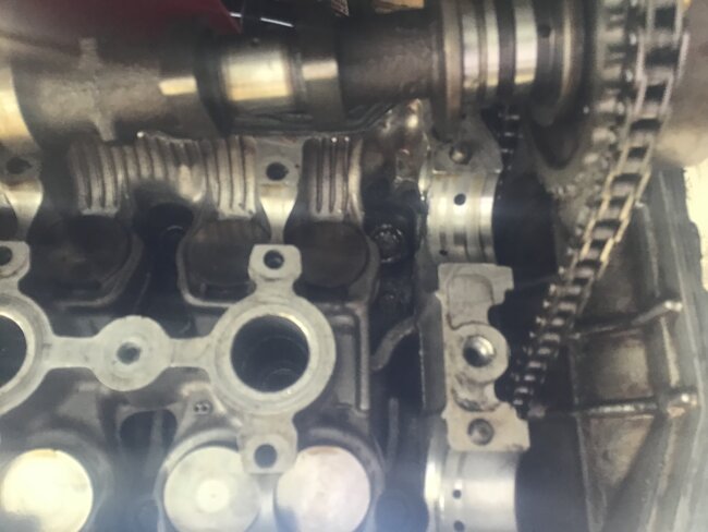

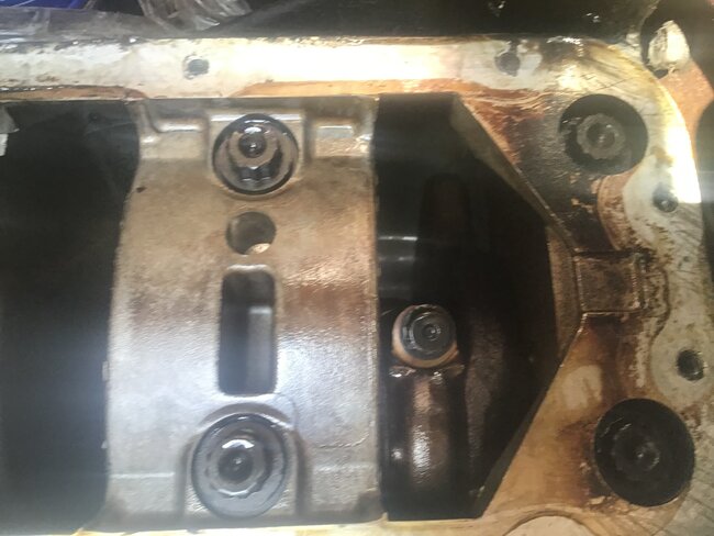

Not sure if you see the scorched oil stains, but to me it screams a problem. Correct? Or does this part of engine look like this usually?
No, it doesn't look normal. Wow, that did a lot of damage. Not being there makes it difficult, but I feel confident that it is done.
If you can, take a few pics of the other engine. Make sure you take it apart for inspection before using it.

Mar 23, 2023 at 9:51 AM

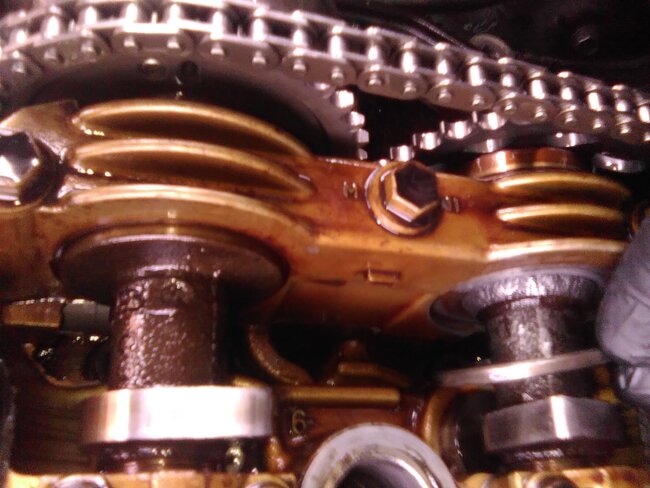

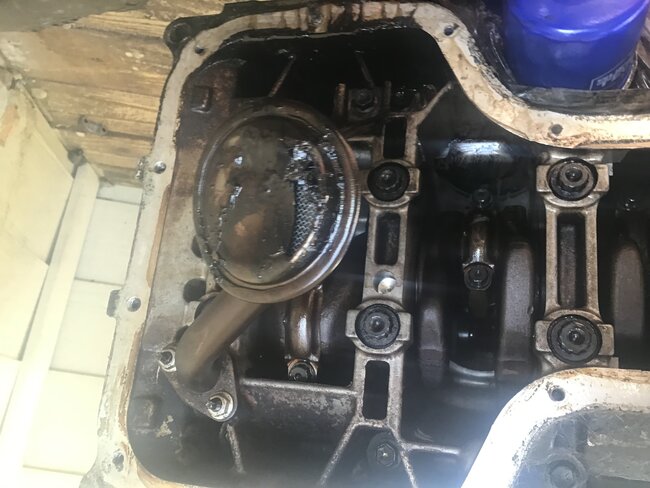

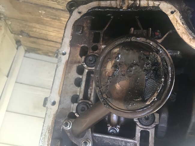

Looking at the pictures, if I had to guess, you had an oil pressure issue that led to bearing problems. Do you remember it knocking, ticking, or the oil light being on? I ask because the oil pick-up tube/screen looks corroded.
Mar 24, 2023 at 3:21 PM
Before it was towed, it ran just fine as far as I remember. The reason I swapped it out was because it locked up i believe. It would have to be an issue with the top half locking up. As you see the bottom half looks good. Do I just unbolt the bottom half as I would the top half? Then just swap out. Or do you have any suggestions on how I should proceed with repairs?

I just remembered that I believe that it had overheated once, and it must have reached a certain temperature because the car had shut off on me, I think the oil light was on and I couldn’t figure out why it was. The night it overheated and shut down I had it towed to the house, and I believe the next day it started up and ran. Then a few days later that’s when it was towed the wrong way.

Mar 28, 2023 at 7:03 AM

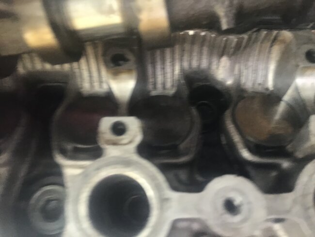

If the engine was overheated and the oil light was on, you likely will have engine bearing damage. Plus, if it got hot enough, the cylinder head could be warped or the block.
I'm afraid to tell you to try fixing it because I don't know what has been damaged. By the time we have everything checked and tested, you would have been better off replacing it with a known good engine.
Does that make sense? I wish I had a better answer, but it doesn't feel right to me. There are simply too many variables.
Let me know your thoughts. I will do what I can to help in any way. I just don't want to direct you in the wrong direction. I hope you understand.

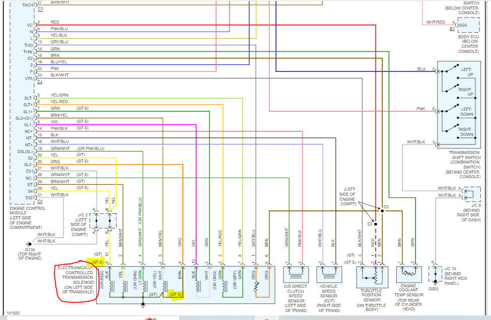

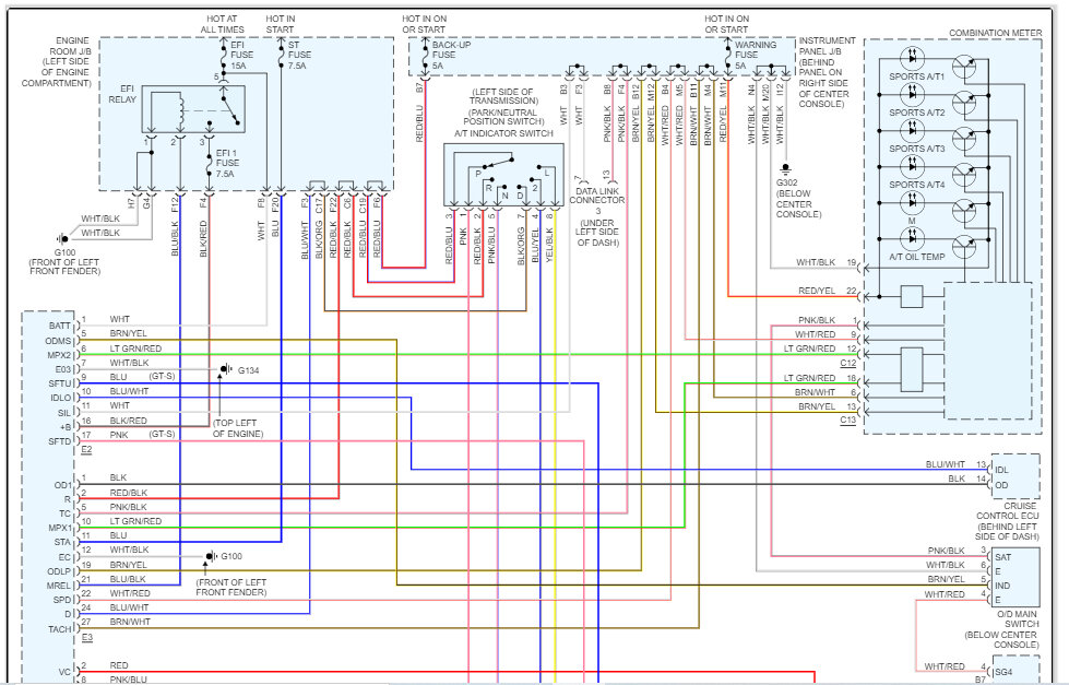

Update: finally got another engine. installed but ran into the same issue i have every time i pull it out. Having issues with getting to crank up. It turns over and sounds like it wants to but doesn't. No spark, it appears. gas is going can smell and feel relay click. what i have done in the past disconnect ign fuses under the hood and inside of the car, unplug ECM and let it sit, plug in other ECM, fuses then try to start knowing it won't. then disconnect everything plug in first ECM, fuses and then it would fire up. problem only sems to come when pulling either motor or transmission.

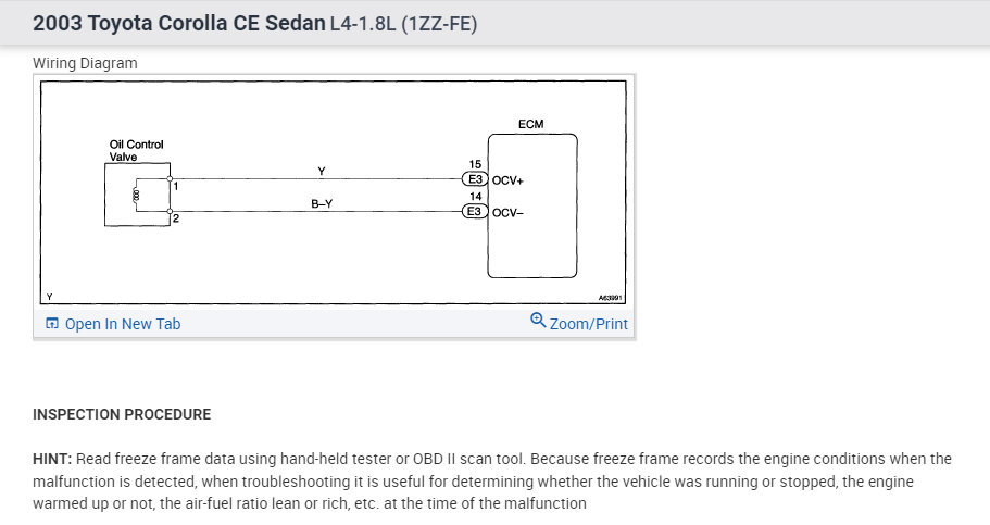

May 13, 2023 at 8:43 PM

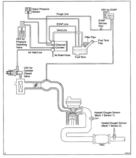

If possible, do you have a diagram for the way vacuum lines connect?
May 13, 2023 at 9:37 PM

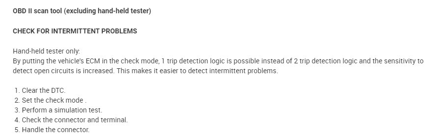

As far as vacuum schematics, I have one which I attached below. Now, the engine size is for a 1.8L which is the only one listed for this vehicle. Let me know if that is correct.
Next, if there is no spark, it won't run. Are you getting an RPM signal when cranking?
See pic below.
See pic below.

It seems like every time I pull either the engine or transmission, this is the problem each time. It's like I either miss connecting a ground wire or something. I'm trying to figure out what it is. The crankshaft sensor was new and haven't really driven all that much since replacing it. What all controls the power to the spark besides the crankshaft sensor. I get all gauges to move, temperature gauge wasn't at first then I pulled the plugs from ECM and re-plugged them and then temperature gauge worked. I was getting a slight spark, but it didn't seem to be full power for spark. This is frustrating big time. Getting ready to go check everything again. Make sure I have everything that is supposed to be grounded grounded. Change out sensors and try to start it up again. I know the battery is in need of a charge, but I use my neighbor's car to give it a jump. I just need to know where I need to concentrate on really.

So, I figured out the no-spark. One of the wires was broken. So, I cut both and just wired them together and it fired up!!
