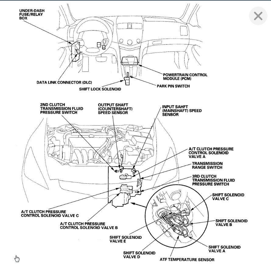

Transmission will go into gear when cold but will not move
2005 HONDA ACCORD
100,000 MILES • 2.4L • 4 CYL • 2WD • AUTOMATIC
CRZYNISS

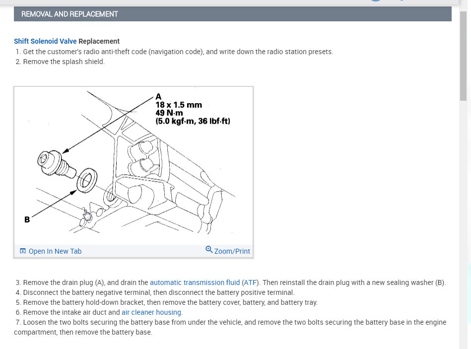

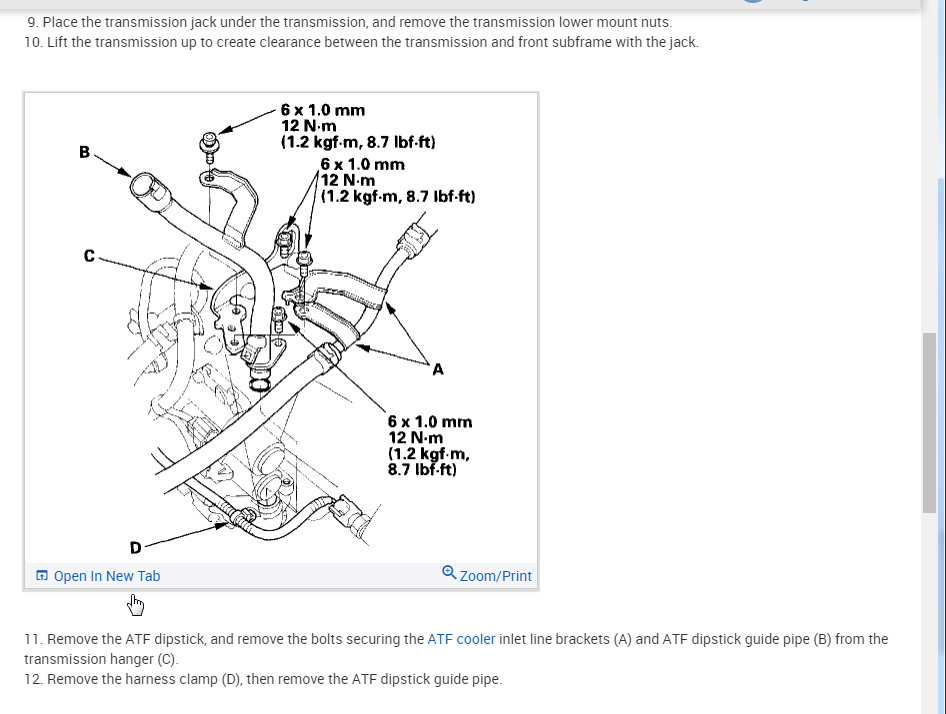

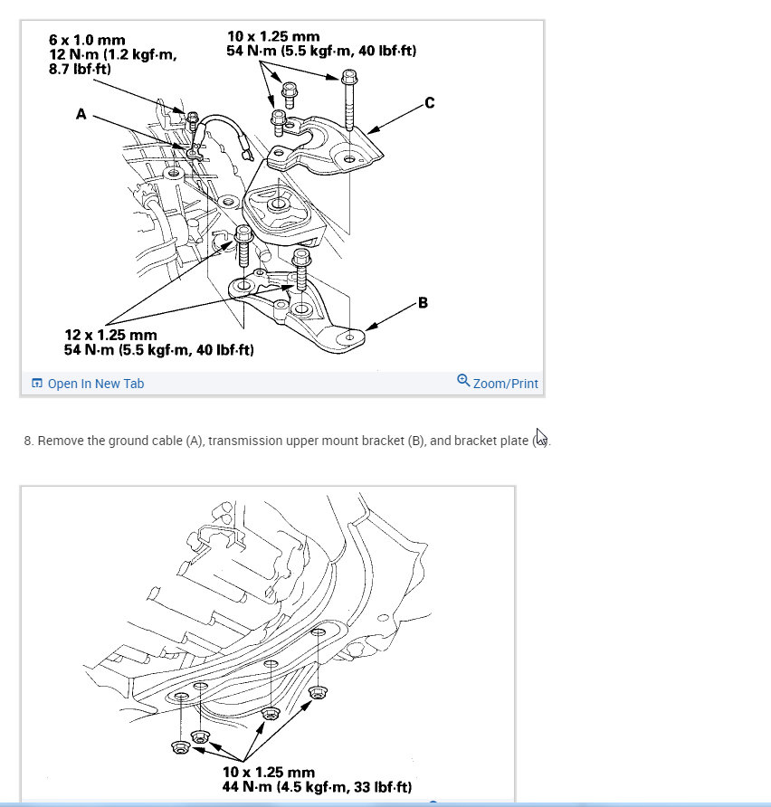

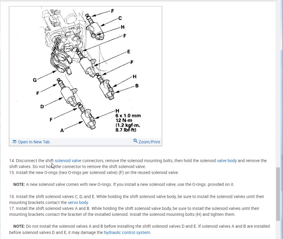

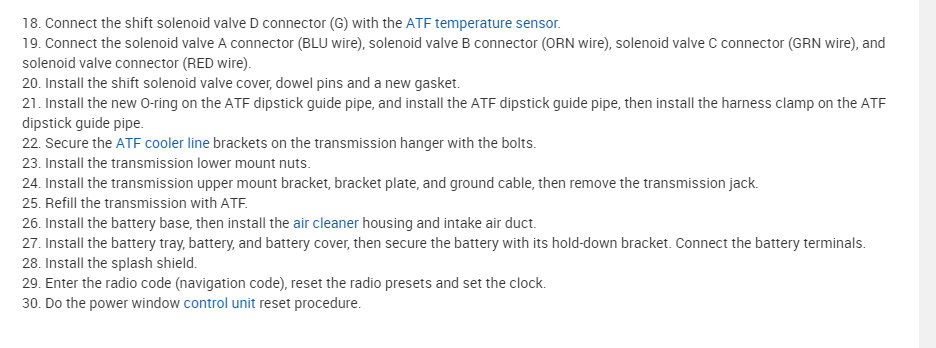

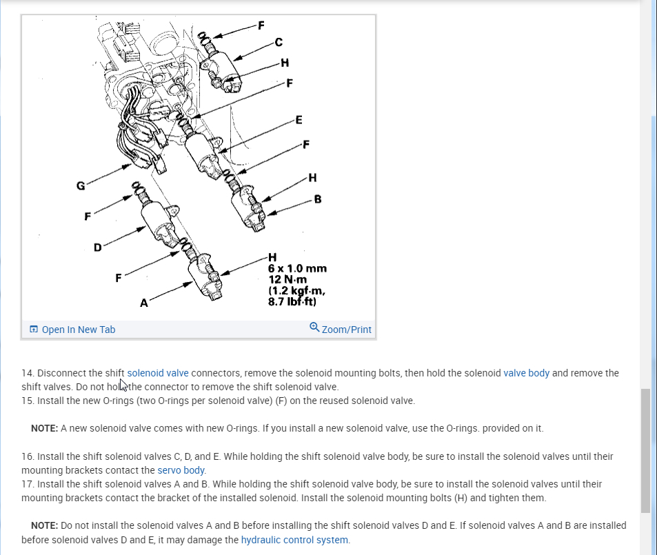

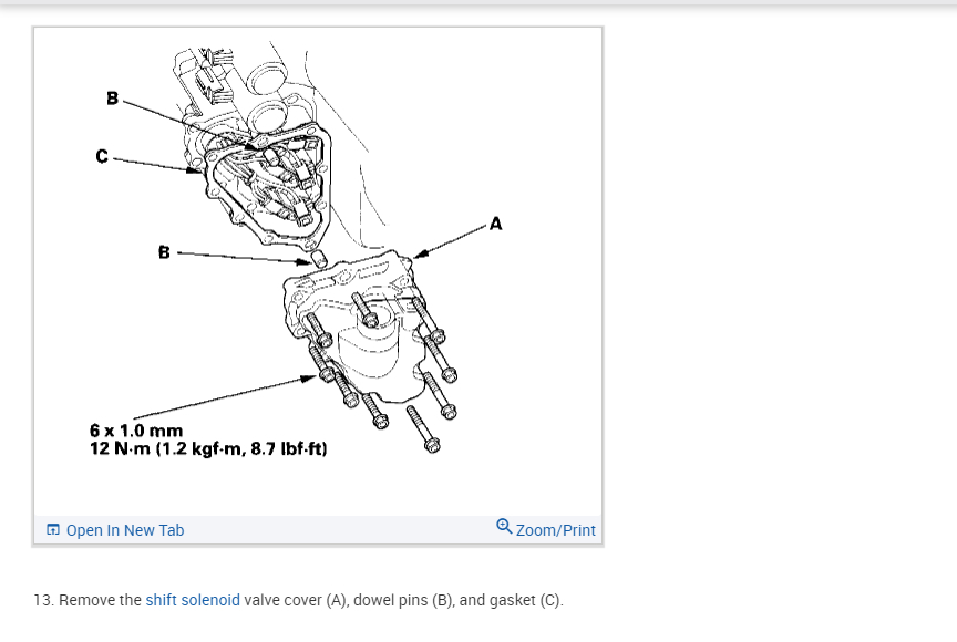

Transmission will go into gear when cold but wont move. switched out transmission still having same issue. got new shift solenoids (3 brown, 2 black ) shift solenoid A and shift solenoid B. How do we install properly to prevent issues and will this resolve the issue of car not moving? Please help with an answer, step by step instructions with pictures for the car listed above LX coupe.
Thanks
Apr 14, 2020 at 4:47 PM

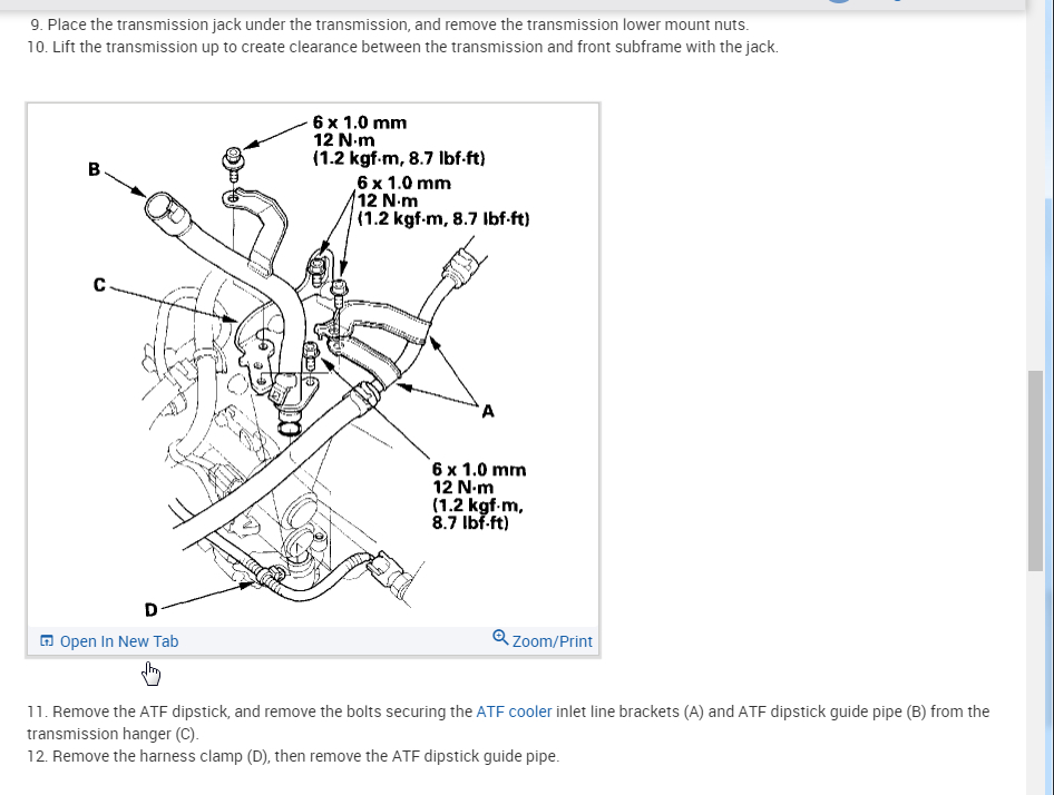

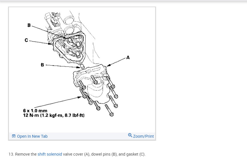

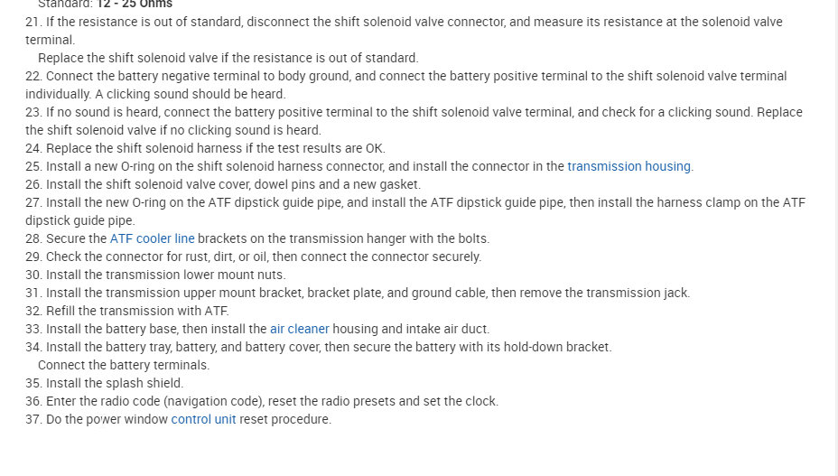

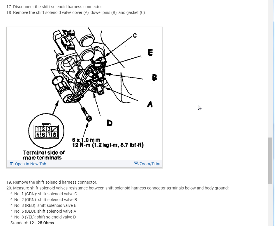

Were the shift solenoids included in the transmission that you replaced? It was then it is unlikely that they are the issue. However, if they were not then it is very possible. However, we can test them to make sure. I included the testing of the solenoids if you would like to do this as well.
Let me know if you have questions.
Apr 14, 2020 at 5:09 PM
CRZYNISS
Transmission was bought used from junkyard so new shift solenoids A and B replaced with new ones 5 total other control valves from previous transmission put on used transmission because they were just purchased before the transmission swap.
Apr 14, 2020 at 5:49 PM
Okay. I understand. I would test them before you replace them but if they were changed over then they are most likely the issue. Let us know how you make out or if you have questions when working through the documents I attached. Thanks
