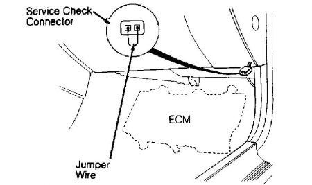

https://www.2carpros.com/forum/automotive_pictures/192750_SCS91Accord_14.jpg
Use a jumper wire to bridge the SCS and turn ignition switch ON. The D4 light should start blinking and pausing. Count the number of blinks and let me know what it is.
If the D4 lights stays on without any blinks with SCs bridged, the control unit is faulty and you can try getting a used or reman unit.

Thanks for your reply. I bridged the SCS and D4 light was off.
What can be the problem? is the TCU?

Did the Check Engine Lamp stay on or blinked when the SCS was bridged and the ignition switch turned ON?
Do you have a S mode indicator light and did it blink when the above was performed?
Sunday, January 10th, 2010 AT 12:21 AM
CHAVARES
Thanks!
The check engine light stays on but didn't blink. I don't have a S mode indicator only the D4.
Regards.
