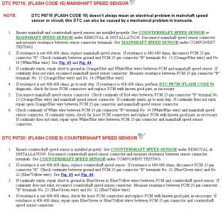

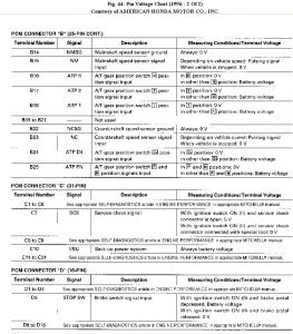

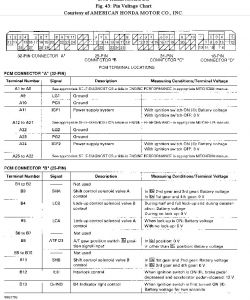

I have recently got to OBD codes: P0740 and P0715. My car makes a grinding noise when I turn left like a CV issue. However, I just had both CV axles replaces. It take a long time to shift out of 1st gear during excel. Most recently, it stopped engaging in 1st gear and appears to rev toward the red line. Can I just replace the TCC, speed sensor, and flush the tran. to eliminate the problem or do I invest 3k in a new trans? I know it has a lot of miles, but I love my accord.

Based on the grinding, I am thinking a rebuilt transmission. But here is the charts to troubleshoot it:
https://images.2carpros.com/forum/automotive_pictures/30961_honpo_1.jpg
https://images.2carpros.com/forum/automotive_pictures/30961_hon43_1.jpg
https://images.2carpros.com/forum/automotive_pictures/30961_hon44_1.jpg
