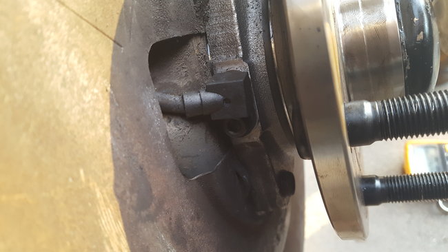

Replaced the driver side wheel hub assembly along with the wheel sensor. Light is on and off and when I stop ABS engages. It throws a C0035 code as well. Any ideas?

Mounted correctly, ohms reading on wheel sensor 10.43, mA 0.35 or as fast as I turn the hub. Does not look like any wires are messed up, it worked prior too as well. Still lost.
