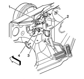

JAMES BICKERSTAFF
Brakes problem
2005 Chevy Silverado Four Wheel Drive Automatic
I park the truck in the driveway and it is on a slant,
and after the truck sets for a while the brake lights will come.
Apr 24, 2019 at 12:01 PM (Merged)
RACEFAN966
  • 5,029 POSTS
So what do you mean brake lights come on. Do you mean the lights on the dash or the rear brake lights? Get back to me so I can try to help ok.
DENNYP
  • 1,824 POSTS
If it's the rear brake lights coming on, you might have a mis-adjusted or faulty brake switch for the pedal.
DENNYP
  • 1,824 POSTS
Number 2 is the switch for the brake lights. When it happens again, pull up on the brake pedal to see if the lights go out.
