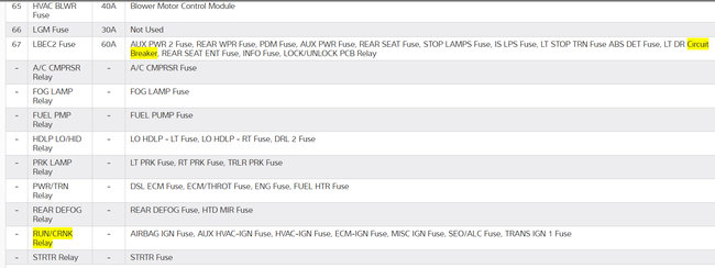

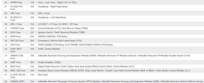

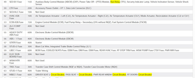

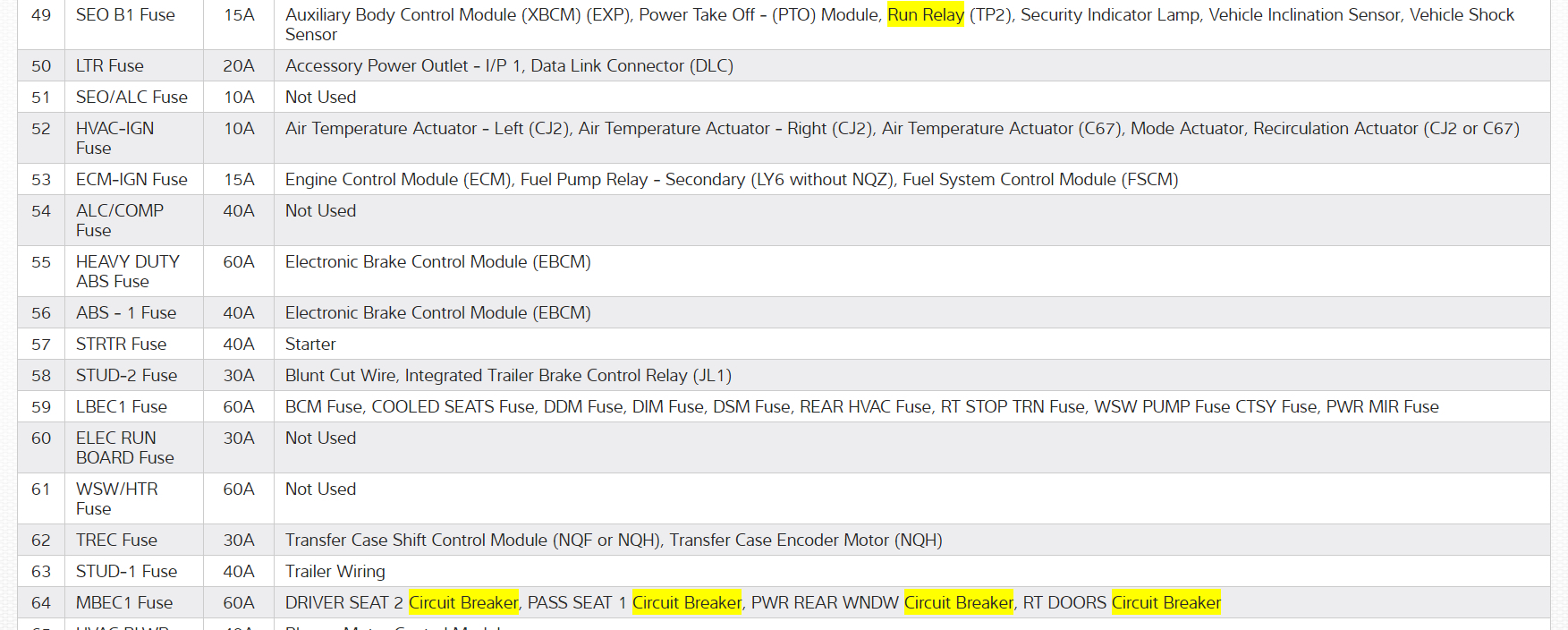

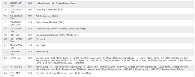

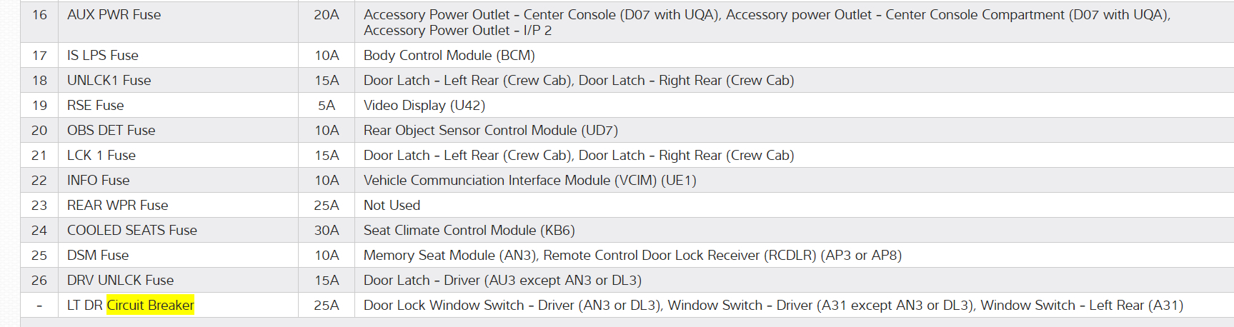

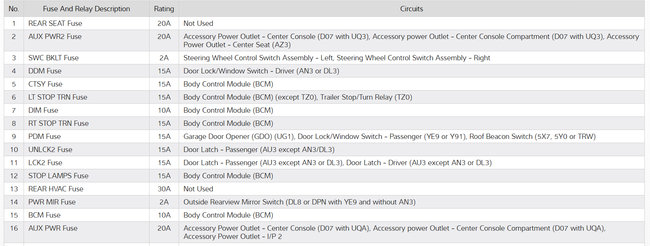

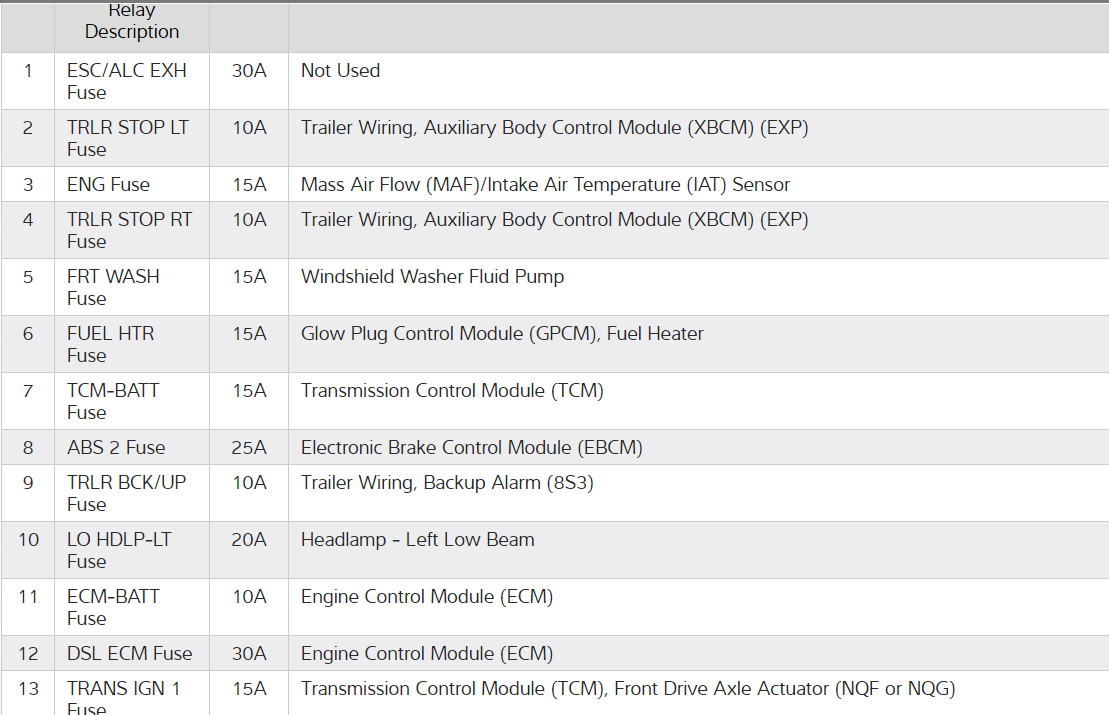

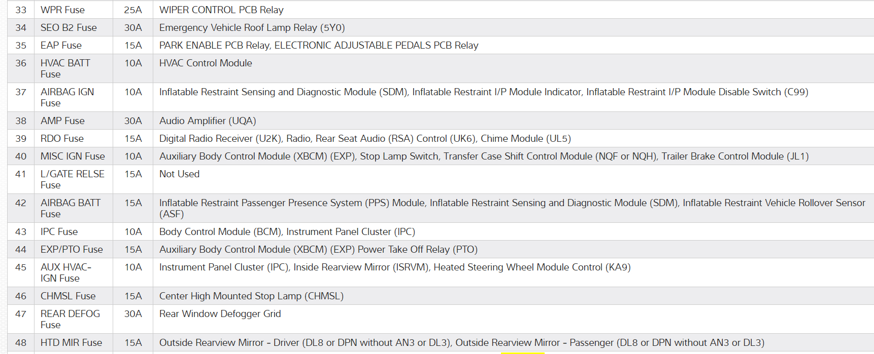

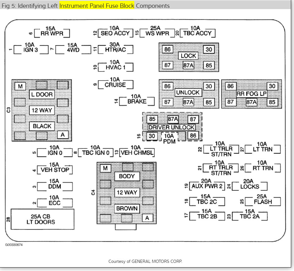

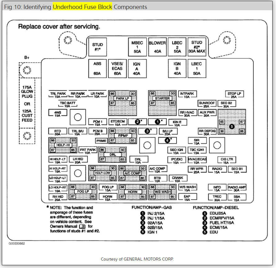

This can be an easy thing or a little more difficult first can you confirm the brake light working all of them?
Next I would confirm all the fuses are good.
These videos will help as well
https://youtu.be/Pb6nXV-iamI
and
https://youtu.be/rTtAnsOlZU4

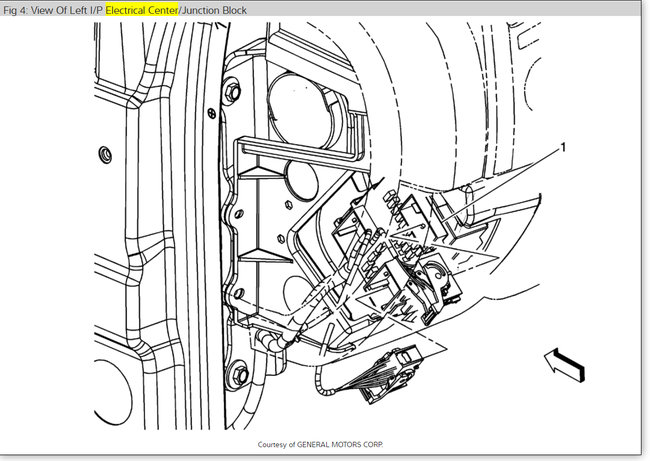

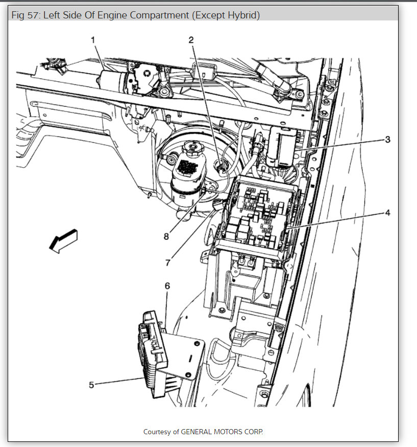

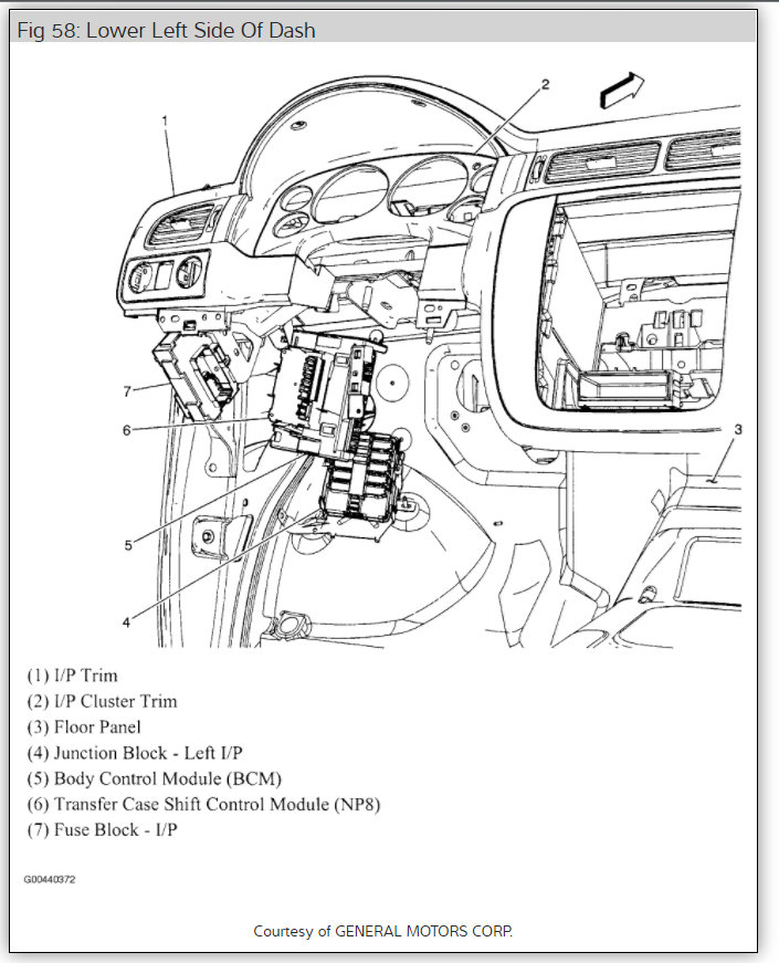

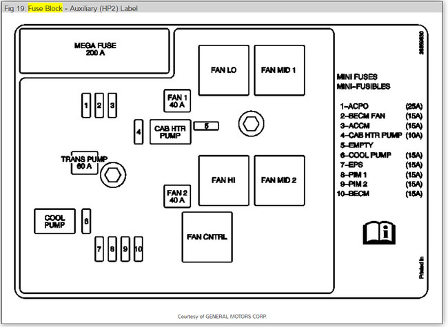

Below is the fuse panel and locations for you. Check out the diagrams (below). Please let us know what you find. We are interested to see what it is.

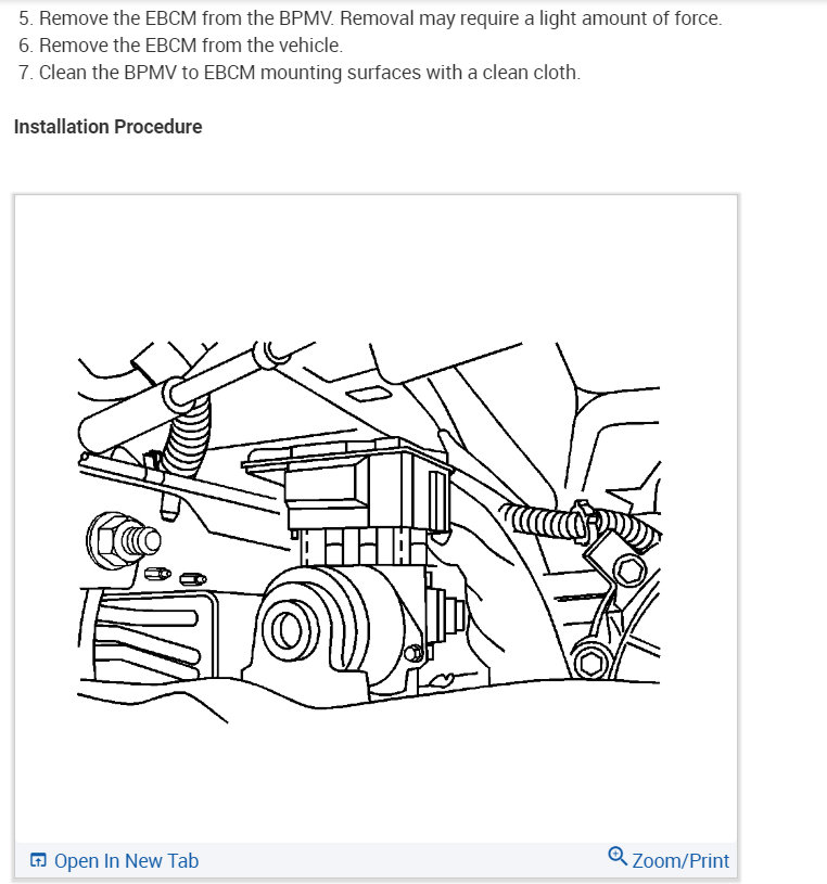

I was driving at highway speed and my dash light (ABS) light came on. About two miles later when I came to a stop my speedometer needle was bouncing from 0 to about 35 while stopped. Upon leaving the stop sign I had first and second gear but no other gears. I have scanned this vehicle and get a C0550 code telling me that I should replace the ABS speed sensor that is located on the tail housing of the transmission. I have done this twice and checked the two wires that end up at the ECU for damage. I changed the transmission oil and filter for the first time ever and found what I would consider very little deposits on the magnets. Upon test driving it again the scanner tells me that I now have code C0550 and that a common repair for this is to replace the ABS control module. I was getting the ABS code about every ten to fifteen miles that I was driving. I can cycle the key to clear it. I experimented with driving in the 3 position instead of D and I was able to go 120 miles with no issues. It appears to me that the issue is related to fourth gear and that something is not reading the speed sensors right, or I have bad sensors or modules. When the code is not present the transmission seems to function properly. If it turns out to be a ABS module, do I need to get it flashed or programmed or is it just a nut and bolt swap?
Sep 2, 2020 at 4:56 AM (Merged)
  • 55,402 POSTS

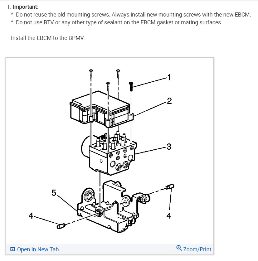

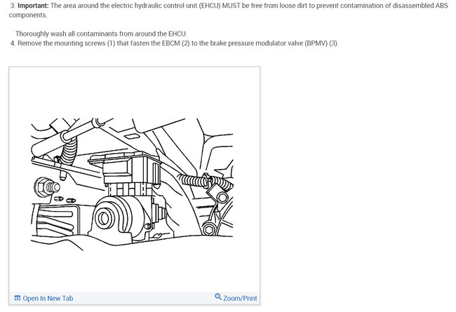

Hello Gary,
This sounds like the ABS control module is out which is common on these trucks. Here is a video of the job being done and a guide to help with any technical information needed:
https://youtu.be/lUotkKXG9dY
and
https://www.2carpros.com/articles/how-to-replace-a-abs-controller
The module should be plug and play.

GARY CLARK SR.
Ken,
I replaced the module with a factory GM module with the exact same part numbers on it. Upon start up I had an ABS light and a brake light. I drove it for a test drive about six miles and I lost all of my gauges as well as the shifting problem returned. I brought it back to the shop and was going to trouble shoot some more and when I tried to start it the truck would not even crank. I put the old module back in and ordered another new one. The second new ABS module allows me to start and drive but the ABS light is on and after a few miles the speedometer starts bouncing again and shifting becomes erratic. The code that I have now is C0569. Are the modules a programmed or learned unit? Am I looking at an ECU module? Suggestions please. The scanner seems to communicate okay with the ECU as I can trigger the ABS pump, check for four gear lock up and shifting patterns okay. Please let me know what you think. Thanks. Gary
  • 55,402 POSTS

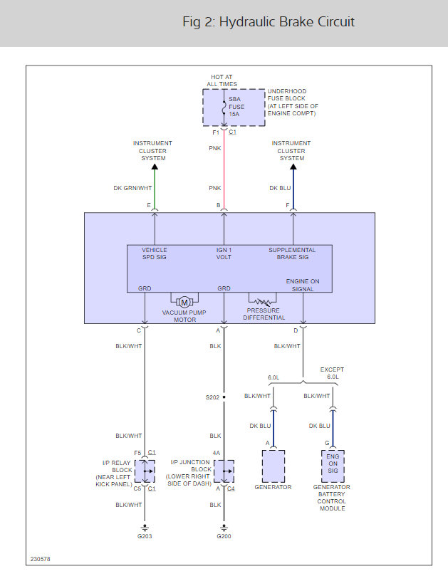

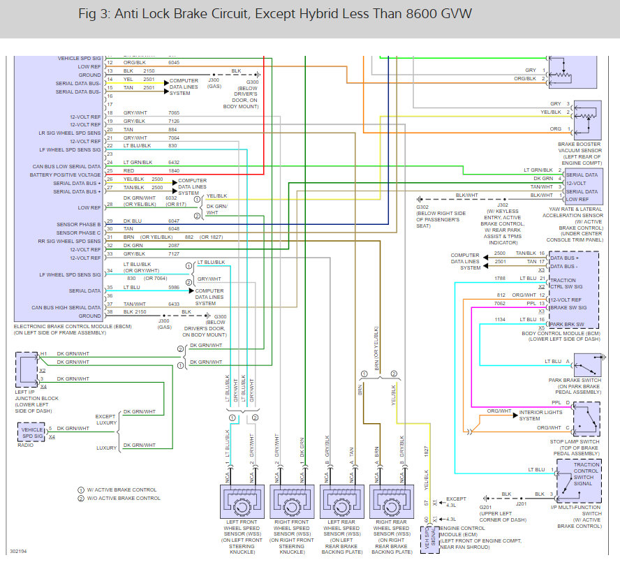

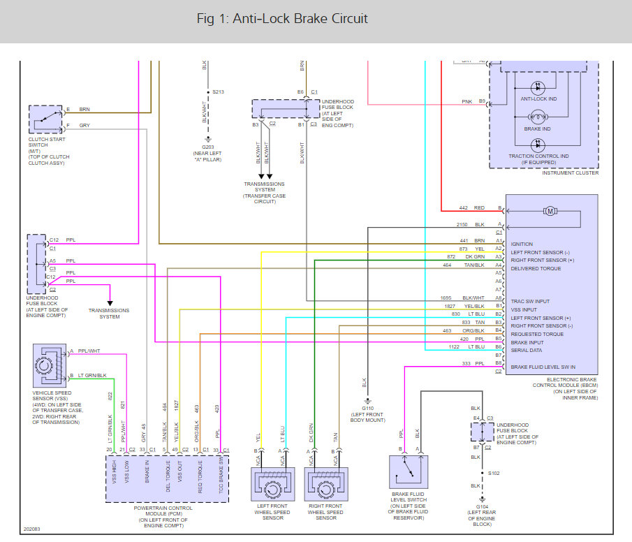

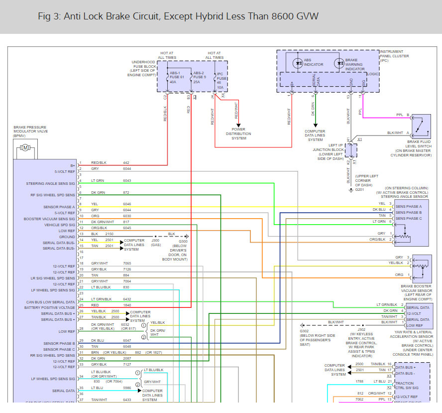

Hmm, that is weird must be glitch. With a different ABS module so many problems leads me to think either the new unit is defective or the PCM is having problems. I am not sure if the ABS module is plug and play (the last one I did was) so this can be an issue as well. At this point I would do a pin to pin wiring check to make sure we are not battling a connection issue. Here is a guide to help you with that and the ABS wiring diagrams. Make sure power and grounds are all good as well.
Check out the diagrams (below). Please run this test and get back to us.

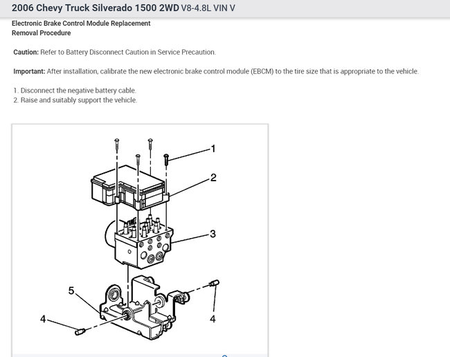

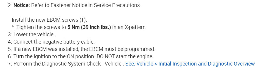

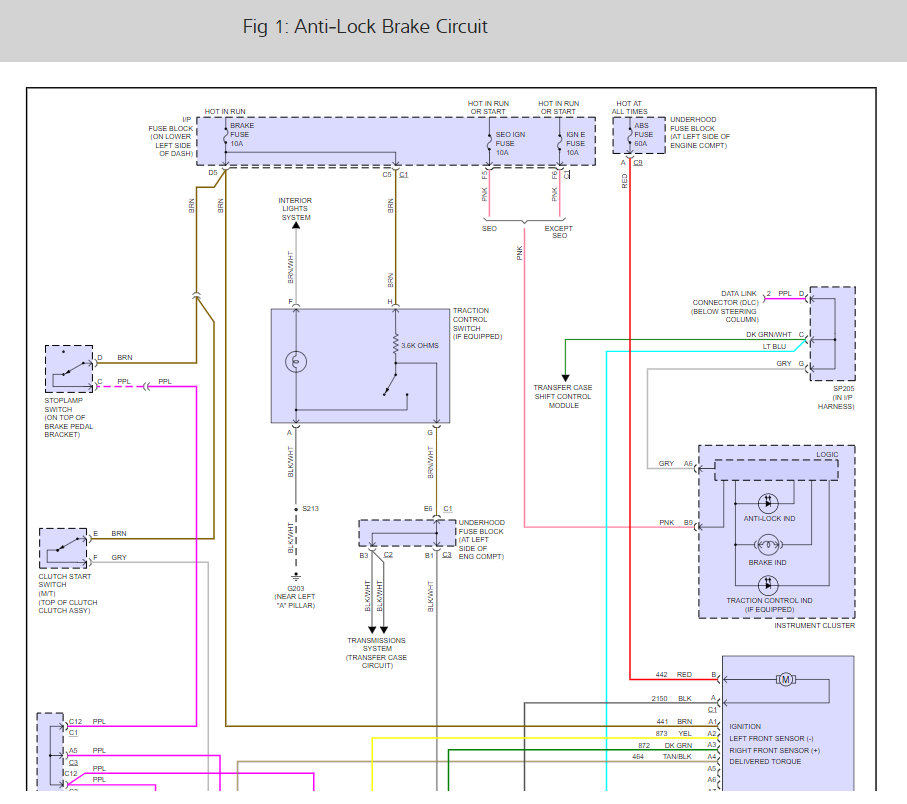

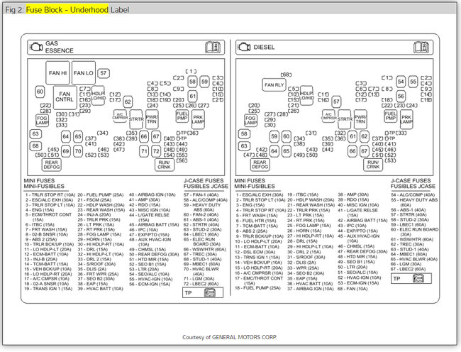

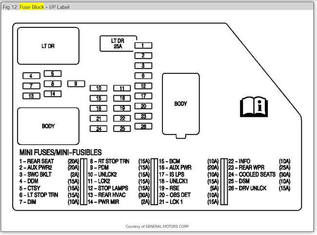

If the fluid level is okay and the fuses are good then the module must be bad. Here are videos on how to double check for codes and how to change the module out. Also, lets check the fuses before you begin.
ABS scan:
ABS Module:
And how to check a fuse:
Look at the ABS wiring diagrams to see how the system works and which fuses to check.
Here are the instructions on how to change the ABS module out (below).

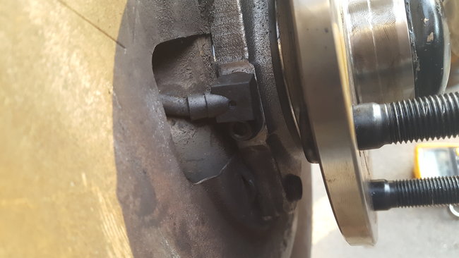

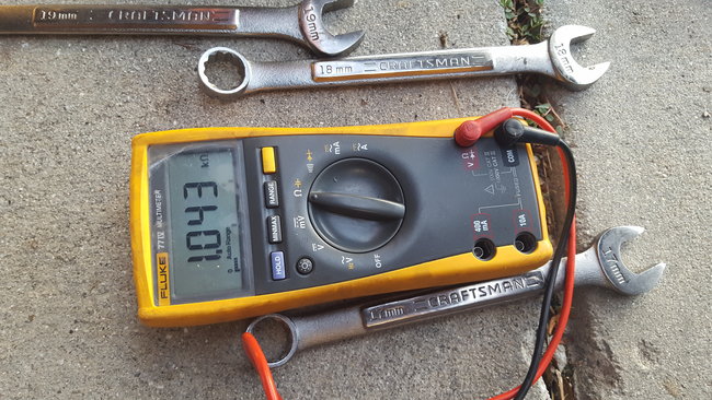

Replaced the driver side wheel hub assembly along with the wheel sensor. Light is on and off and when I stop ABS engages. It throws a C0035 code as well. Any ideas?
Sep 2, 2020 at 4:57 AM (Merged)
Good afternoon.
Do you have a scan tool to monitor the sensor activity while you are moving?
You will need to use your voltmeter to check the activity of the sensors. I attached possibilities below as well as the flow chart.
It looks like it is a sensor. you have one on each wheel. Check them and the harness carefully. Make sure none of the wheel bearings have any play.

KABAR3529
  • 8 POSTS
Thanks, I do not have a scan tool to monitor the sensor activity. I will check the other stuff later today.
Sounds like a plan. Keep me updated.
KABAR3529
  • 8 POSTS
Mounted correctly, ohms reading on wheel sensor 10.43, mA 0.35 or as fast as I turn the hub. Does not look like any wires are messed up, it worked prior too as well. Still lost.
KABAR3529
  • 8 POSTS
Ohms on the wiring harness is 17.16.

The resistance of the sensors should be 800-1100 ohms.
You need to check for ac voltage. They are voltage generators and produce ac voltage.
What happened to the scan tool that will monitor the sensors while driving?

I am sorry, I see you said you did not have a scan tool.
Check the sensors again and recheck ac voltage and ohms.
KABAR3529
  • 8 POSTS
I will have to borrow my friends tomorrow and see. I did check for ac volts it shows it giving off a reading.
Okay, that will tell us which sensor is causing the issue when the light shows.
KABAR3529
  • 8 POSTS
Volts AC was 0.008/ ohms was 1038.
KABAR3529
  • 8 POSTS
Last time I connected it was the drivers side.
Okay, then lets see if it is still showing that side when you get the scan tool. If it does, then the harness needs to be checked to see if there are any fraying or bad wiring.
