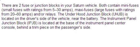

Thanks for the response. So I get that they are as easy to replace as a fuse. Now the question is where is it located? and how do I get to it?
Jul 27, 2009 at 7:03 AM
JDL
  • 16,098 POSTS
https://images.2carpros.com/forum/automotive_pictures/170934_94_saturn_1.jpg
My info showed the above locations
