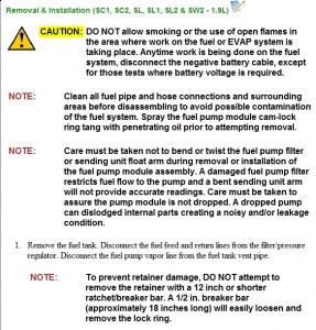

2001 Saturn SL1 fule pump replacement
2001 SATURN SL1
EEP
Engine Performance problem
2001 Saturn SL1 4 cyl Two Wheel Drive Automatic 63K miles

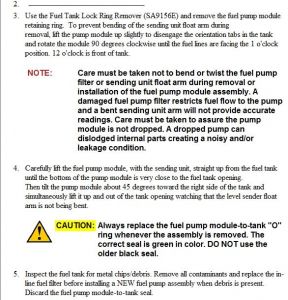

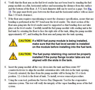

Have been getting SES light, running lean. Checked fule pump pressure and starts at 28 then drops to 25. I'm going to replace the fule pump and would like to know do I nned to drop the tank or can it be done another way.
