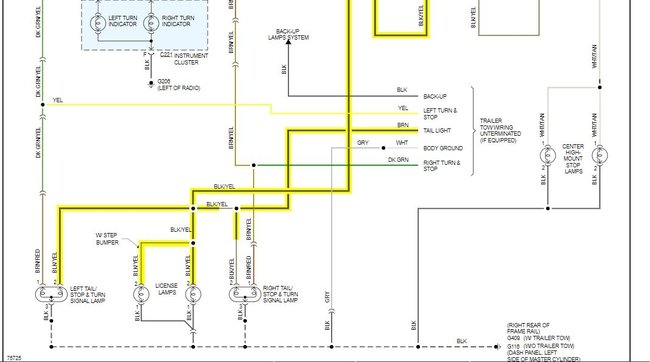

We can't figure out how to get the running lights to work on it the head lights work the blinkers and the brake lights work, but the front and back running lights don't. We have replaced the fuses and bulbs can't figure it out. Please help

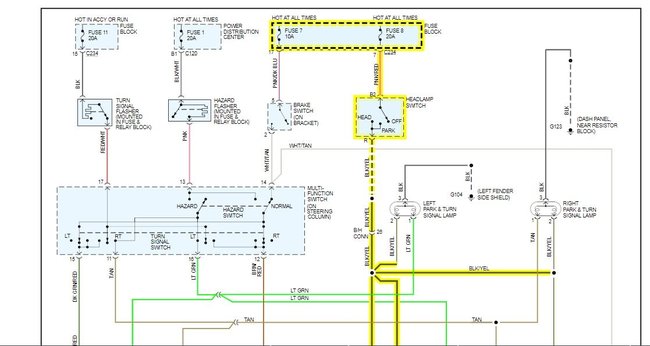

There is a fuse for the parking lights. I have attached a wiring diagram for you to view.
Check the fuse for power on both sides. This is a power test, not a visual test.
The next stop is the headlight switch. Make sure there is power to the highlighted wire to the headlight switch.

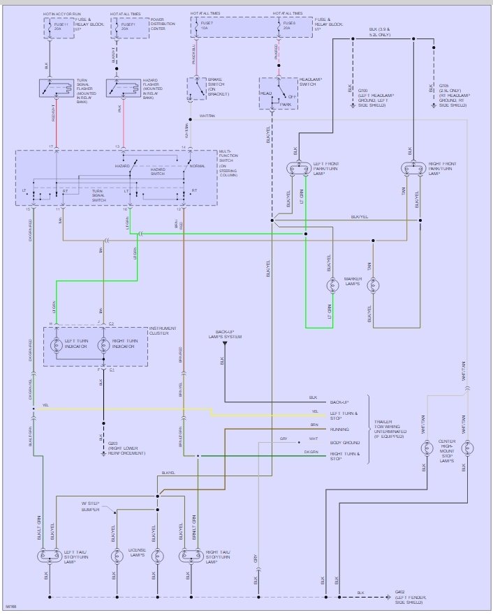

Lets start with an easy circuit and hope all the dead circuits have a common cause. Go right on the brake light switch and use a test light to check for 12 volts on one wire all the time, and 12 volts on the switched wire when you press the brake pedal. I'm going to search for a service manual to see the wire colors you're after.
Thursday, December 3rd, 2020 AT 10:12 AM (Merged)
CARADIODOC
  • 33,916 POSTS
I found the wiring diagram. The first wire you want is pink / dark blue. That must have 12 volts all the time. Next is the white / tan. That one must have 12 volts when you press the brake pedal.

It sounds like you have a headlight switch that has failed, please check all fuses first here is a wiring diagram and guide that will help with the testing. See the image below.
Please let me know what you find
