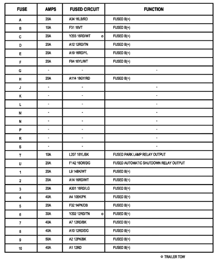

driver side brake and running lights go out when the brakes are applied (only when running lights are on). The brake light works and the running lights work, just not at the same time. The turn signal on that side also flashes at three times the normal speed. I tried replacing the socket but it is still the same.

Hi:

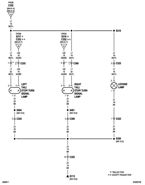

The turn signal flashing too fast indicated a burned out bulb. As far as the running lights turning off when you hit the brake light, could be a ground problem or again a bad bulb. The turn signal and brake light work from the same element within the bulb. Therefore, they both could be caused by the same problem.

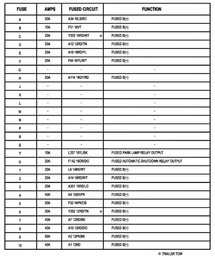

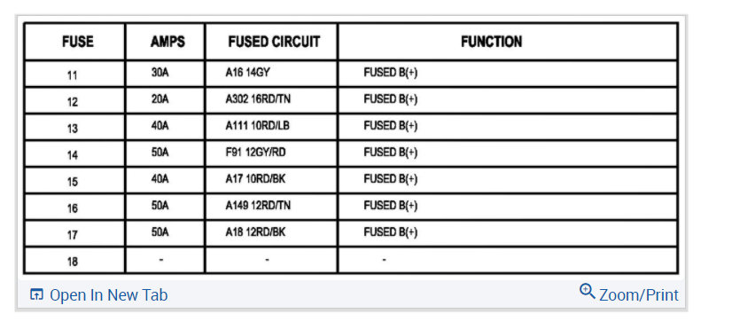

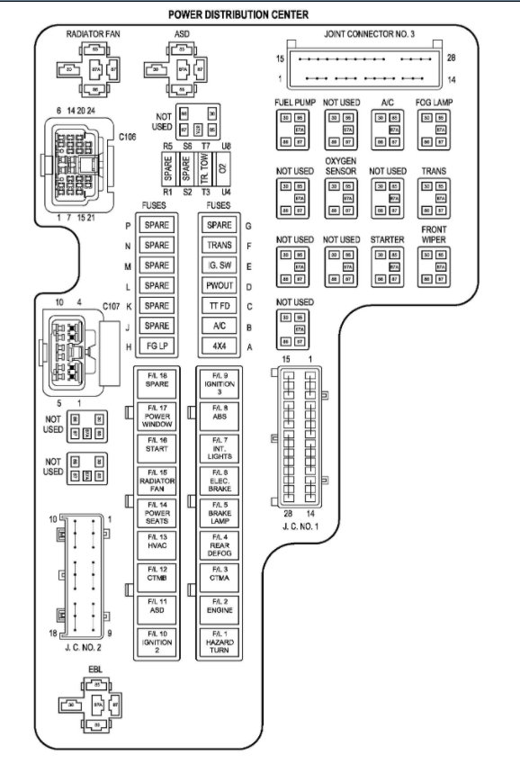

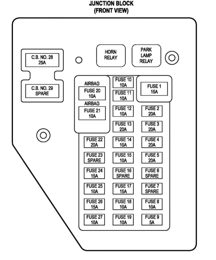

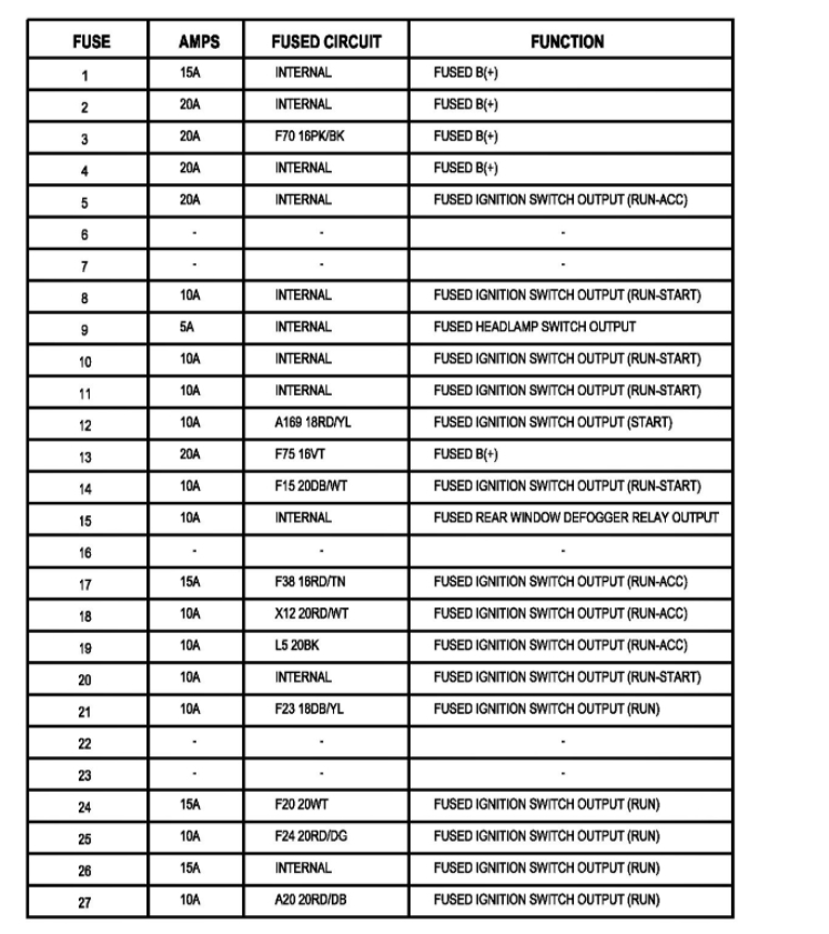

I would check the fuses first though here is a guide with the fuse location in the diagrams below.
Check out the diagrams (Below). Please let us know what you find.

Do you remember how the brake light circuit used to go through the signal switch on older models? The signal switch would let the current from the brake light switch go through, or it would switch it off, then connect one circuit to the flasher for the signal function. Well, they are doing that now with the combination flasher. The brake light circuit feeds the flasher, and it goes to the center high-mount brake light on that same circuit.
The first clue is if the high-mount brake light works. If it does, the brake light switch is okay.
The best suspect is the flasher assembly. First check that it is fully plugged in. I have seen them on Caravans where they fall out of the socket from their own weight. Next, if you can get to the wires on the back of the socket, you should find 12 volts on the white/tan wire when the brakes are applied. That is likely to be okay because the signal function comes in on a different pair of wires. You are not likely to have two bad circuits. 12 volts for the left brake/signal lamp circuit comes out on the dark green/red wire. With the bulb installed, if you find 0 volts or very low voltage on that dark green/red wire at the flasher, it most likely has an arced contact on that internal relay. To verify that, use a jumper wire to connect the white/tan wire to the dark green/red wire, and the left rear bulb should light up.
If you always have 12 volts on the dark green/red wire at the flasher, but not back by the bulb, there is one splice in that wire if the truck came with the trailer tow package. Splices are good places to find breaks caused by corrosion. Check for 12 volts at the trailer connector. That again is the dark green/red wire.
Since you found the truck has an add-on trailer harness, there is a much better suspect. Way too many people use Scotch-Lok connectors to splice the wires. Those do not seal out moisture, and corroded wires can be expected. Find where that wire is spliced in, then wiggle it while watching the bulb. If the bulb flickers or gets bright, you will need to cut the dark green/red wire back a long way until you find shiny copper, then solder in a new piece. Seal it with heat-shrink tubing that has hot-melt glue inside. That will seal out moisture. Do not be stingy with the new wire. Solder will not adhere to copper that is corroded. It will look dull brown. Even if you shine it up with sandpaper, it will crumble in the future, and you will have the same problem. Moisture has gotten inside the insulation by the break created by the splice connector. That moisture, and corrosion, will travel a long way inside the insulation, so you might have to cut out a foot or two of the old wire.

STEVEW661
tail lites and blinker lites suddenly quit working. I have checked the bulbs and the fuse (position #19) in the fuse block and all seems to be ok. What do you suggest next?
Dec 3, 2020 at 2:08 AM (Merged)
STEVEW661
Well, I have found the answer to my problem. The owner's manual talks about the fuse board located on the side of the dash board. The manual does not mention the "other fuse panel" located under the hood. I removed the lid from the fuse block under the hood and found that I did indeed have two blown 20 amp fuses. I replaced the fuses and presto, the tail lights, blinkers and emergency flashers are again working. Figured I just saved myself a couple hundred bucks, by not having to take it to the dealer and have them replace the 2 $5.00 fuses and charge me an arm and a leg!!!
