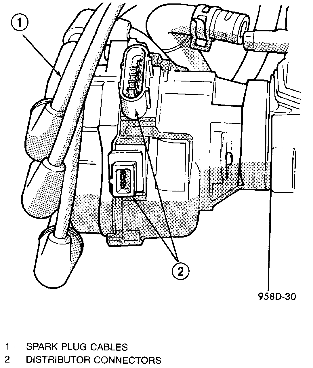

I have a bad crank sensor in my distributor I'm going to change the whole distributor. What is the very best way to take it out and replace it? I need instructions. thank you guys

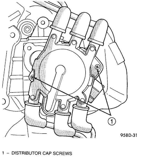

Here are the directions specific to your vehicle. Please note that it is extremely important to reinstall the distributor in the manner explained in the directions. The distributor rotor positioning when installed will determine ignition timing. If it is wrong, it won't run, run poorly, backfire, and so on.
The two attached pictures correlate with the directions. If you need help, let me know.

7. Remove spark plug cables from distributor cap.
Distributor Cap Screws
pic 1
8. Loosen distributor cap holddown screws and remove cap.
9. Mark the rotor position and remove rotor. The mark indicates where to position the rotor when reinstalling the distributor.
Distributor Electrical Connectors-Viewed From Rear Of Distributor
Pic 2
10. Remove 2 harness connectors from distributor.
