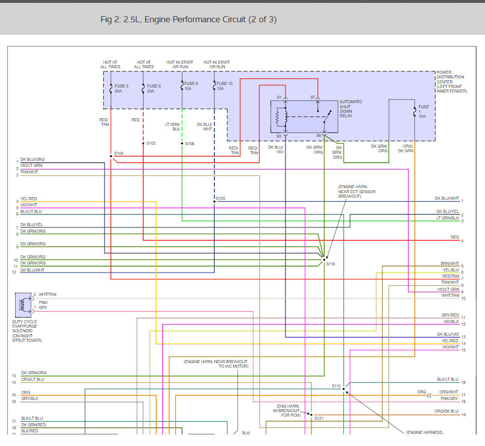

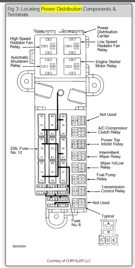

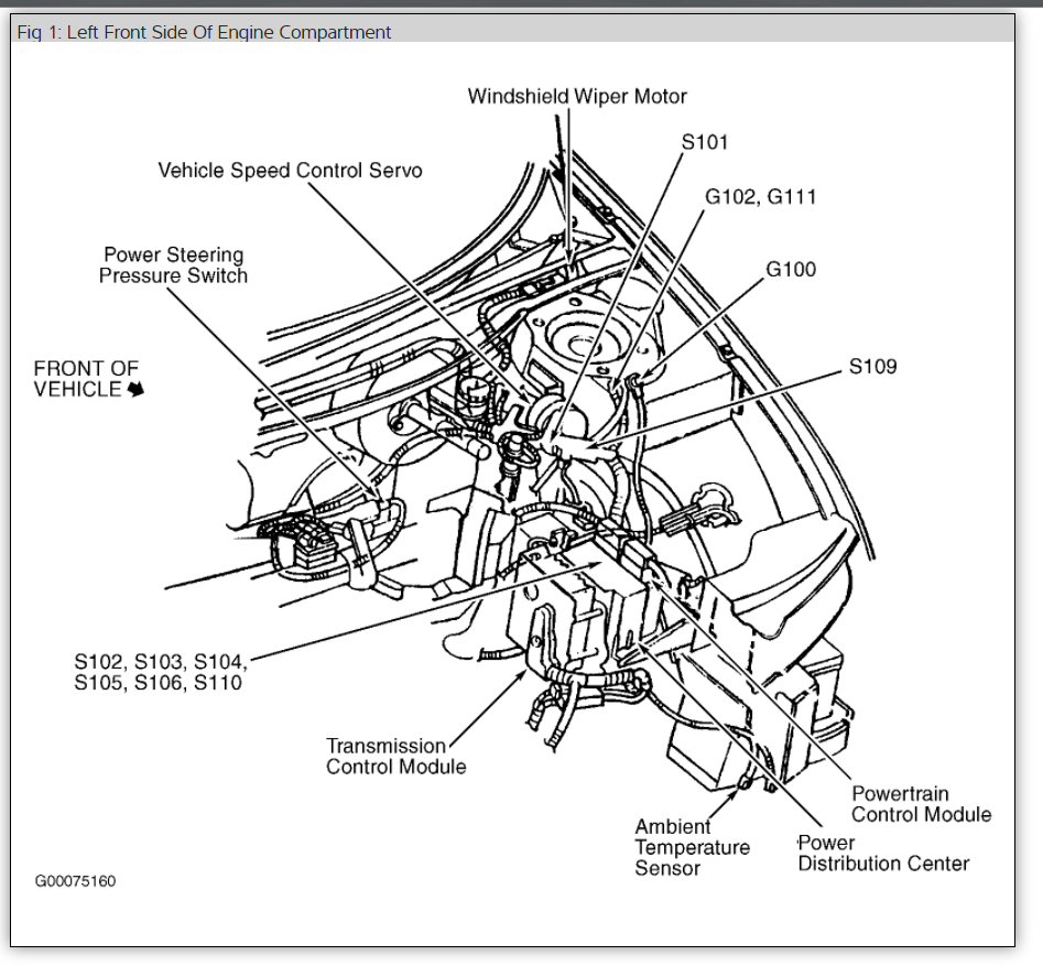

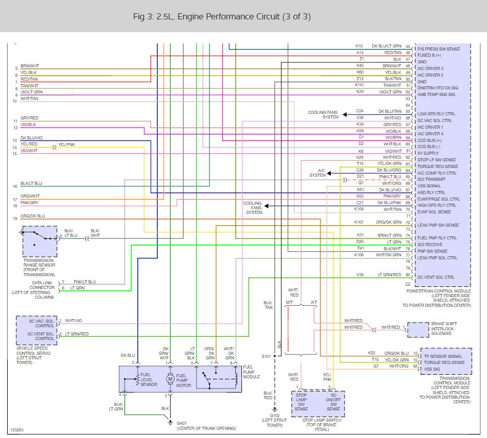

I have a 2000 Cirrus LXi with a 2.5L V-6. I have no spark whatsoever and there is no juice to the distributor when checked with a test-light. I have already checked for distributor rotation to rule out a broken timing belt. The belt is in-tact. Also, I have performed a diagnostic on any and all relays involved in the ignition process. I am baffled. My only other thought is that there is a possible fault with-in the ignition switch itself but it just doesn't seem likely. Does anyone have a clue as to what is going on here?
Oct 10, 2008 at 12:00 AM
  • 54,841 POSTS
There is an ASD (auto shut down) relay that goes bad in these cars, Here is a guide and some engine wiring diagrams to help you get the problem fixed.
Please let us know what happens so it will help others.
