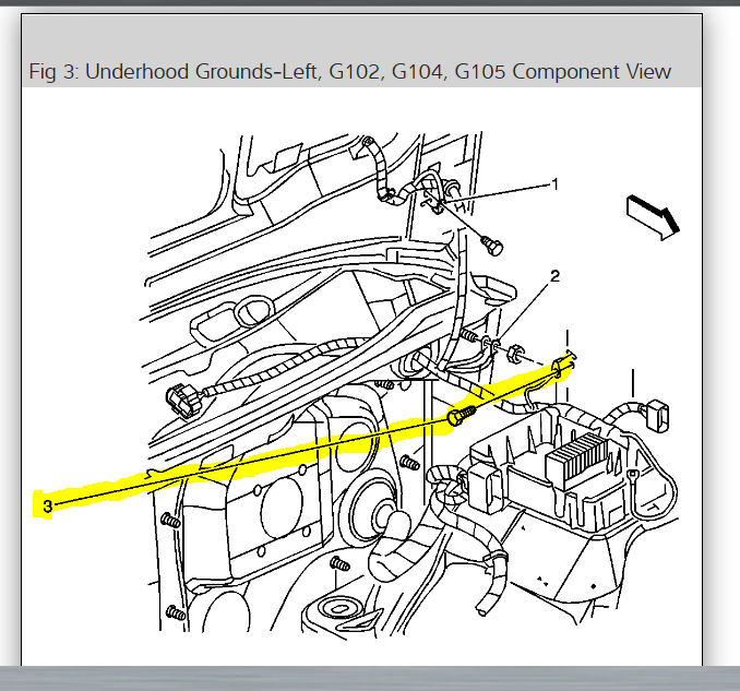

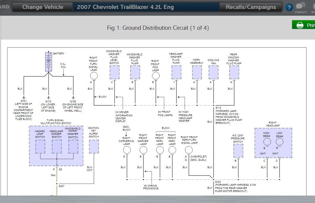

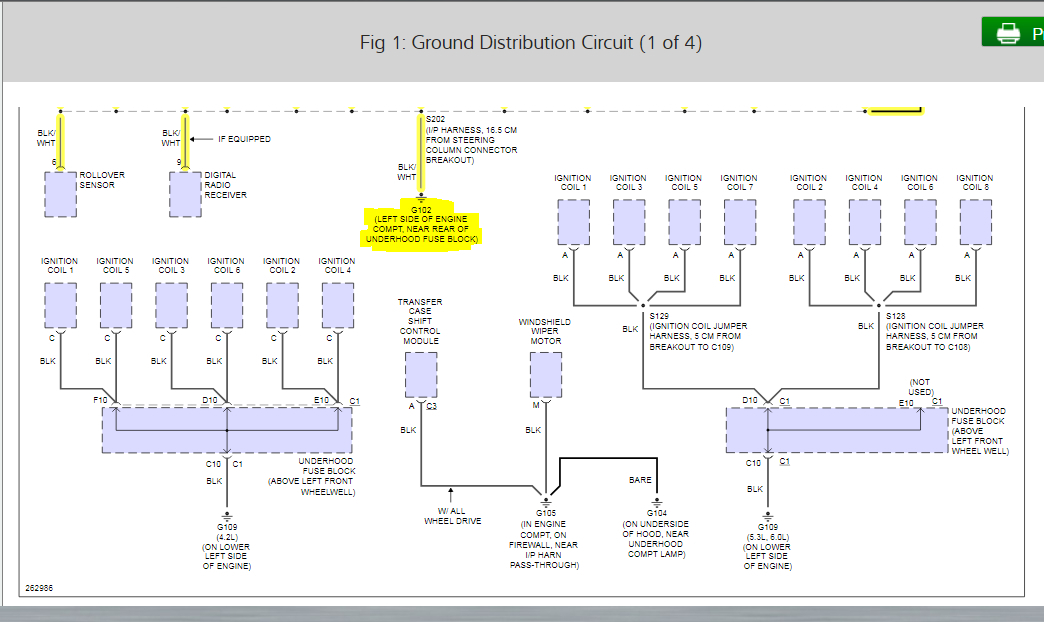

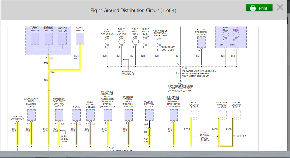

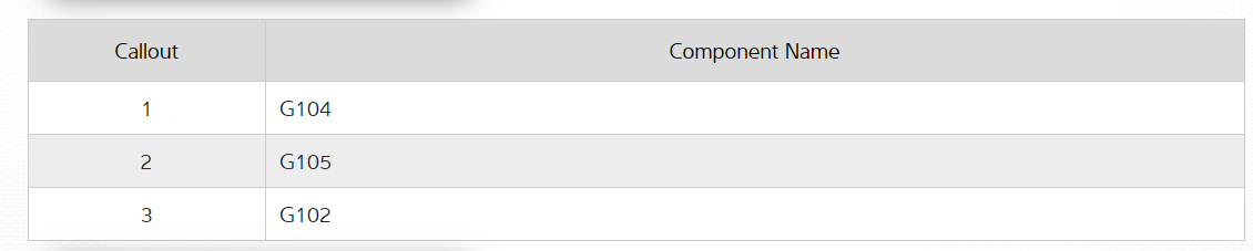

This sounds like it could be a problem with ground #102 in your vehicle's engine compartment, on the left side near the rear of the Under-hood Fuse Block. This ground is the ground for all the system circuits that you described in your question. Inspect this ground and make sure it is clean, corrosion free, tight, and making good metal to metal contact. I have included in the diagrams down below a Ground Distribution Wiring Diagram for ground #102 as well as a diagram of where to find ground #102. Please get back to us with what you are able to find out.

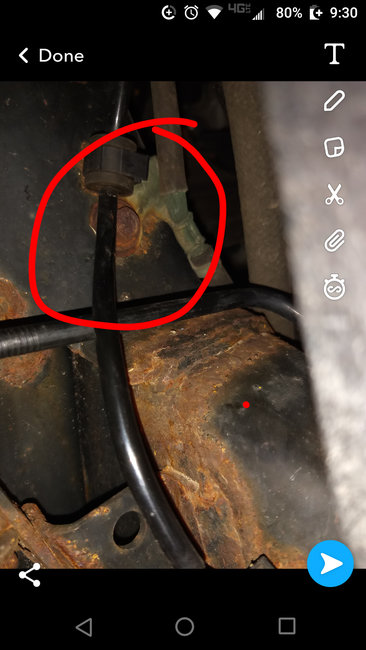

Cleaned that ground, it was pretty cruddy. Connected everything together and drove it, still acting up. Did a little more digging, went looking for a ground to the starter from the drivers side wheel well, and saw a bolt that was half out by the ABS sensor plastic body connector. I believe it was possibly ground 302? Either way, I tightened that down, drove it for ten minutes, no lights or loss of power! Went back home, unscrewed it about a quarter way to try to mimic the light and power issues, nothing really happened but I went below and wiggled that ground wire and it was arcing! So I re-tightened it and drove it around again, and to work, and no lights again! I will post again if the problem comes back, but I am praying it doesn't! Thank you so much for your quick response!
