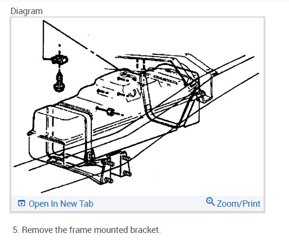

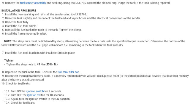

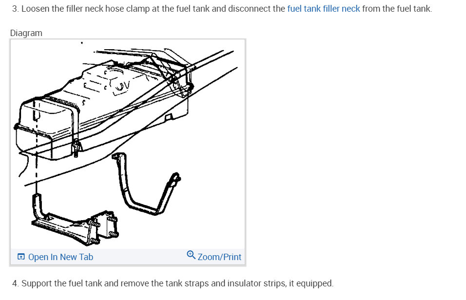

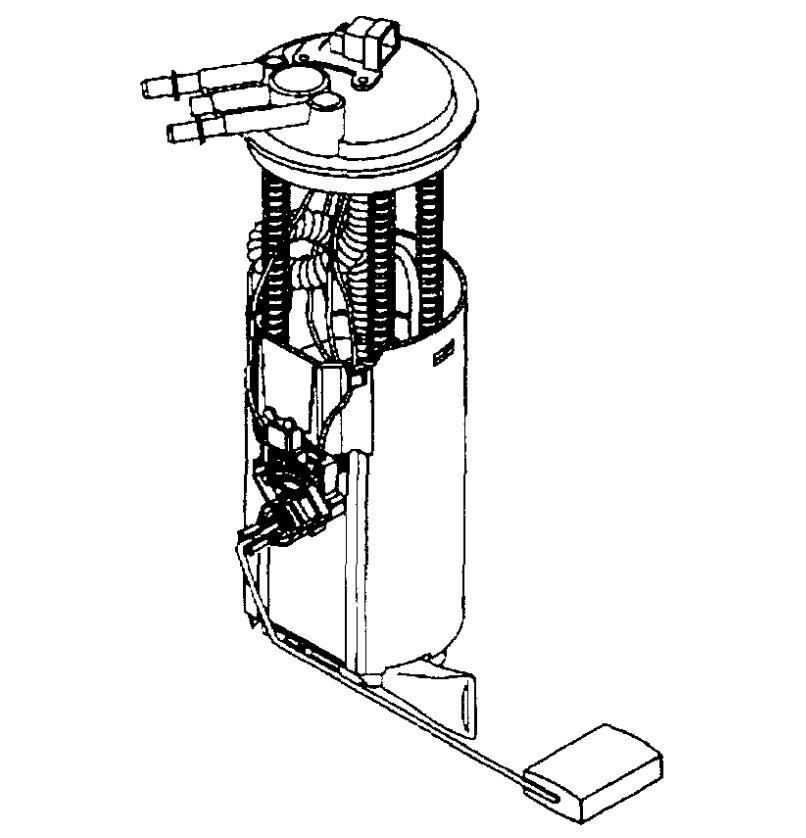

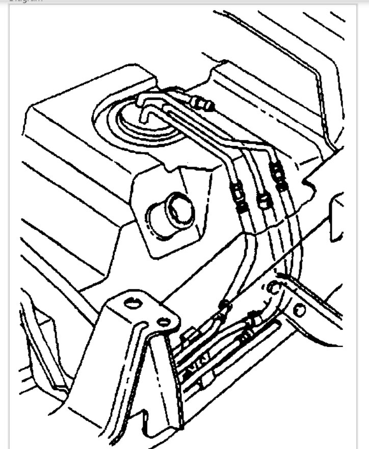

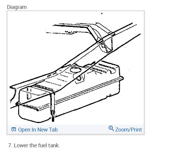

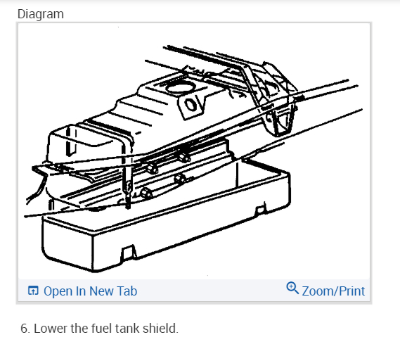

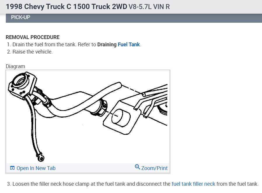

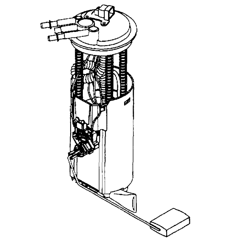

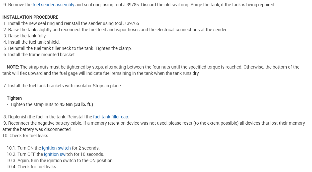

When you run out of gas, it can take the fuel pump out, here is how to check the fuel pressure to confirm, plus if you go over this video it will show you how to "bump" the bottom of the tank which can sometime bring the pump back to life for a last run.
https://youtu.be/lXLJbuAZ4CE?si=a-O7ke60bzXE_YCG
and
Here is how to change the fuel pump out in case you need it. Check out the images (below). Please let us know what happens.
