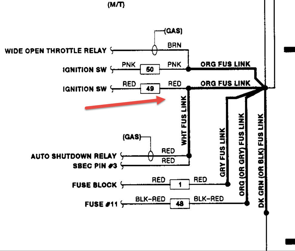

No power to green/orange wire with test light cannot read codes because will not connect to scanner. I have tried four different scanners. all fuses are good.

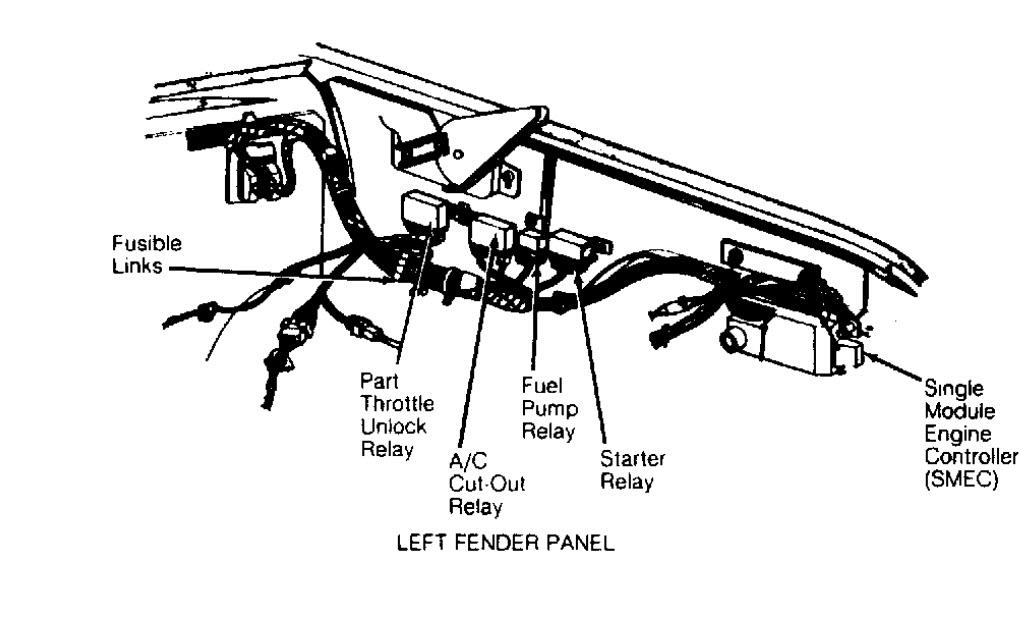

HMAC300
  • 48,601 POSTS
check all fusible links in pic they go off of starter relay check fuel pump relay for power.
