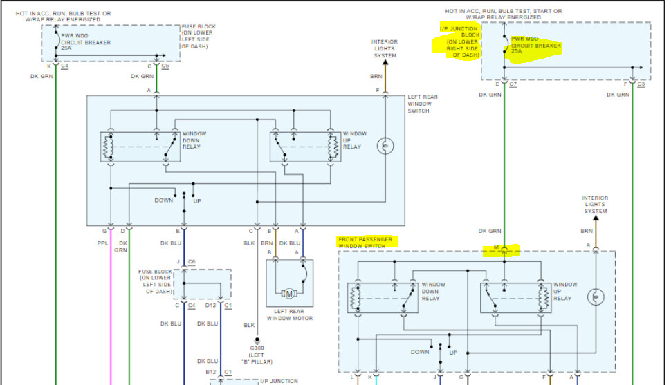

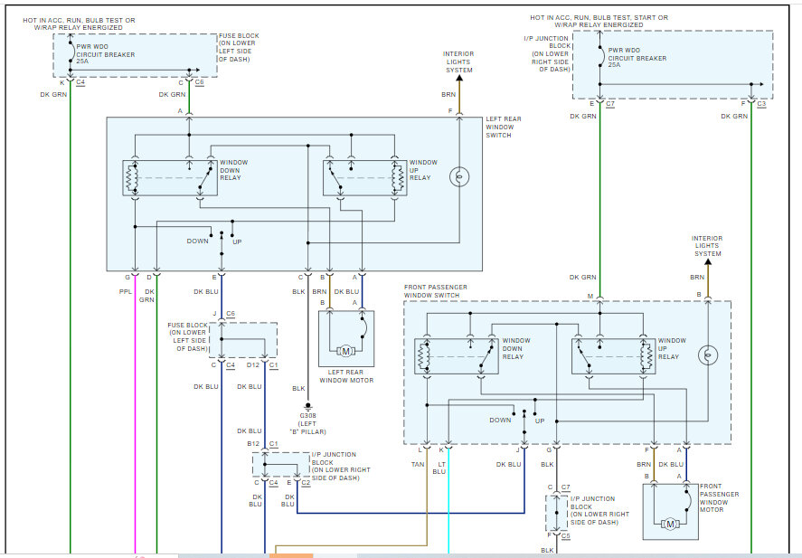

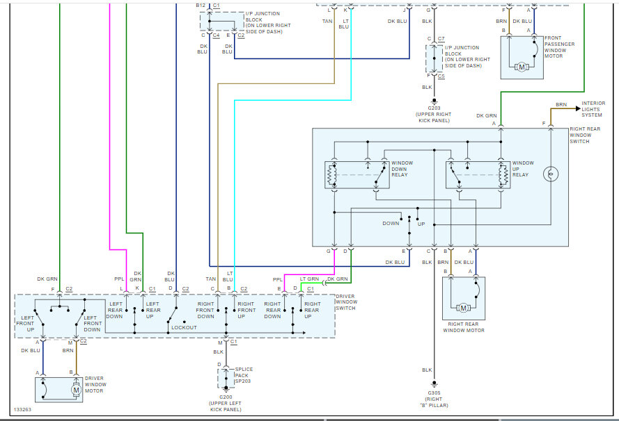

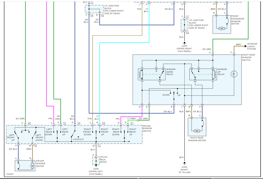

Make sure none of the ground was missed under the dash. As far as the wiring schematic, I attached it below for you.
Note that the schematic was a page long. However, I cut it in half to make it readable for you. I did overlap the two so you can follow from one to the next.
Take a look through it and let me know if it helps.

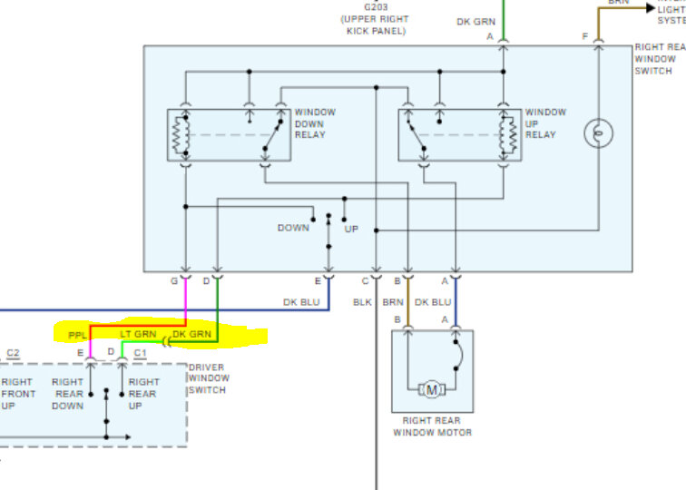

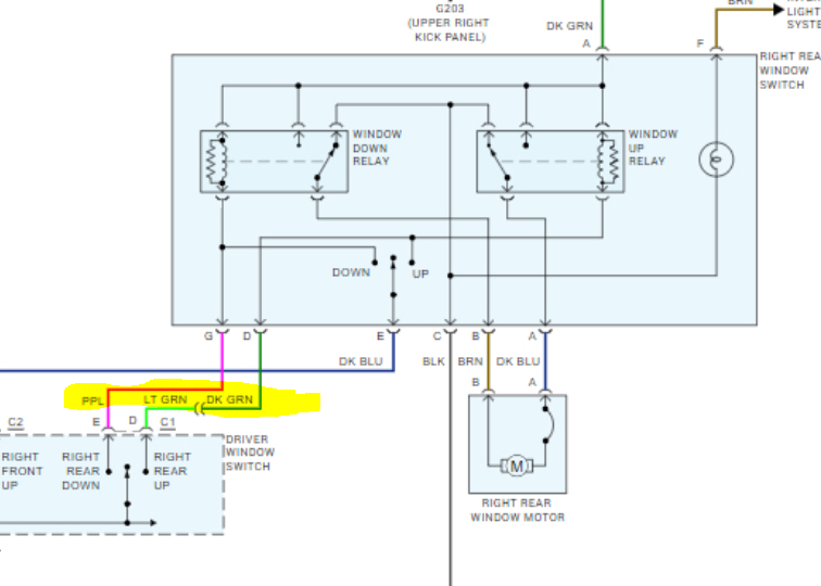

Power to the right rear window from the master switch is purple and the other will be light green and dark green. See pic below.
See pic.

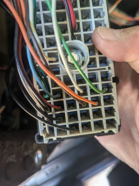

Hi Joe,

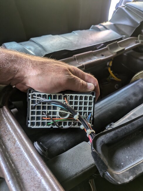

I have continuing of the tan and light blue wire from the master switch on the drivers door to the front passenger door. But I don't have power to green wire in the passenger side switch. I check the green wire for continuing and it goes into the fuse box on the right side of the dash. I check that fuse box for power and there was power to some pins but not the one for the green wire. How do I follow this up?
I have attached a photo show where it goes into the fuse box.

  • 110,244 POSTS

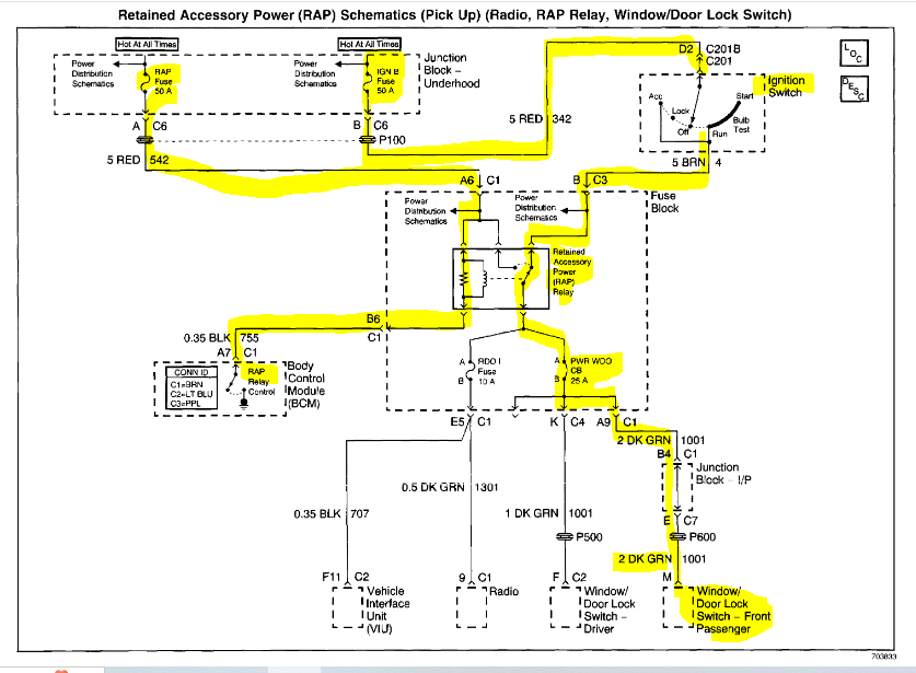

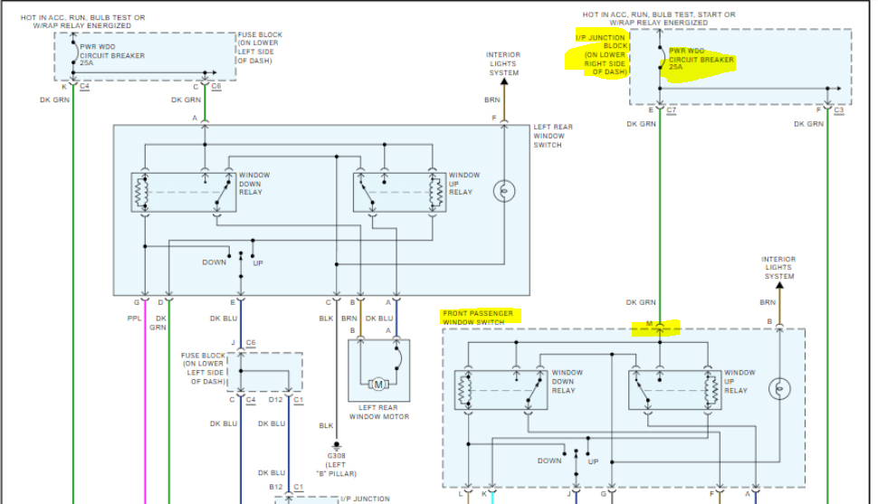

The green wire should go to a circuit breaker on the lower right side of the dash (See pic 1 below). When you checked the green wire for power, was the key in the run position? If you did, the next question is does the radio work?
I ask because for the circuit breaker to get power the retained accessory power (RAP) relay needs to be actuated. Once that is actuated, power flows to the window circuit breaker. Also, power from the RAP goes to the radio. So, if the radio works, I know the RAP is working. LOL Wiring can be a nightmare. I'm trying.
Next, if the radio works, we need to suspect the circuit breaker may be faulty. If the radio doesn't work, we will need to check the RAP relay, fuses, and so on.
Pic 2 below is a factory GM schematic. They are a bit more difficult to follow. However, I highlighted power supplies and how the power leads to the window switch. I hope it helps.

I suspected that the circuit breaker may be faulty so I bought a new one and installed it. I had the key turned on when I was inspecting the power to the wires. The radio has been working throughout this problem.
So based upon what you said that means the RAP is working. But I don't have power to the green wire. So looking at the wiring diagram, something is wrong downstream of the RAP?

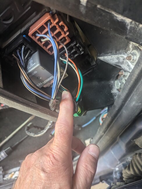

In the photo I have attached with me pointing to the wire and plug, there is a relay above the plug. Do you have any idea what it is a relay for? There isn't any information on the cover like there is on the other fuse boxes.
Ron
Jul 30, 2024 at 11:56 AM
  • 110,244 POSTS
I agree, the issue is after the RAP relay. I believe the relay you are pointing to is the fan relay and not related to the windows.

I pulled up the power distribution schematics. From what I'm seeing, it appears the connection between the RAP 2 relay and the CB must be integral to the fuse panel. There is no wire color provided.
Take a look at the pics below.

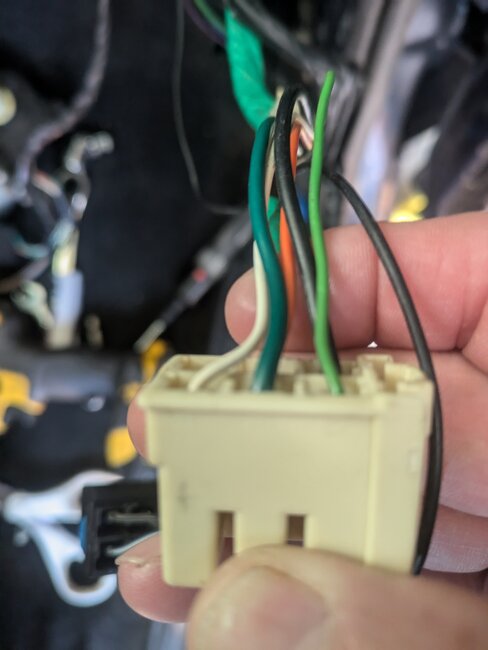

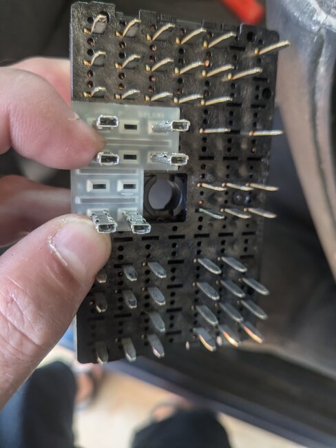

RLPETERSON78
  • 147 POSTS
Hi Joe,

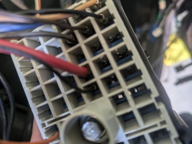

I got the back of the fuse box off. I'm a bit surprised that the relay only has a big red wire and a black thin wire. The CB has no wires behind it. I'm also surprised that it look like a panel connecting the relay and the CB. So it look like when the relay engages it send a signal to the CB to send power to the window. Do you think that is correct?
Ron
Aug 2, 2024 at 3:40 AM
RLPETERSON78
  • 147 POSTS
Hi Joe,

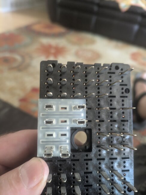

I the first photo this is the plug that goes below the CB in the fuse box. The second photo is the wires behind the plug. There isn't a wire in the position of the green wire but before I took the fuse box apart had continuing from that plug into that post without a wire. The third photo shows which two posts have continuing where my fingers are. In the last photo shows the thick red wire and the black wire going into the relay. When power is on both these wires have power.
So, the only posts in the relay that get power from two right posts. When the bottom left post on the relay gets power it sends it to the left side of the CB. The plug below the CB has continuing in the post with the dark green wire in the plug, but there isn't a wire in that position behind it. How do I go about troubleshooting this? There doesn't seem to be a broken wire. But there seems to be a problem with the signal. Please advise.
Ron
Aug 3, 2024 at 3:58 AM
RLPETERSON78
  • 147 POSTS
Hi Joe,
I have confirmed that the red wire has 12 volt power when it is hooked up to battery. When the key is turned on, the black wire gets power, and three of the Posts on the relay get power. If I bridge the post without power to the bottom left post with power the Relay clicks. When I tried to use the window switch on the door nothing happened. But using the master switch on the driver side the relay clicks but doesn't provide power to the post on the relay. What do you think is causing this? What should I track down?
Ron
Aug 13, 2024 at 11:32 AM
