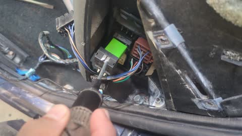

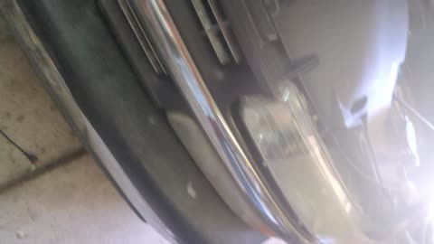

It is the turn signal light on the passenger side. It was on when the battery was connected and key in the on position. I took the light out and it was covered in some white material, possible dried soap, when I was looking for a leak in the AC evaporator. I still had some soapy water in a bottle so I cleaned the light and connector to see the color of the wire in the back of it so I could check continuity with the wire in the cab. When I tested it again.....it was off! Do you think that a short was happening due to the dried soap? So now that is fixed so I can continue to see why I can't roll the passenger side windows up. I had Covid last week, so I didn't work on my truck.

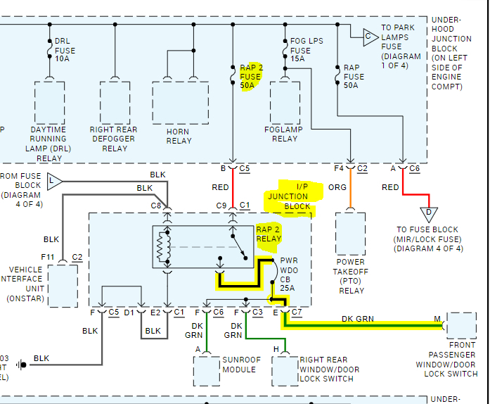

Oh, and I confirmed that the sound is coming out of the RAP 2 relay. It was buzzing when the switch was flipped.

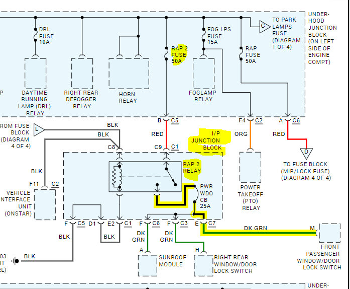

I thought I could refresh your memory of what is going on with my truck. In the video below I show that when the motor is disengaged, I can flip the switch, and I get power to both the post on the connector that goes into the motor. Then I connect that connector to a new window motor, and I get the same problem with the sound coming from the RAP2 relay and the flashing lights and the motor not responding.
I cannot control the passenger side window from the master switch on the driver side. I think it is controlled by a green, tan, and light blue wire. Is that correct?
And I can roll up and down the passenger back window with the master switch and its door switch. Doesn't that switch depends on the RAP2 relay?

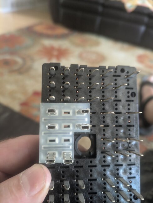

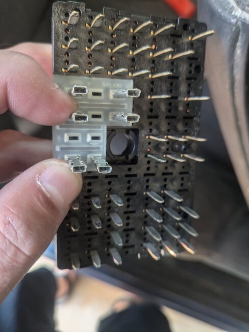

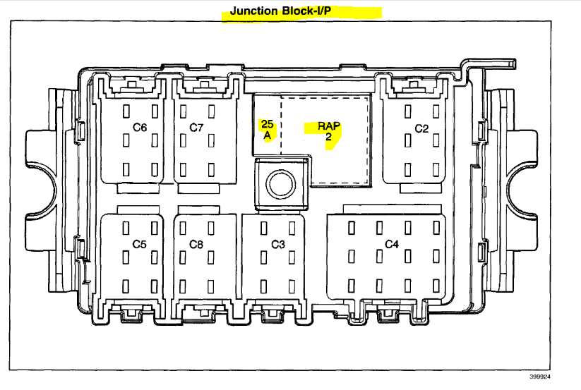

I now have power to roll up and down the two back windows and the drivers side window from the master switch and by their door windows switch. I have power at the passenger side front window from the switch to the blue and tan wires that go into the motor on the passenger side front window. If I plug it into the motor and flip the switch, the RAP2 relay buzzes. If I go to the master switch and flip that switch the RAP2 relay also buzzes (see video). I have replaced the motor and regulator in that passenger side front window.
What would make the relay buzz?
And why can I control all the other windows but it?
Sep 18, 2024 at 7:27 AM
  • 110,248 POSTS
Was any of the wiring changed? It sounds like power is somehow being backfed to the relay. Often times that is due to a weak ground causing the power to find a different route to a different ground.
Sep 18, 2024 at 10:47 AM

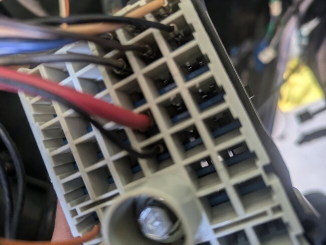

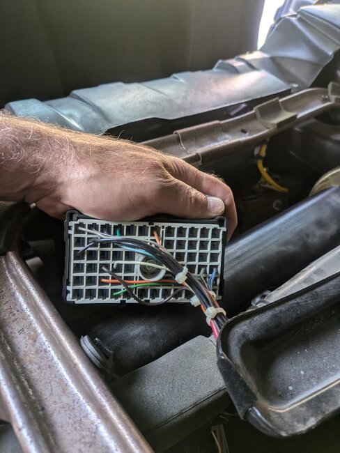

I attached two pictures below related to the ground location. It is G203. Pic 1 is the schematic that indicates it is on the right side high behind the kick panel. Pic 2 says it's on the opposite side. Ugh!!!
The pics both came from the same manual. Check to see if you can locate it on one or the other side. Also, I noticed there is a splice pack for the ground. There is a good chance that is where the issue is located.

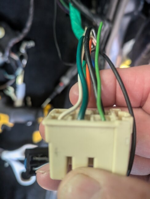

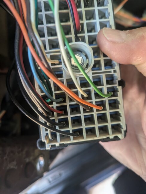

Can you please answer my question. You said that the splice pack would probably be the issue. I will need to take the dash off again to get to it. Is by bending and pulling the wires at the splice pack responsible for me loosing power at the switch?
Ron
Sep 23, 2024 at 6:51 AM
RLPETERSON78
  • 147 POSTS
Hi Joe,
I took my dash off again to get to the splice pack. I tested for continuity from the switch on the front passenger window that isn't working and the wires in the splice pack. Every wire in the splice pack had continuity with the switch. What does that indicate? That the switch has a ground?
